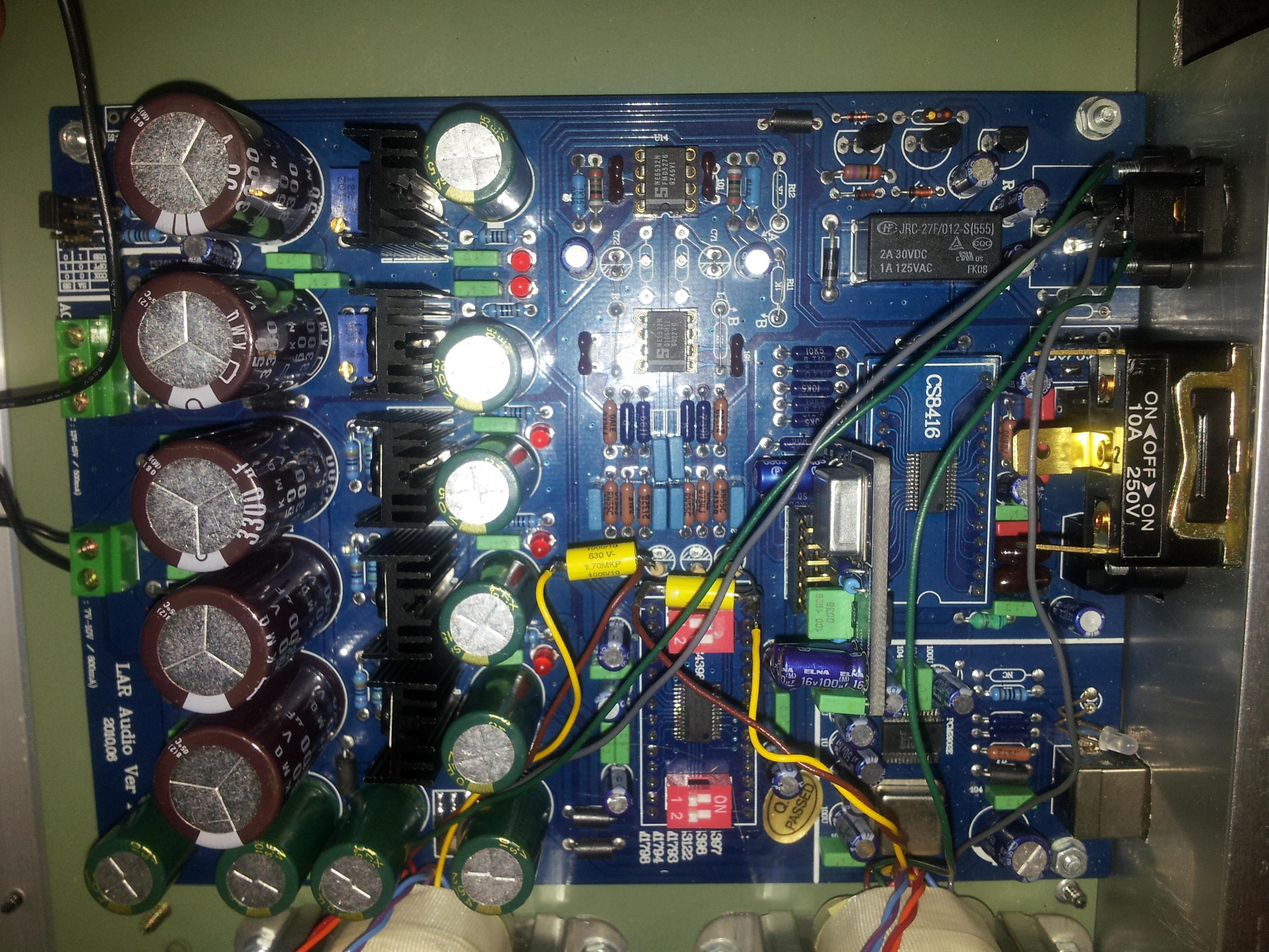

If you just want to switch between coax and optical, it's so simple you don't need a pic. Only one jumper is involved so ignore the other, just leave it where it is. Remove the jumper that switches between coax and optical and wire a SPDT switch to those three pins. Wire the center pin on the board to the center pin on the switch, and wire the other two either way is most convenient. The center pin goes to the 8416 chip and the switch will now select the input by either connecting the center pin to ground or V+.
If you wish to switch between 3 or 4 inputs then you will need a two pole rotary switch and duplicate the wiring of each pole to the wiring of the SPDT switch. I haven't worked out the wiring for that but it should not be that difficult, I just have no need for it at this time.
Actually, you could use two SPDT switches for 3 or 4 inputs.

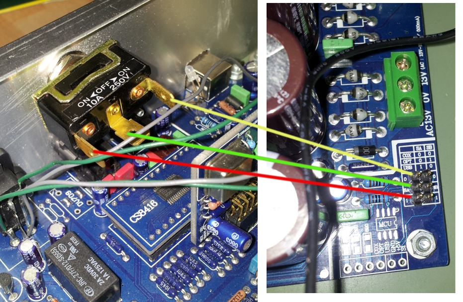

Hi gents. Im in a similar situation to the op albeit less confident.
Attached shows the switch i intended to use. Can somebody talk me through what to solder where please as Im worried about screwing it up.
If you're unsure what level to pitch your advice at, pretend you're talking to a baby.

Hiya. Have I interpreted this wrong? I need OPT and USB inputs more than OPT and COX really, so my diagram below won't be any good?
I'm wiring from the jumper pins?
Also, the switch I have isn't sufficient to switch between all three input types... or is it?
Many thanks
Nathan

Seems the photo above shows how to wire the switch up for Coax and USB rather than Optical and USB.

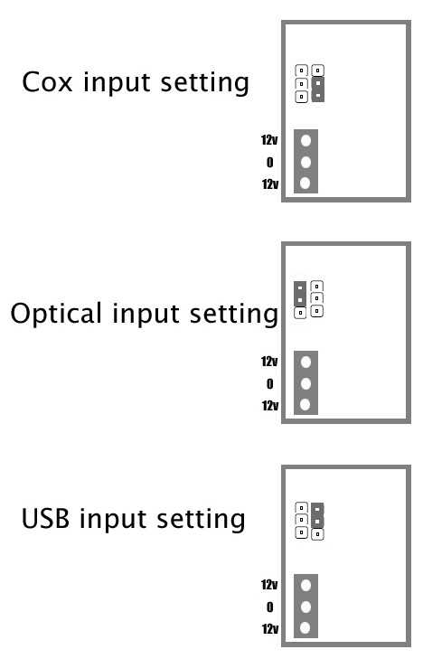

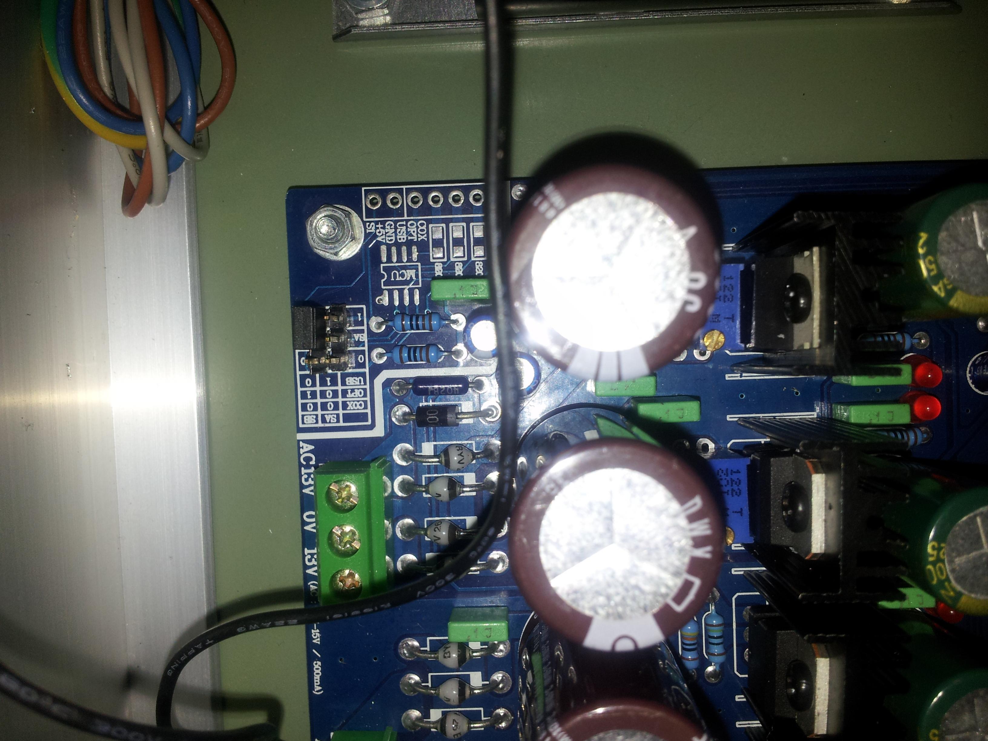

Looking at the jumper matrix (attached) however, how would I wire it up to switch between Optical and USB? I can't see for looking. There seems to be no common pin between optical and USB that I can wire to the middle contact on the SPDT.
Best bet is to get another switch with enough pins? Rotary? And switch between them all.
