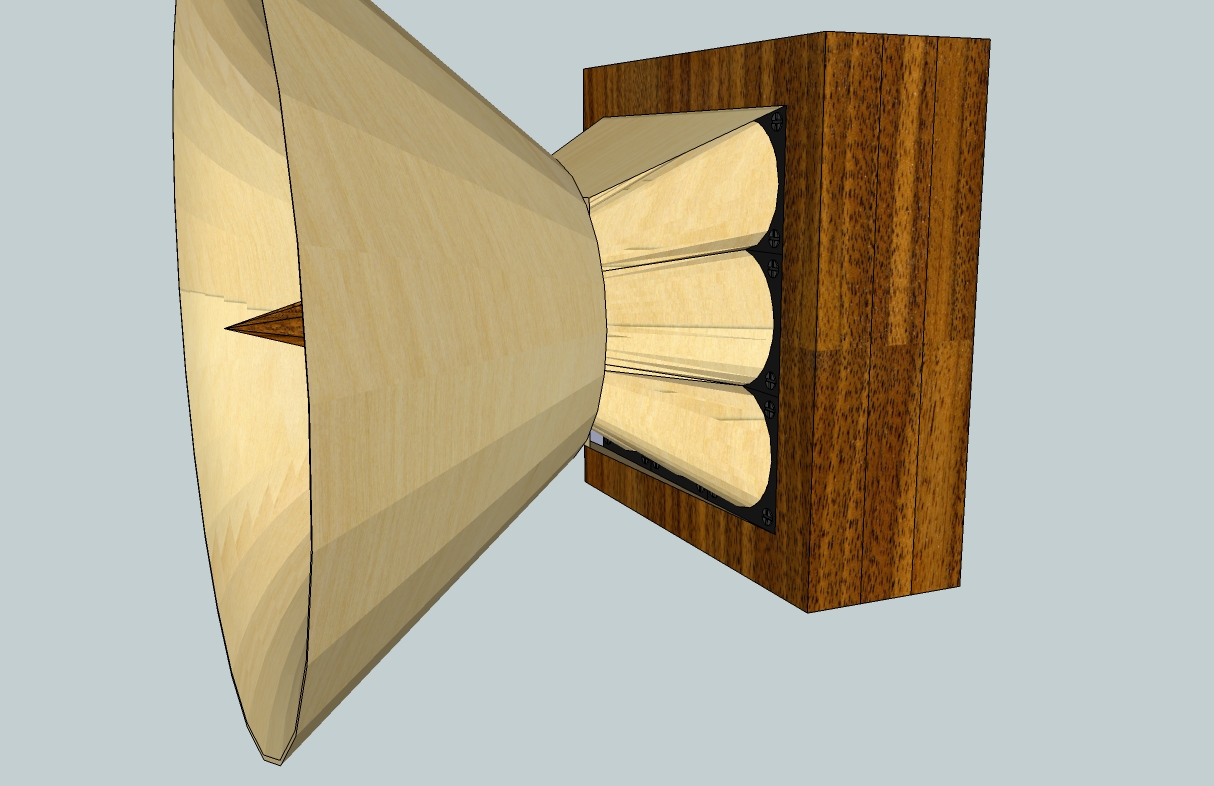

I'm sorry I don't know what that means, your English isn't the best. The drivers ar directed straight down the nose of the phase plug, there is no chamber for thm to bounce around in, just a narow straight tunnel( a seperate one for each driver) for 5cm flaring to a front horn for 10cm. As far as I now the only thing that negaively affects high frequencies is directionality and reflections, the design doesn't have these problems as far as I know. I'm not saying you're wrong, I just don't see why you're right. I want to build this design to test it but my cabinet guy is very busy for the next few months, the design is very labor intensive(involving the use of a lathe) and rather expensive(large chunks of hardwood) and as I mentioned previously I have no funds. If it would present a problem I could definitely shorten the chamber the reason I have the number in there that I do is because that is what modeled best on hornresp but in actuality I guess there doesn't have to be a chamber at all that's just kinda how it came out in the design for various somewhat arbitrary reasons, but it could be shartened or perhaps even eliminated I guess. Back to the drawing board I guess. I think I spend as much time modeling that front horn (in Sketchup) as I did the whole rest of the design.

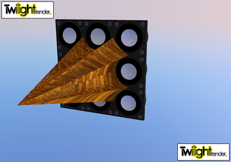

Hi, I am a bit worried about interference between the drivers. I suspect you will be losing some high frequency at around 10kHz+, I hope I am wrong though.
i don´t think so,
simus are only for 3 oktaven correct, from the flare rate as the base

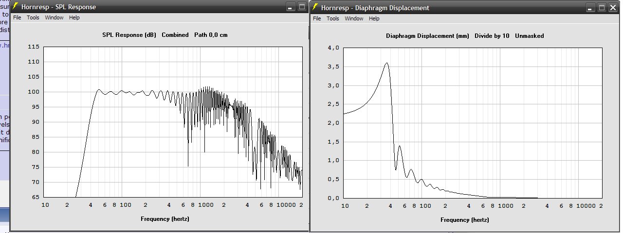

Well sence this is a compound horn and thereby simulating two horns it is as I have always suspected acurate to 6 octives ergo to about 2K. But the highs travel straight down the nose of the phase plug to the listeners ears. Nothing is blocking them they are not turning any curves they are in essence acting as direct radiators and should be unaffected by the horn.

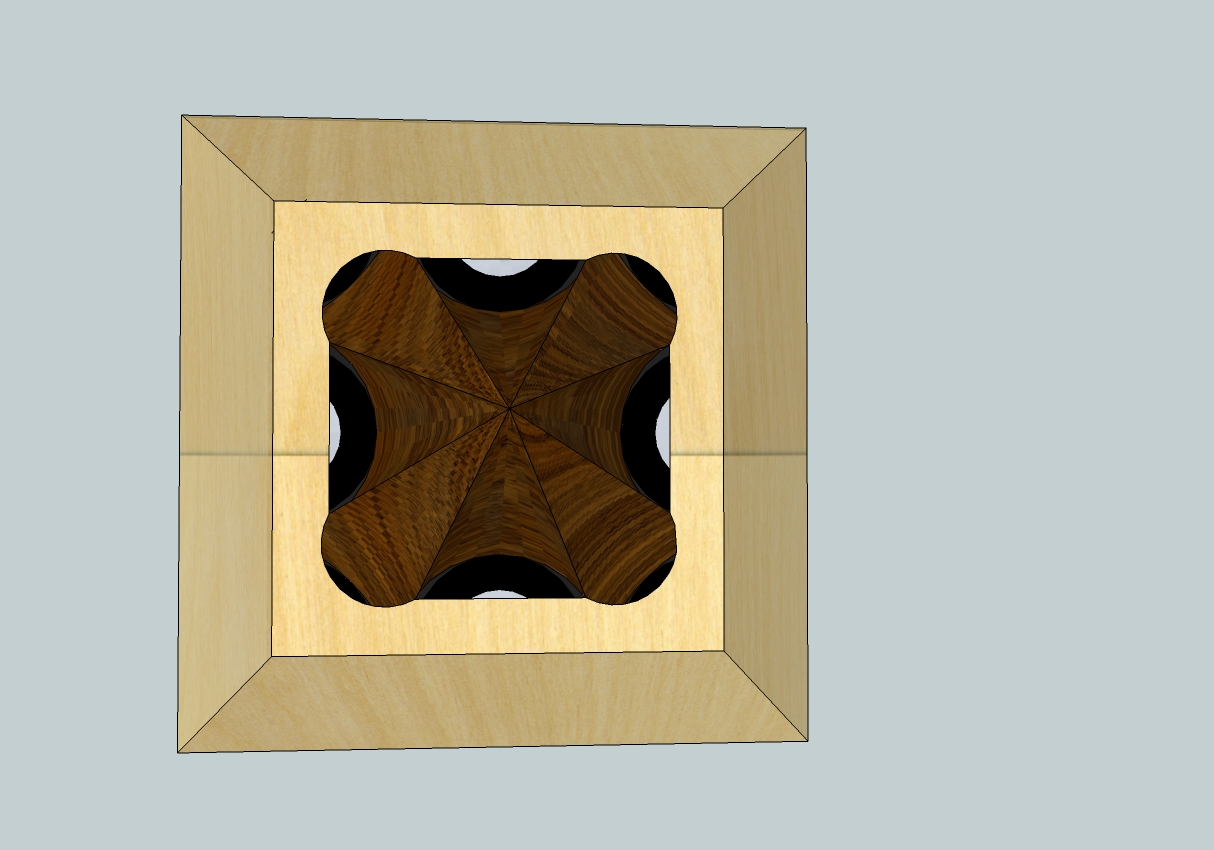

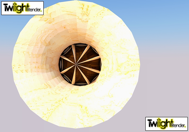

Actually because of the phase plug there would be no destructive interference. All 8 of the drivers are essensially equidistant from the tip of the phase plug(4 of the drivers ar 11/32" or .8mm farther from the tip) and the "chamber" which is really 8 seperate wave guides and not a chamber at all, directs the sound directly to the center thereby ensuring all drivers are working in unison throughout the the spectrum.Hi, I am a bit worried about interference between the drivers. I suspect you will be losing some high frequency at around 10kHz+, I hope I am wrong though.

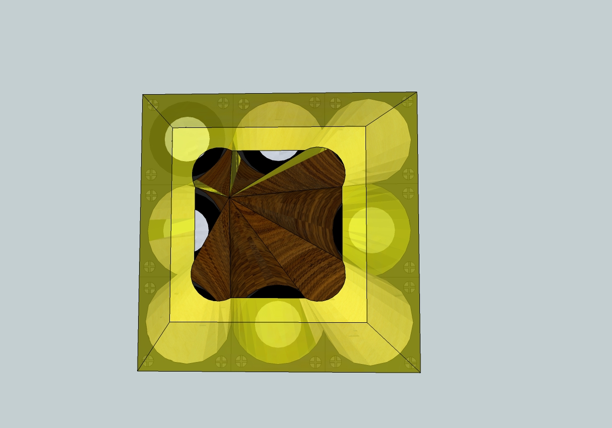

Alright in this picture I have completely deleted the front horn so you can see how all eight drivers point directly down the phase plug. they are almost exactly eqidistant from the tip and should combine perfectly smothly in the high frequencies.There is no chamber for the sound to bounce around in or any cross paths for them to cancel out in. I have considered and dealt with all of these concerns and all anyone can do is shake their head and say "because I didn't think of it and I don't understand it, it won't work!" I am not saying I know everything and there isn't anything I haven't considred I'm just saying if there is, nobody has mentioned it.
Brsanko,
Nearly equidistant is not equidistant, many line array systems are suffering from the same problem although theoretically they should work perfectly. The combing effect is still there, maybe some are alright on axis, but off axis would be ragged and requires DSP and equalization.

at 3 or 4mm perhaps but I'm not pushing them that hard. if you look at my sims the speakers reach 120db at 2mm down to 50hz, so at normal listening levels you will never even get close to that. At 100db the excursion peaks at .35mm at 35 hz, well below the intended band width. at 45hz and above it doesn't exceed .15mm at this volume. I don't think it would ever be a problem if used properly and it could play ear splitting volumes without significant distortion if crossed over above 50hz, it's intended extention.

Firstly, it's good to see that you have come up with a "full range" design for the 1" TB driver, despite the naysayers. The front horn portion with unique phase plug is quite creative. How much loss of highs is hard to predict in this front horn, and in the end the proof will be in the listening- as it is with all speaker designs regardless of how well it sims.
Could you provide more details (size and measurements) on the smaller bookshelf speaker that reaches down to 80Hz? Or you could start another thread as there might be others who will be interested in it. Thanks.
I think some differentiating is in order here!
I think most here would agree that there is a marked difference between a model/3d render of a design, and the real world iteration of that design. With that said, it seems you have the former part of that differentiation brsanko, and we thank you for sharing it. You obviously have skill with hornresp and sketchup, far more than I'd ever have the patience/time to acquire.
I do hope that you build some of the designs you've posted here......but there's one oversight......compression (if you intend for the drivers to see <200hz). It's not an oversight on your part, just a thing that modeling programs do not account for. The bi-product of that is some ugly, very ugly lower midrange/upper midbass. I truly hope I end up eating my words, but that driver(s) is going to be screaming for mercy below 200hz......to get to 120db that is. I've heard a handful of designs that were over-ambitious in the bass extension department, and although they worked......the bass as I recall was artificial sounding to my ears.

Well, I would guess that the fact that these are tiny drivers and require very little power to reach these levels is going to reduce the amount of compression greatly. As to the request to post the bookshelf design, as I mentioned earlier it was designed by my friend Doug and he does not like to share his designs on here and has expressly asked me not to, but if you look at my design using the 2" Tang Band driver that I have links to actual photos of as well as simulations and 3D models, it is very similar only slightly smaller. I have redesigned the front horn phase plug assembly to completly eliminate the front chamber and make all eight driver exactly equidistant from the tip of the plug. I hope this satisfies the critics but I know it won't so, whatever.
