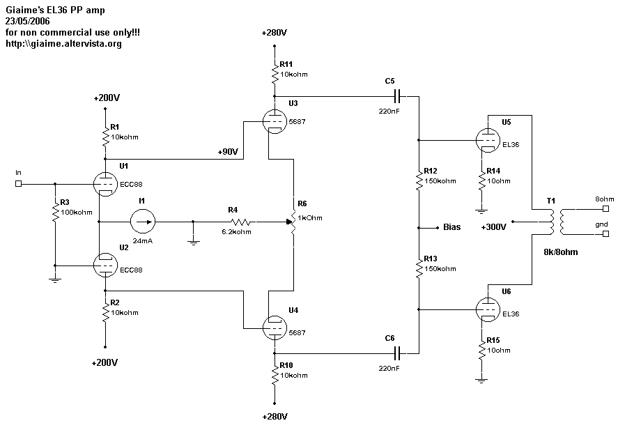

Aside from those trivial problems 😉, there's a little thing I thought.
If I take the signal from the two output tube plates, with 1M resistors connected toghether, at the junction of those resistors to a known value resistor to ground (assuming perfectly out of phase signals at the plates and matched resistors) there will be zero volt AC.
However, every imbalance in the push pull will be in the central node as an error signal, ready to be fed back to the first stage unusued negative input.
What do you think of this, has it a name?
Sometimes I have ideas but I don't know yet the theory behind, so...
is it useful? I'm searching for methods of local feedback, since I've got some gain to burn (but not so much that I can eliminate a stage).
Would be better to fed some feedback from the plates of the power tubes to the 5687 driver tubes?
This is because I would like to avoid looping the output transformer in the feedback network, I don't think I'll need it and I'm not technically prepared to deal with it and all the problem associated to a reactive element in a feedback network.
Attached last schematic:
Dear green cap guy,
A resistor from the plate of the output tube back to cathode of the previous tube will give NFB...
Oops!
That resistor should be placed inseries with a coupling cap Giame. It highly unlikely that the proper value of resistance wouldn't disturb the basic DC bias of the previous stage.
Obviously a cap is needed, even in the case that I mentioned of the 2 1M resistors.
Not too good I sense... but better than a transformer.
Giaime, you can't center tap the plates.
Draw out some waveforms... the signal you derive will be a 2nd harmonic of sorts... not good.
True... but you should still drink.
Consider my suggestion... one resistor & one coupling cap from from EACH output plate back to each 2nd stage cathode.

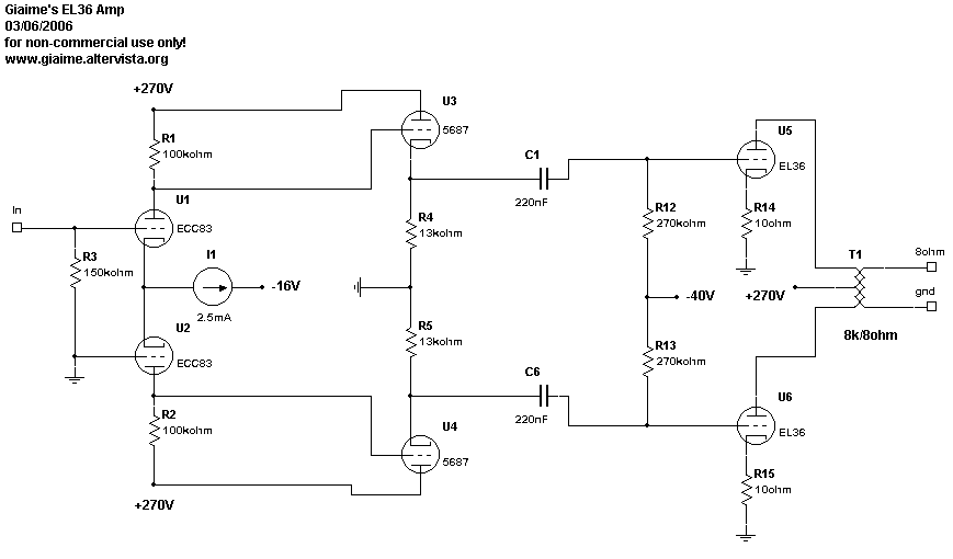

Now, I've got a problem.
I redesigned the driver stages of the EL36 amp, because I was unsatisfied of the results (still not enought drive to the hungry EL36).
I ended up with this, schematic attached.
However, both TubeCAD and Spice give MUCH MORE output voltage swing and gain than the measured performance on the prototype.
I should have something like 60-70Vrms max output (instead I measure 29Vrms), and 33dB gain (I measured about 28dB).
So what's going on, why do I have those vastly different results?
Keep in mind that voltages here are referred to the prototype I built, which has a recycled power transformer that puts out too low voltage. B+ on the real amp will be at least 300V.
Now I can barely drive EL36 grids that are sitting at -40V, but what about when I'll have them at -50V in the definitive amp? I cannot drive them!
