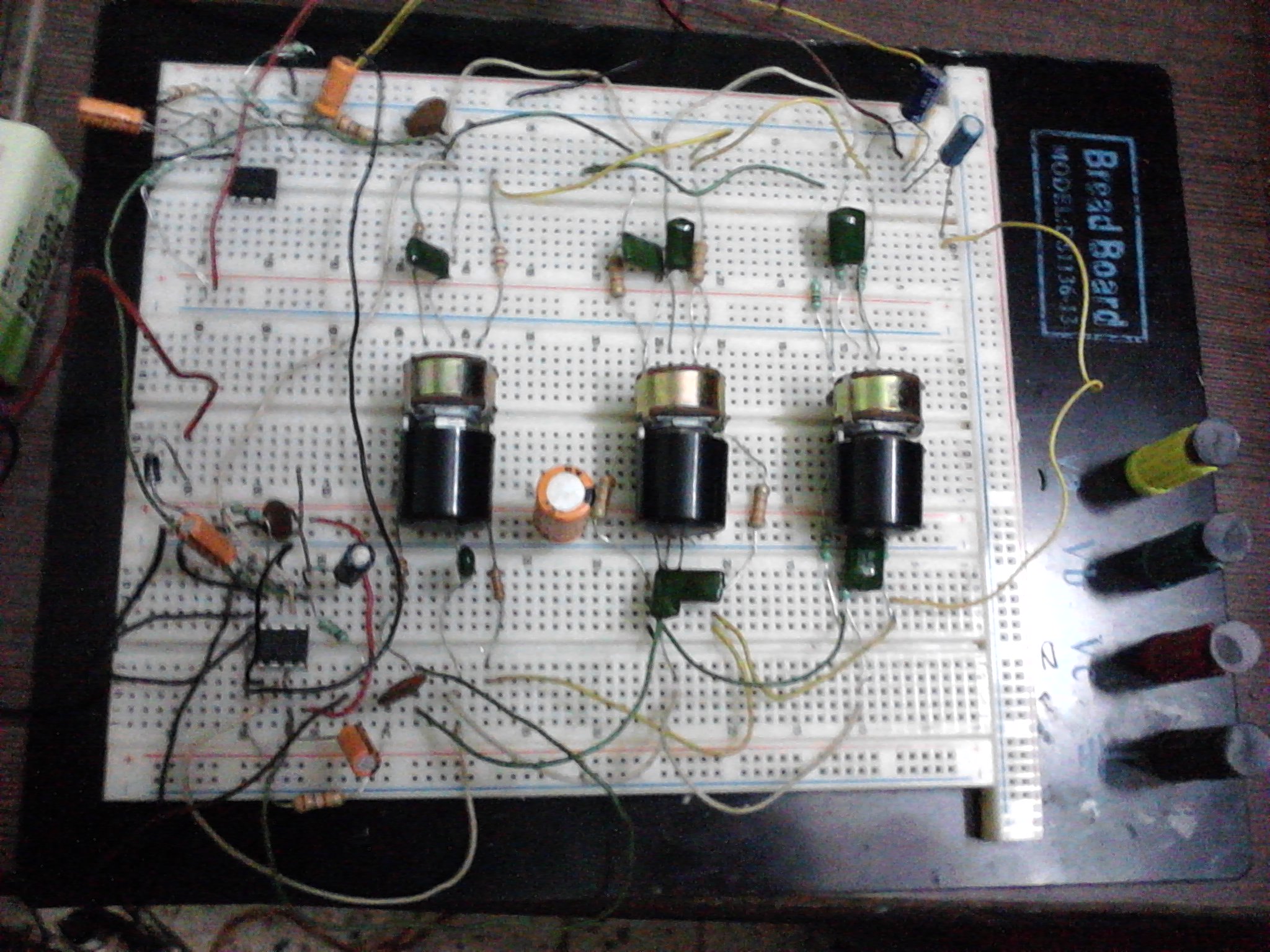

I started to build a 3 band Equalizer using NE5532 as per this website. 3 band EQ
First I tested the second part of the circuit on a breadboard and it worked as expected. ( attachment: graphic eq on bread board.jpg )

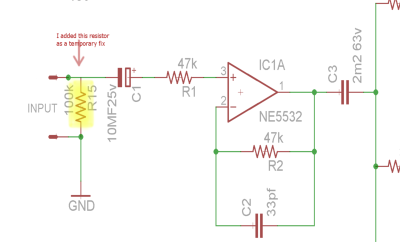

I added a 100k bypass Resistor infront of the 10uf/63v Electrolytic cap like this below in the input and the problem was solved! (Kindly see the attachment EQ FIX 1.png )

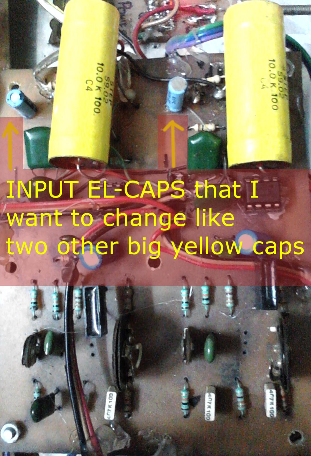

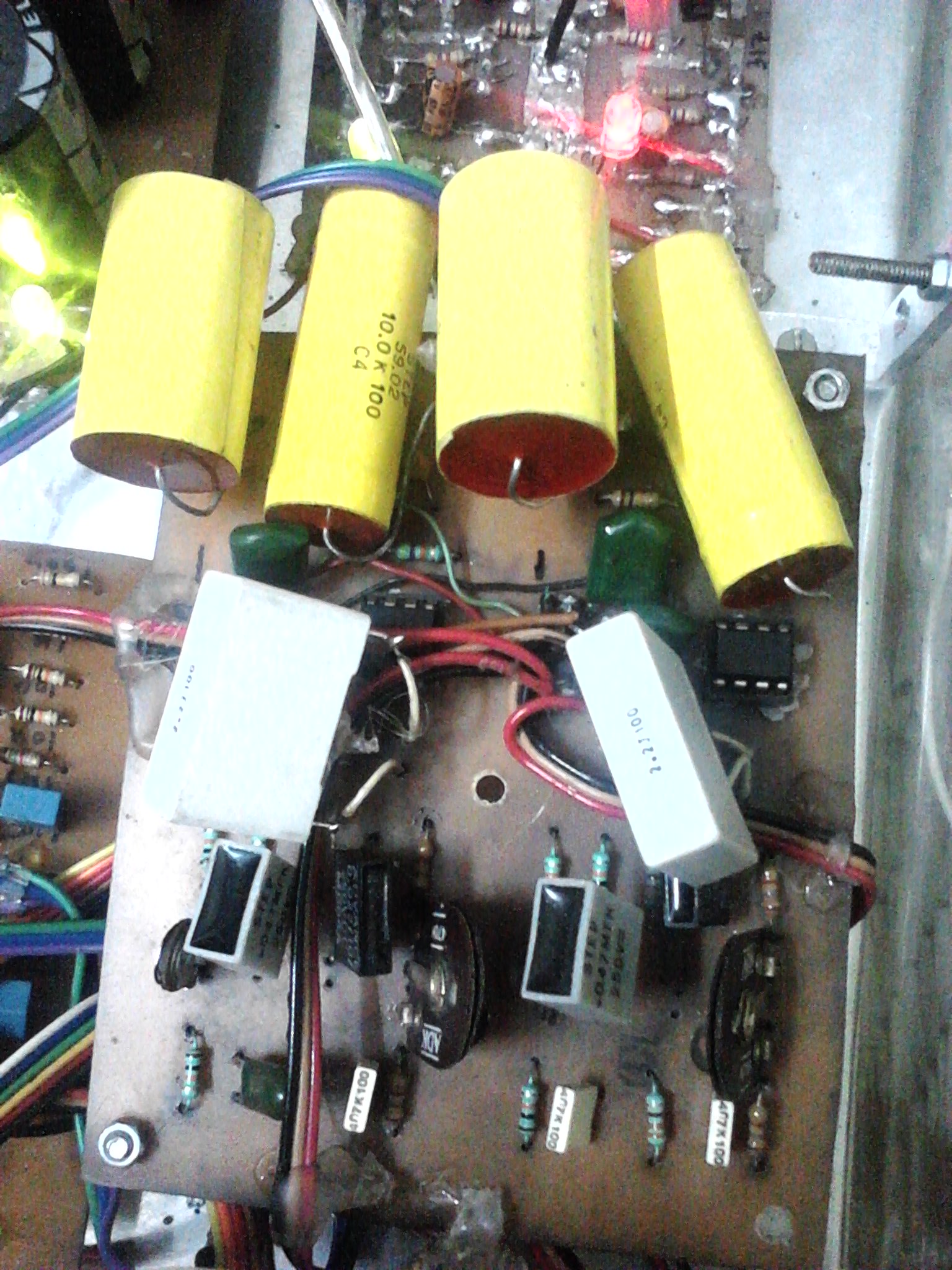

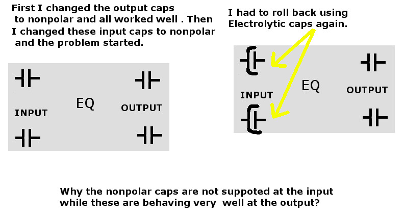

After some days I replaced the electrolytic input caps with a bigger nonpolar 10UF/100v caps. I found the sound was improved . I was happy. But after some 5 minutes the previous problem reappeared. i.e gain reduced and sparking noise.
I monitored the voltage ... +-15v okay, no over heating of the ICs, No pcb foil line is damaged. I tried my best to solve that but alas...
As a last resort I had to use the electrolytic caps again with the 100k biasing resistor.
Could please help me fix this problem so that I can use the bigger caps instead of the el-caps?

Thank you freax.
I am lost as the el-caps are working perfectly with the 100k resistor but the bigger nonpolar ones ( which are dramatically improving the performance) fail.
I checked the ground continuity too. No problem there .

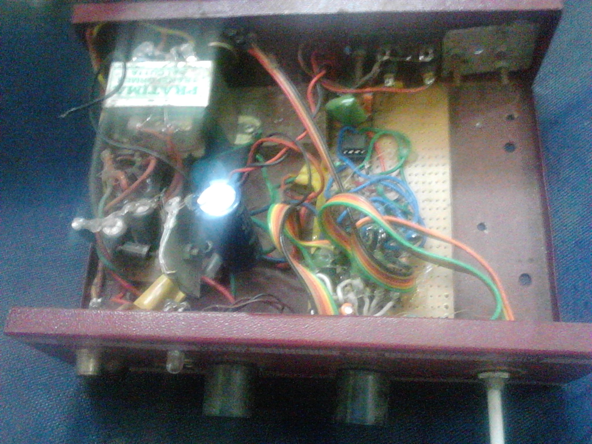

Problem solved! One of the pots ( midrange 100k ) had a dry solder joint.
All fixed now! Sound stage restored again !
Working great now! Thank you all!
The electrolytic has just enough leakage current such that it allows a DC path from the + input to the 47k resistor, the e-cap, and 100k resistor to ground. The film cap has very little (if at all) leakage current that's why the circuit no longer works with it.

I have seen some manufacturers use electrolytic caps in graphic equalizer and audio amplifier kits in the signal path.
Just a question , if nonpolar caps are performing so nicely both at the signal input and output stage why the designer used electrolytic caps ? ( ref: post 1)
Is this a mere cost factor?
