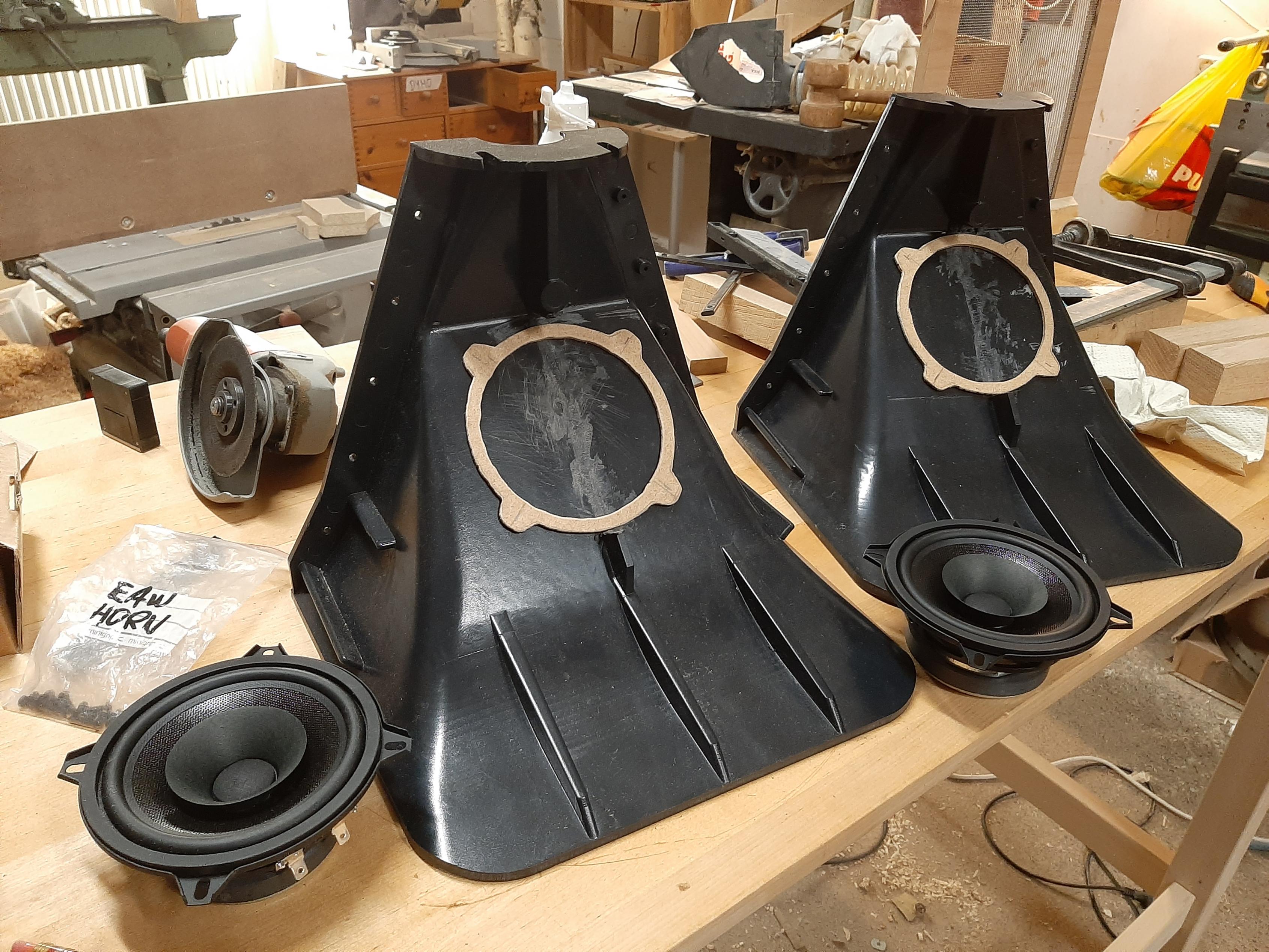

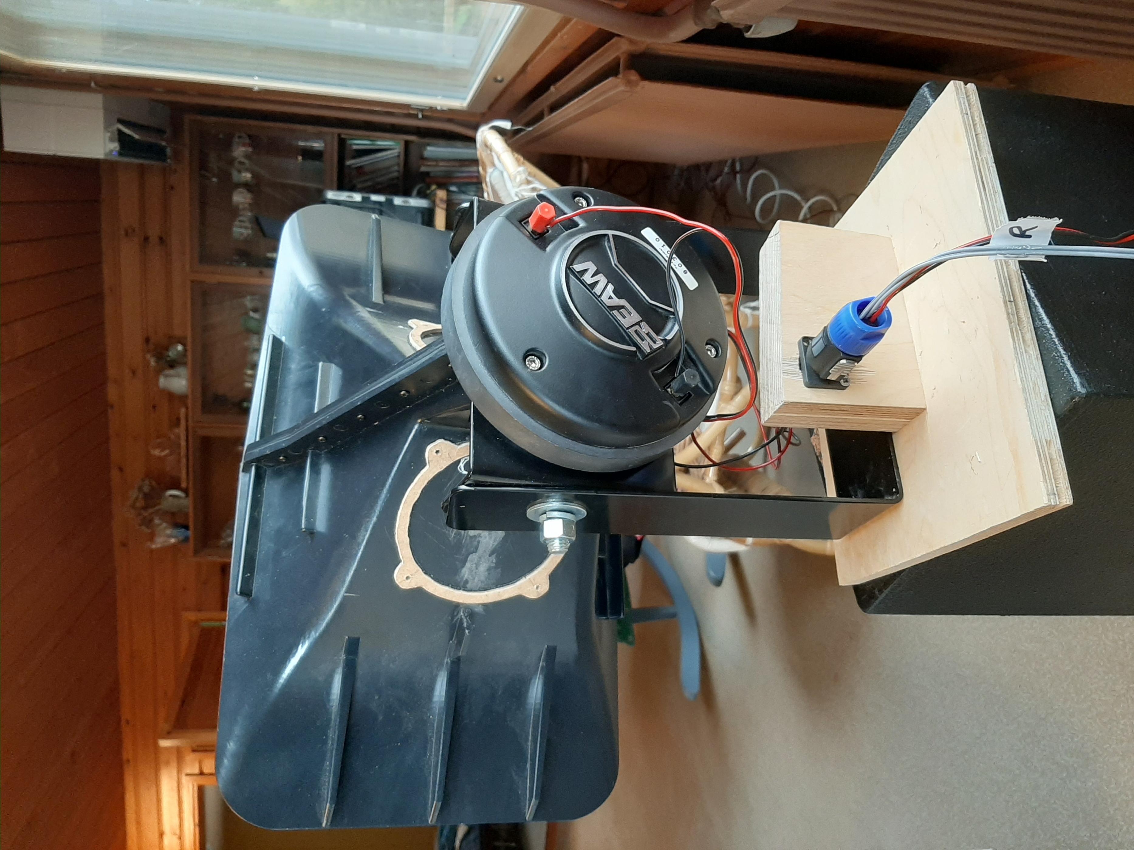

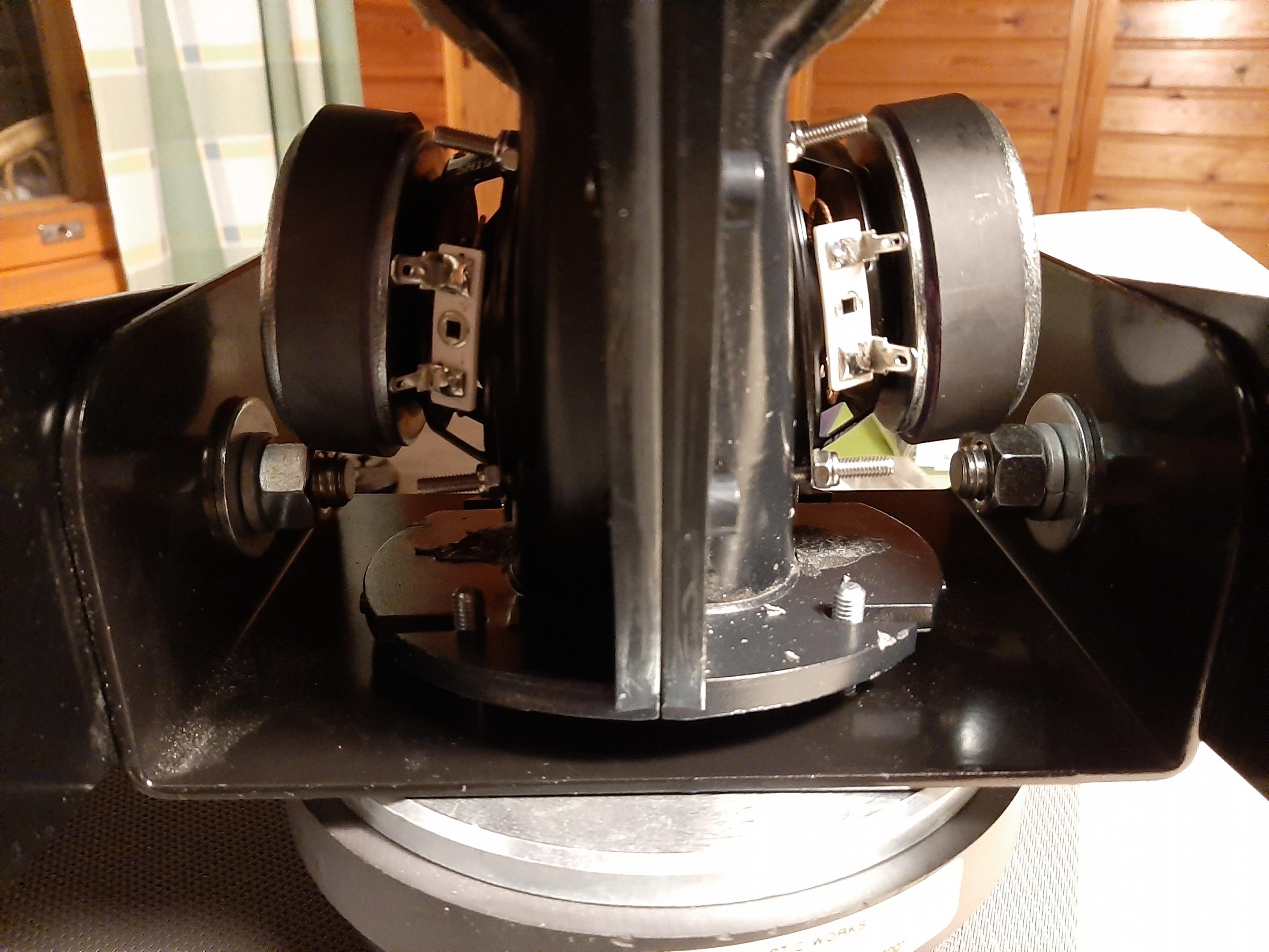

I have had this plastic hf horn laying around. It's from an EAW cinema system, loaded with a b&c de75. I noticed recently that this horn has a flat section that would lend itself for mounting a mid driver. I have wanted to experiment with synergy loading for some time, and since the horn is laying around unused, and is too big and too cumbersome to build a conventional two way box, i decided to do a quick and dirty synergy project.
I have removed the plastic bracing ribs from the back of the horn, and added 3mm spacers to mount my mid drivers on and have some excursion clearance.
Now the big question is about the taps. Size and placement. Afaik from reading a few synergy threads, they should be placed as close to the horn throat as possible. I am thinking about two taps per driver, maybe 10mm to start with? Is there any ballpark figure for the size? How big can i expect to go? I remember some people starting small and slowly increasing size to find optimum size by trial and error.

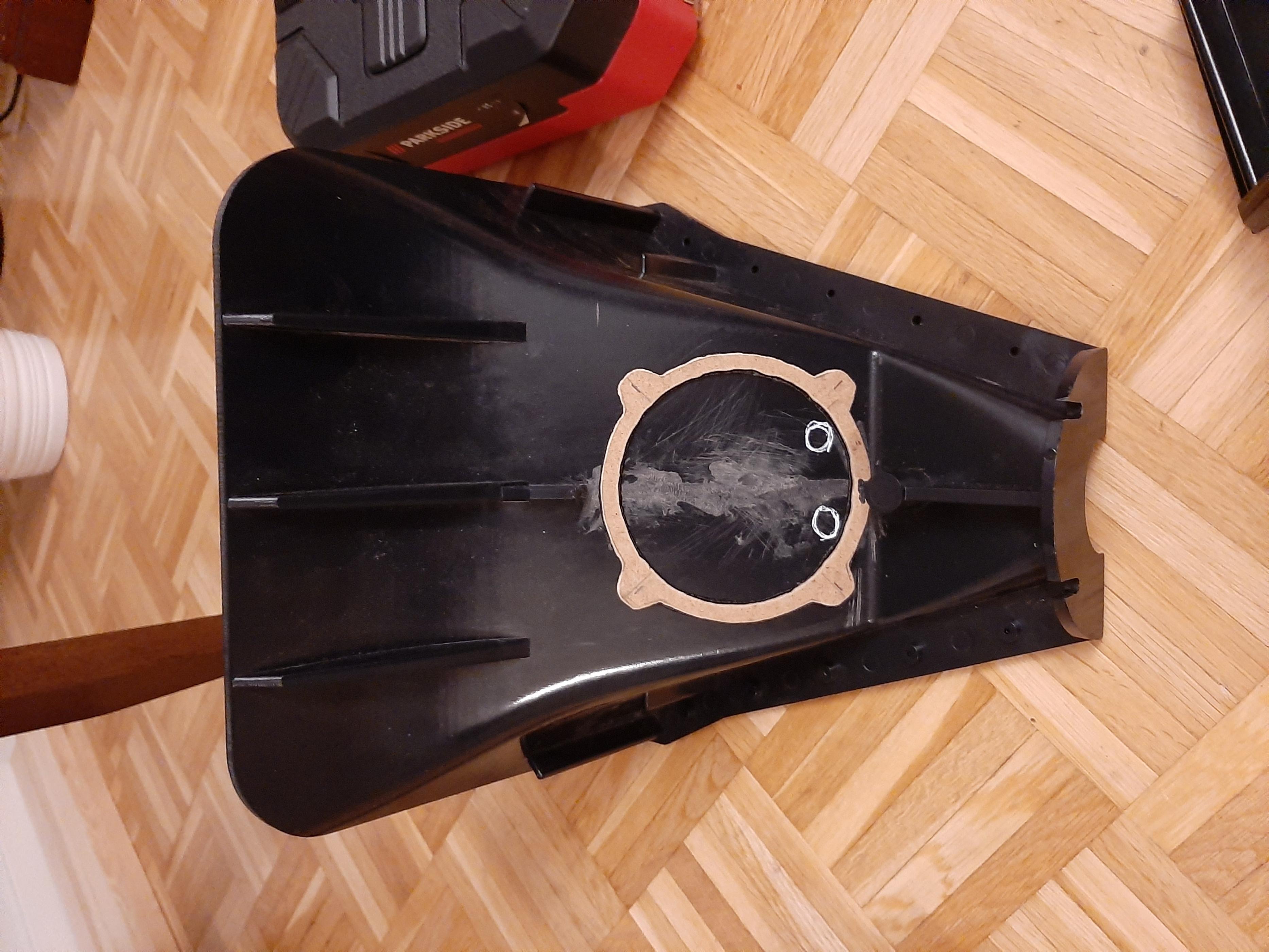

As mentioned, i have been scanning a few threads for information on midrange tap placement and scaling, but it is hard to find amongst the general development conversation.
I want to start by drilling a small pilot hole for each tap, and then gradually enlarge with a consecutively larger drill size, and maybe a reamer if necessary.
With this method, i need to have a rough idea how large the taps will be, so that i can optimize pilot hole placement, to make sure it is neither too far nor too close to the edge.
I drew two taps on one of the horns just to get a feeling for it. They are not aligned, i just wanted to get an idea of the scale. Does it look too small? Is it completely off? The cone driver gasket is 13 cm in diameter.
It depends on how powerful the motor is on the driver and what kind of a bandpass effect you want on the output. It really should be simulated. But as you don’t seem to be concerned about exact amounts and values, pick something - looks at cross sectional areas of vents on a bass reflex vs cone area. Typically 15% or so. A larger hole will let more air through and disrupt your horn profile. The trick is to make it just large enough to let the sound out nicely and not ruin the horn profile for the tweeter. You can also use a Dremel tool and then not confine yourself to round holes guided by pilots. They can be arcs, mesh like holes, slits, etc. they can be asymmetric. Have fun. Start small and enlarge is good as you can’t go back very easily.
I did once by 3D printing a curved piece and glued it back in place when my aperture was too big.
Probably no bigger than 30% of cone CSA. Start at 15% and enlarge up.

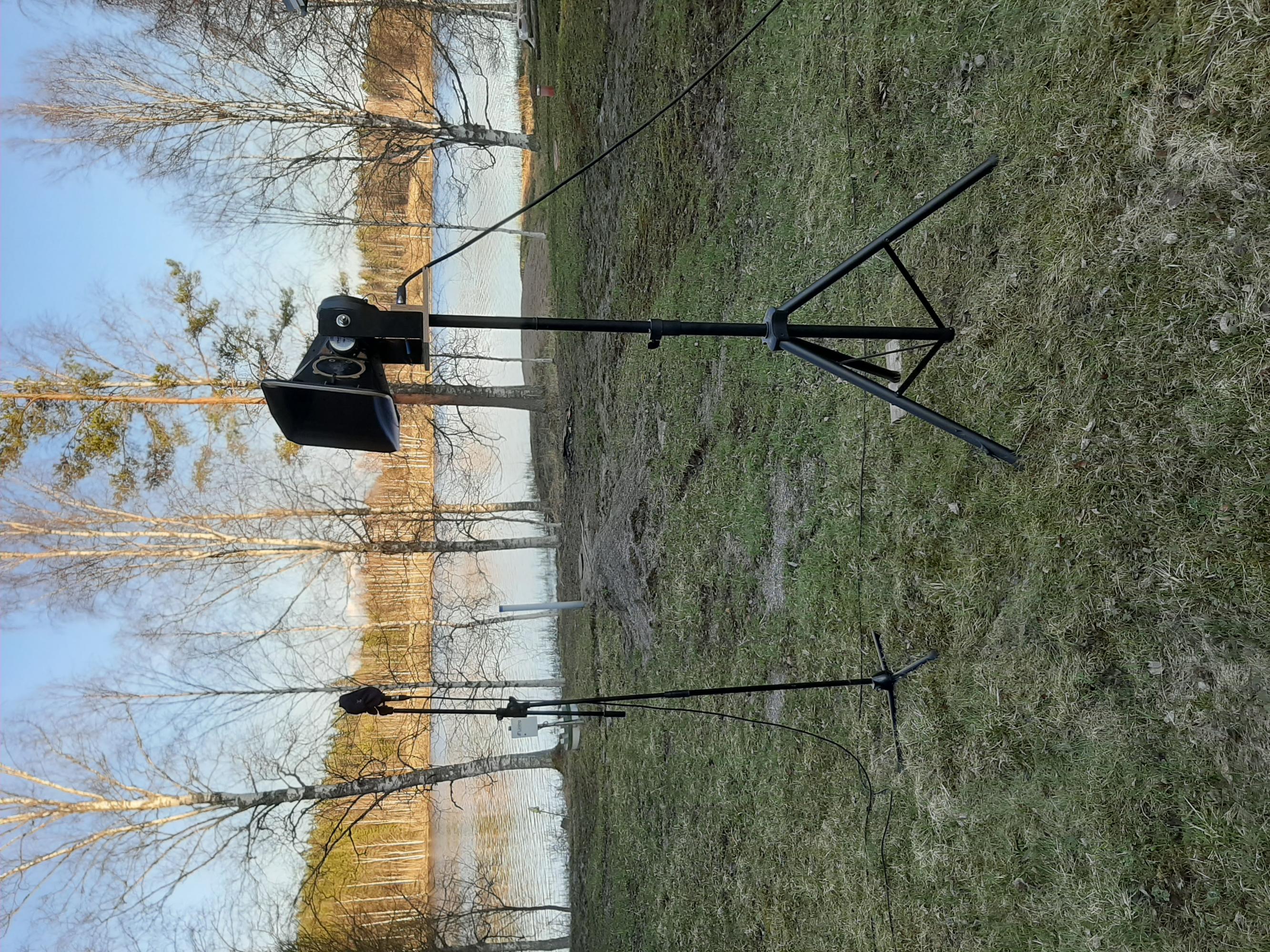

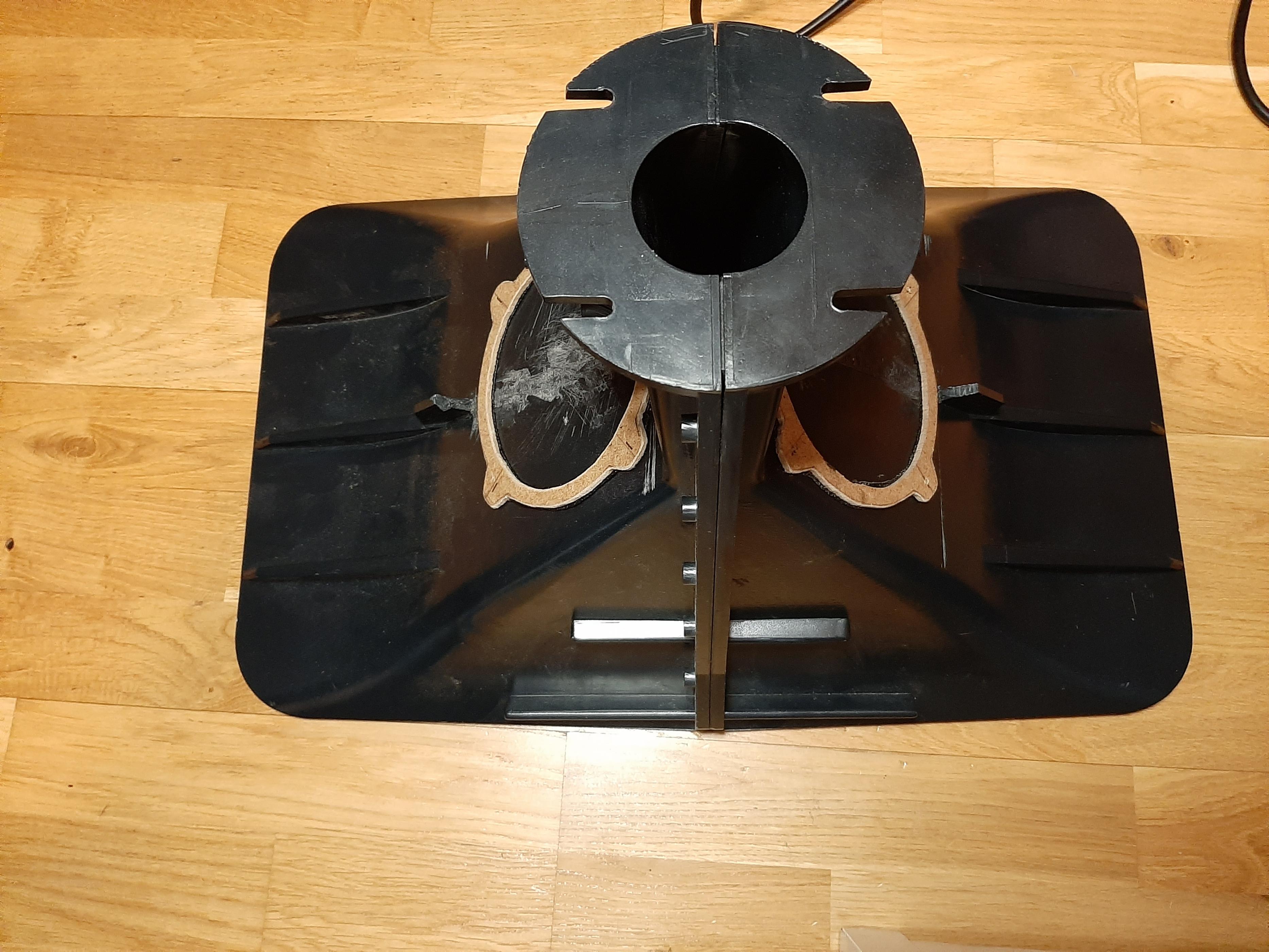

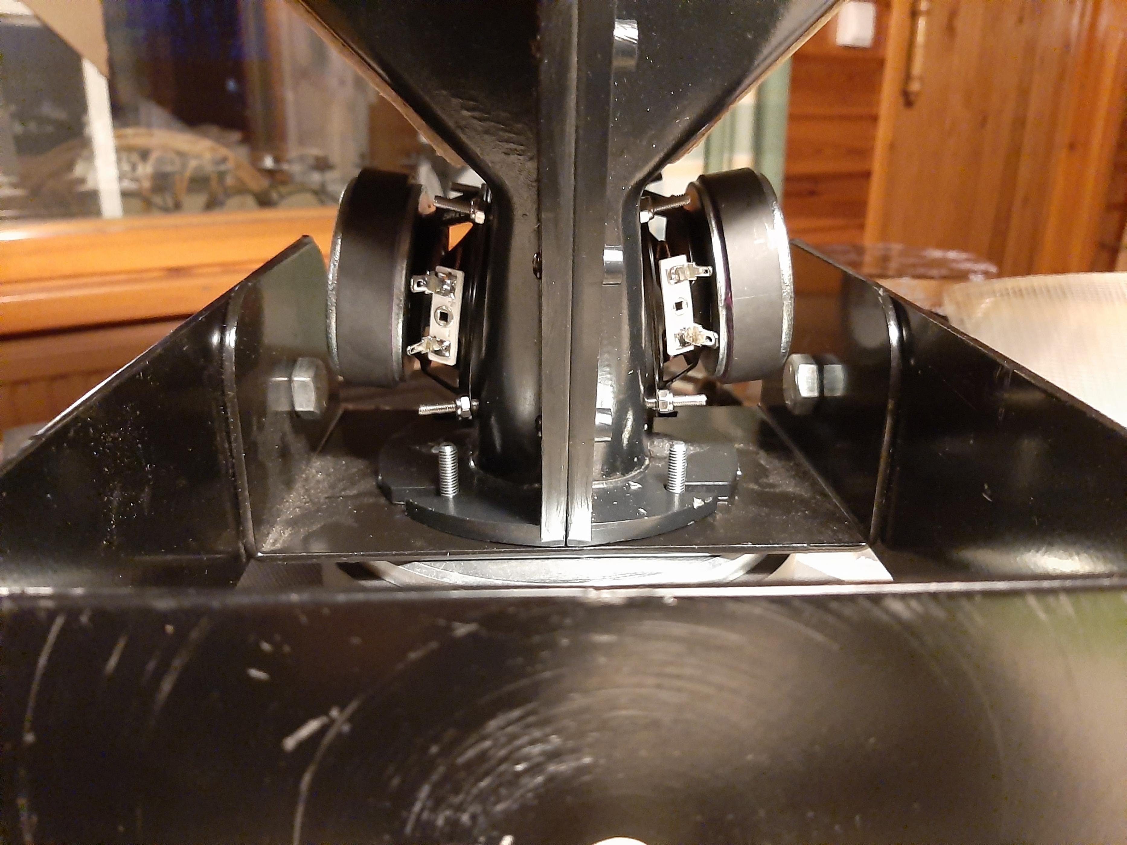

After finding a local supplier with Visaton FRS8 in stock, i jumped the gun and went ahead with the project. The drivers didnt fit at first, due to the length of the screws that connect the mounting plate of the horn and driver to the yoke. Flipping the screws around gave me just enough clearance to assemble everything.
The midrange taps are 12mm in diameter at the moment.
Crossover is a Harsch alignment at 1kHz. The Visatons go down to about 200 Hz, but i cut them off at 300 Hz.
Sounds quite nice. Unfortunately i have only one horn.
I did some free field measurements with room eq wizard. Unfortunately i didnt have a lot of time to play around, due to weather, lack of time, and other inconveniences.
But in conclusion, with a budget of 30 euros, it was definitely worth a try, and i will keep working on it as time permits.
