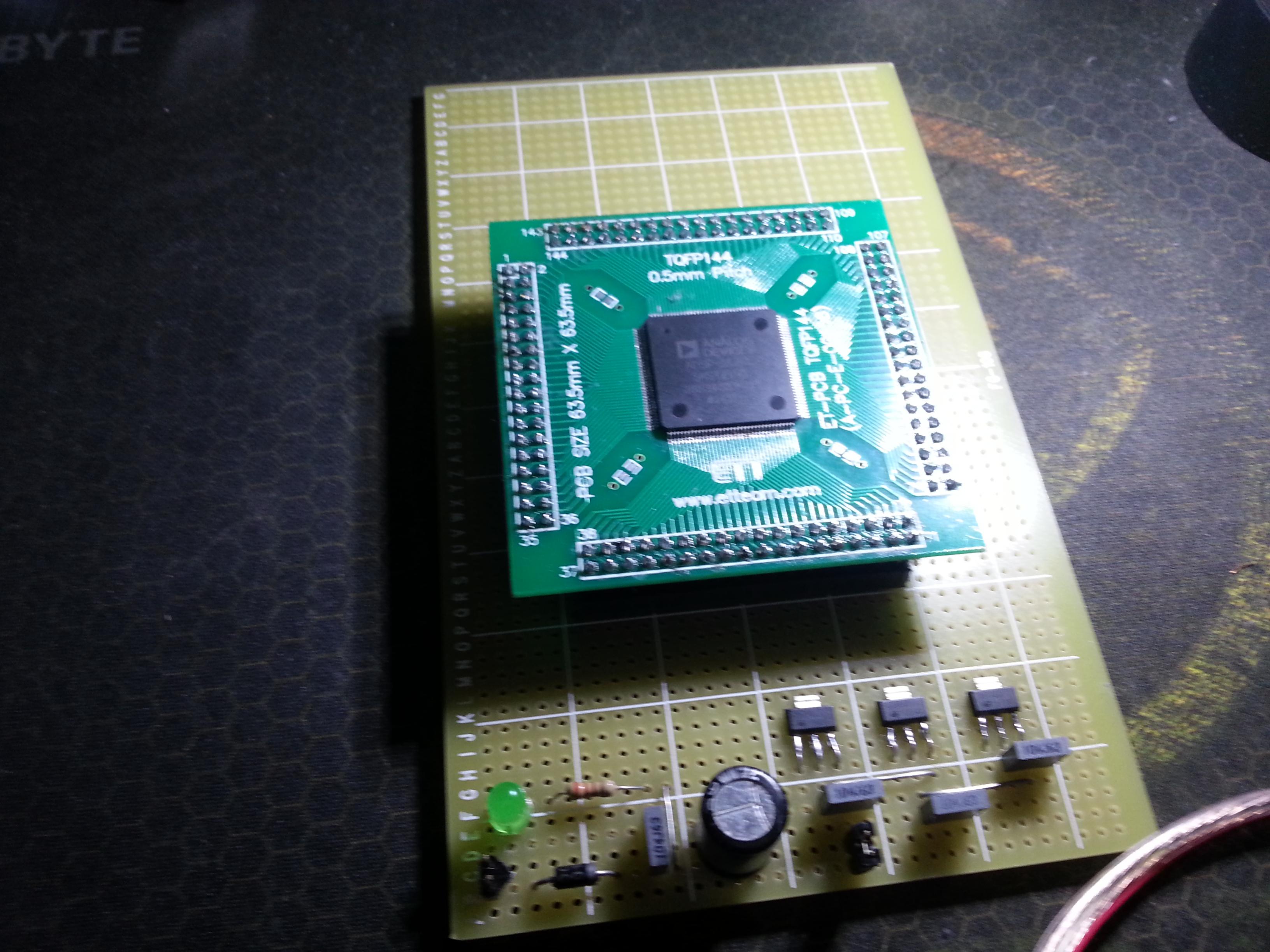

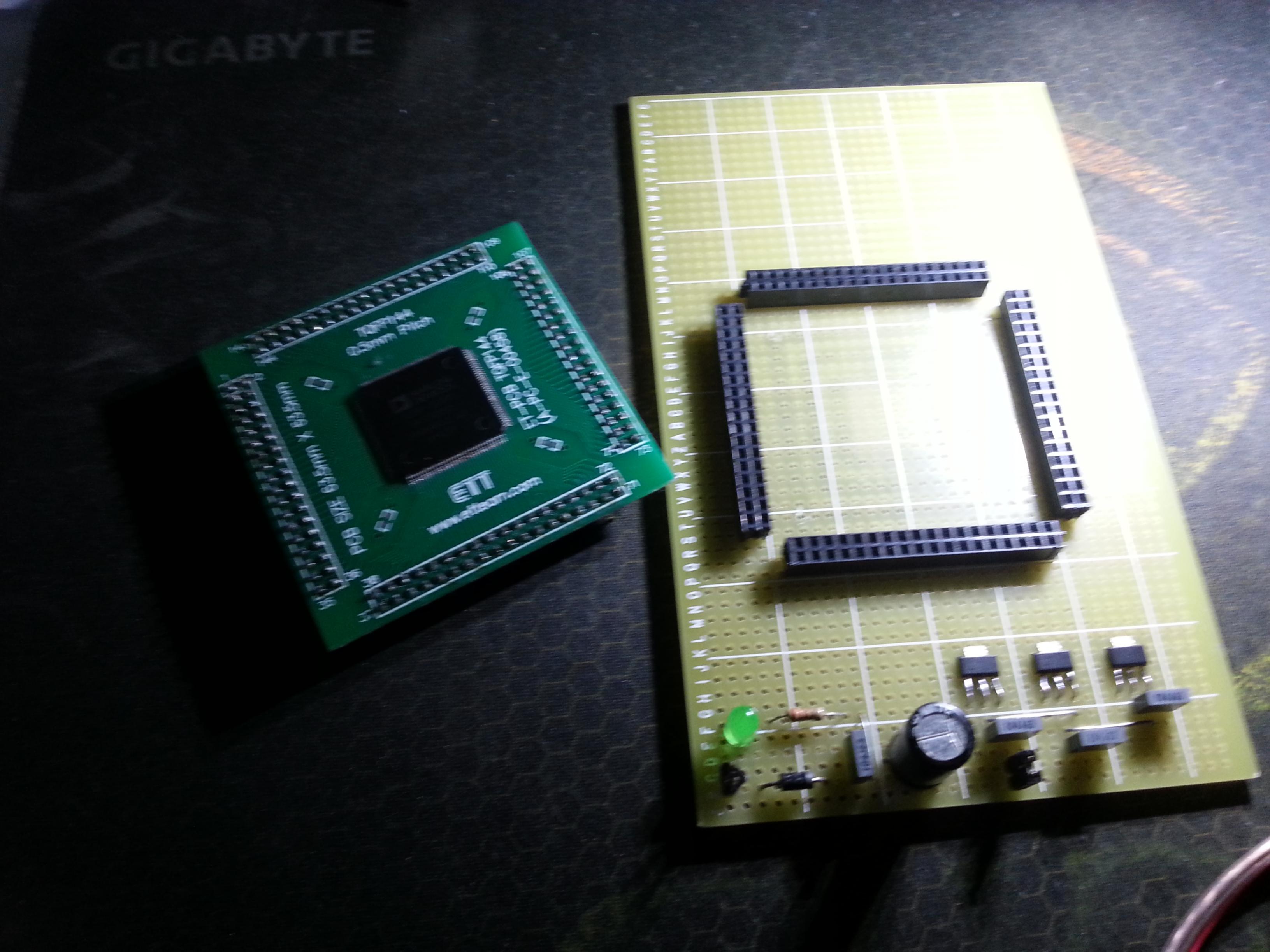

I'm now at a point where I'm ready to apply what I did in hardware, but decent SHARC audio DSP hardware costs money!, So... I decided to put together a small demo board on pref board, (yes that's right on pref board frowned upon for legit reasons)

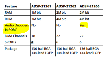

The Hardware for this project is made up of a ADSP 21261, 150MHz with up to 4-channels of audio, the objective will be to get the processor to boot via SPI and process x6 audio channels with basic processing, nothing advance the point of the project isn't commercial just pure fun and learning.
