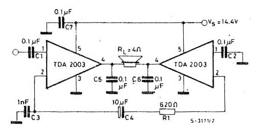

im currentley working on a 2x 20 watt amp using the tda 2003 its quite cheap to make and decent sound quality i dont know what its like with regular batterys but it runs for a good time on my drill battery
anyway heres the circuit diagram for it

TEA2025 is a nice simple chip that will run BTL, runs of 6-12 volts, and will put 4.7 watts into an 8ohm speaker in BTL.
Idea chip for battery operated devices.

I just got some TDA7267 ICs. After doing careful tests with my oscilloscope and function generator, I found it to deliver 1.8 watts (non clipping) into a 5 Ohm load with a 9 volt Vs. This is very good performance for a single ended output IC. It requires very few components.

A really good chip quad IC for battery power (12 volts ideally) is the TDA7375.
4 seperate channels, and each channel can be bridged for 2 channels with a lot more power.
You can create your 12 volts with a gell cell.
can put 35 watts into two speakers.

With AA batteries, even the the single ended amps will run them down quite a bit after just an hour or two of listening with 4 ohm loads at high volumes.
While bridge amps can make 4x the power of single ended, they will run even D cells down quickly.
I recommend a single ended amp with efficient speakers. I used guitar speaker once and the setup was screaming loud, even at 1 watt. Sound may not be hifi, but it was better than most off the shelf boom boxes.
