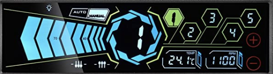

I have them on a fan speed controller so I was able to dial in the air flow. But according to Hypex, there's nowhere to tap fan power on the 1200 so you'll need to solve for that.
I don't (yet) have an integrated solution to power the fans. My setup happens to be near by a PC (source) so I ran a 4 pin molex in to the amplifier.
It's not a terrible solution.. you'd just be dependent on that extra input.
The fan controller has 1 molex input and 5x 3 pin fan outputs. The fan controller monitors fan speeds, temperature, and has an alarm in case a fan stops or fails. It can also automatically regulate fan speed based on temps which is nice. But I leave it on manual.
The controller I picked up is honestly overkill and you can dim it but there doesn't seem to be a way to completely turn off the touch screen LCD.
