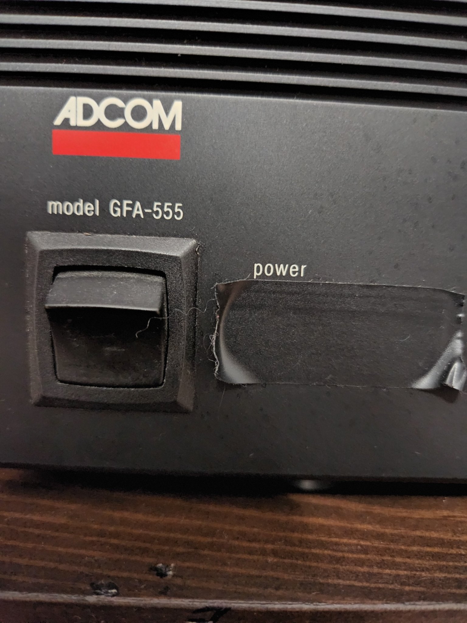

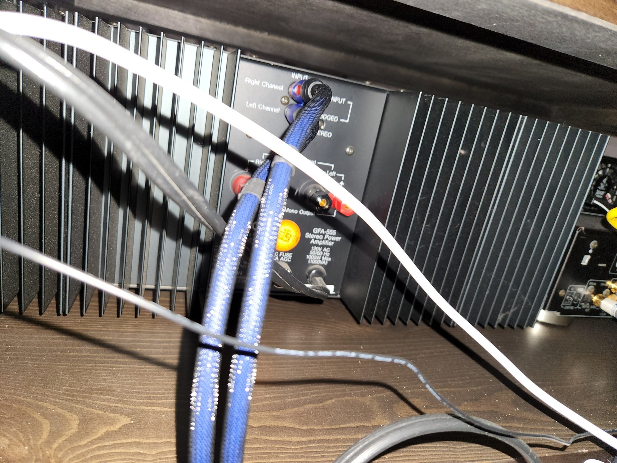

Hi All. I have a GFA-555 (I believe a MK1 from my research) that is still working but has some issues. I'm a Controls and Automation Engineer, but I have zero experience working with amplifiers. This amp has tremendous sentimental value to me (my deceased Brother and I used to listen together with this amp) , and I'm not sure I trust myself to try and repair on my own. The amp is making the 'mouse fart noise' when it powers down, and I've lost a tweeter in one of my mains (Polk rti12). I'm not sure if the two are related, but I've pulled the amp from service until I can restore it.
I have decent Electrical knowledge, but it's mostly around Industrial Controls (480 3PH and 24V DC). My soldering is decent as I'm big into building and flying large RC Helicopters. None of this is related to amp repair, but I wanted to give an idea of my background and basic skills. I found the Hoppe's Brain site, but I'm not sure if repairing the amp is something that is easy or difficult? Am I just swapping out boards and replacing caps, or is a full restoration super complicated? If the amp didn't have so much sentimental value, I would probably dive right in. I would feel horrible if I damaged it beyond repair.
Is this something I may have the skills to tackle, or should I play it safe and leave it to the professionals? I live in Greenville, SC. Not sure what to do here. What are your thoughts about the best way to tackle this?
