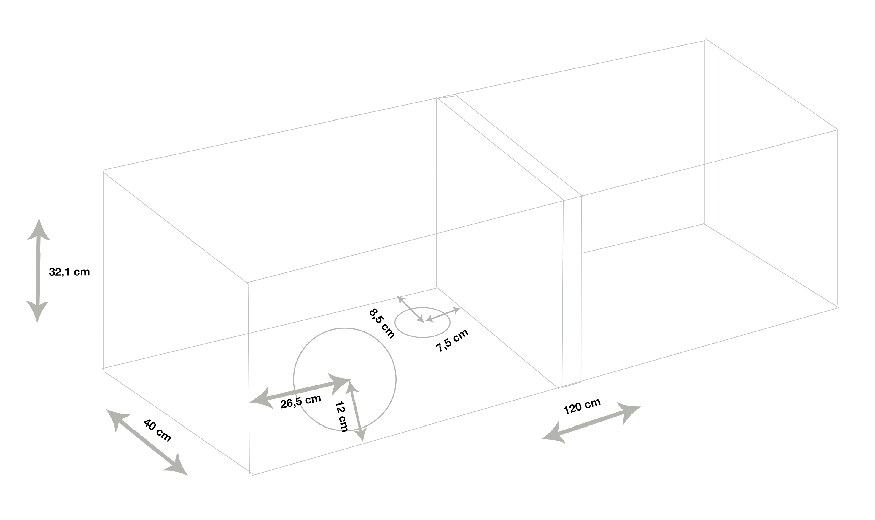

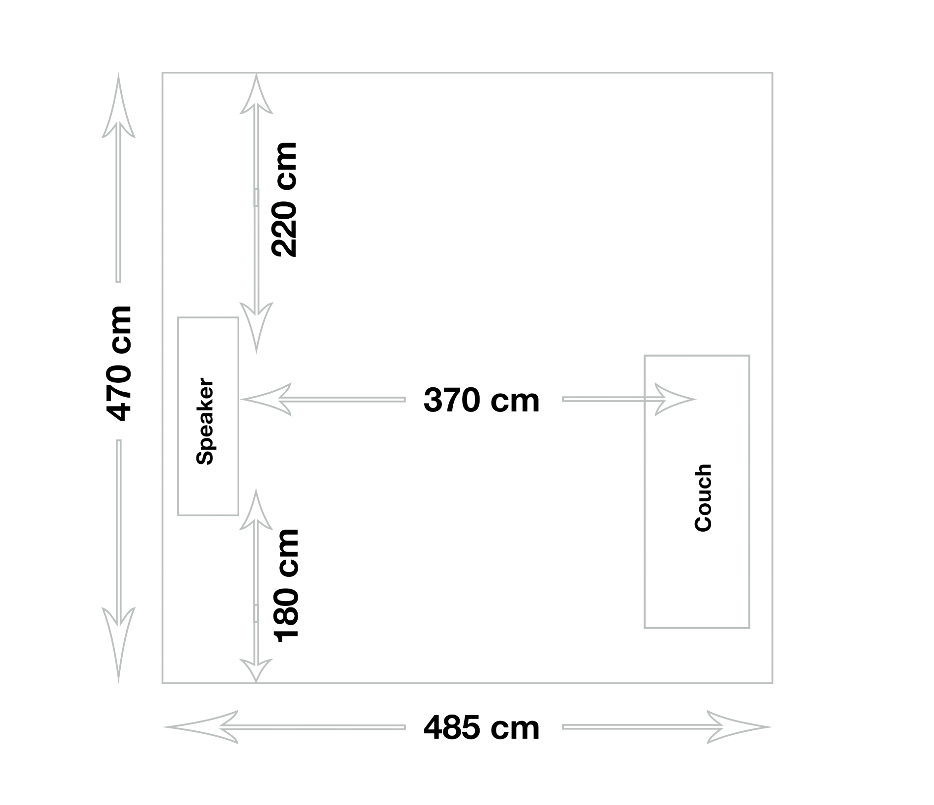

In your case, making a dimensioned drawing with all the cab's internal dimensions plus where the drivers, port are in relation to them, so we can figure out what its basic 'in room' eigenmodes are; and since measuring from the LP, need one of the room too including where the LP, any major acoustically reflected furniture/whatever is.

Here's some drawings (see attached). Regarding the room, I didn't have problems with my previous speaker that was almost identical in size and placement of woofers.
I also tested a couple of bookshelf speakers the other day just placed on top that didn't have any bass issues.
Already checked floor/ceiling bounce and the first reflections doesn't match/show up on measurements. I reckon they are filled in by other room modes/reflections. Anyways, it's much higher in frequency.

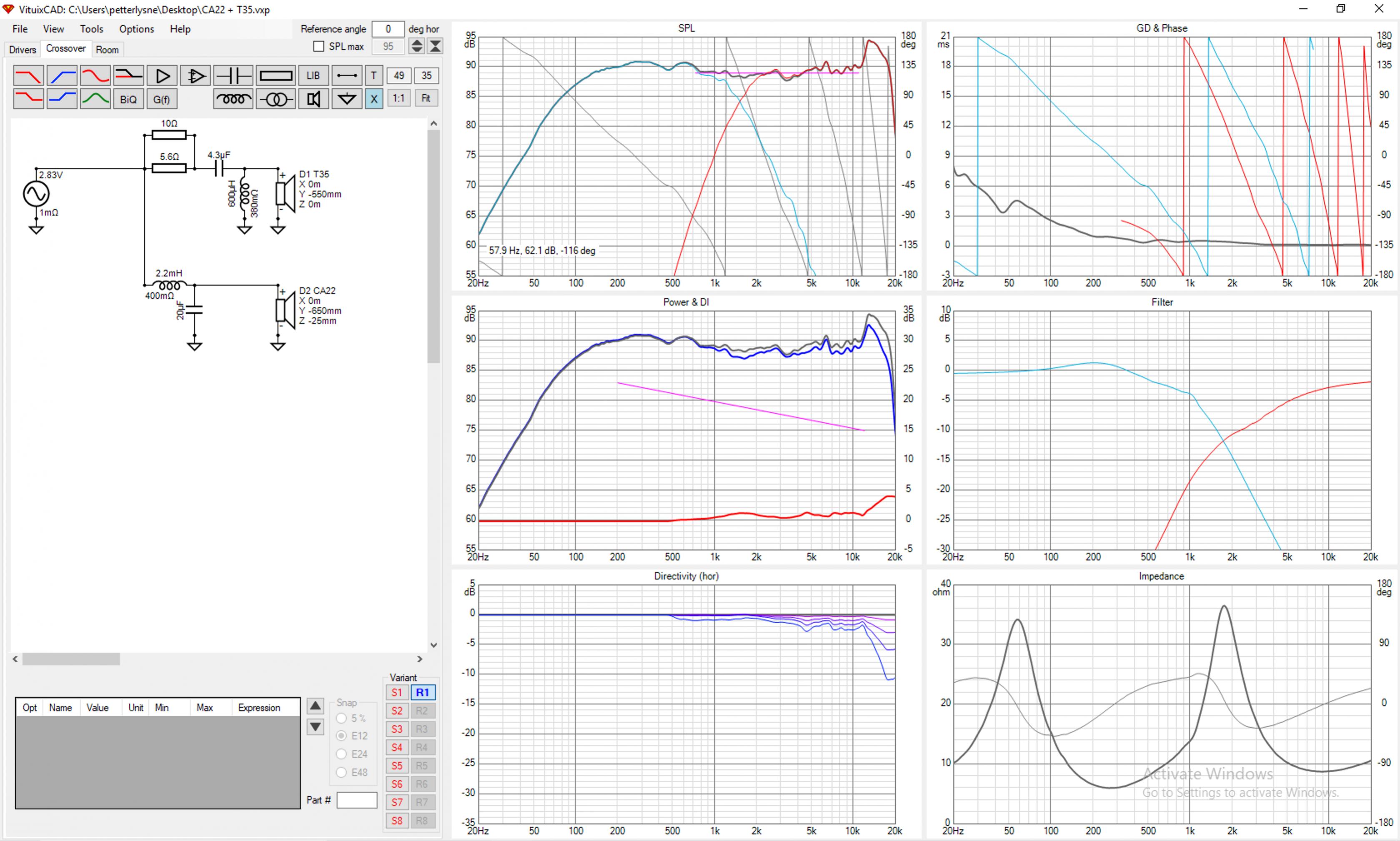

The rising response and BSC is taken care of in crossover. See attached schematic and simulation. Woofer measurements are taken directly from Seas (which are done in a similarly sized cabinet and includes baffle step loss).
