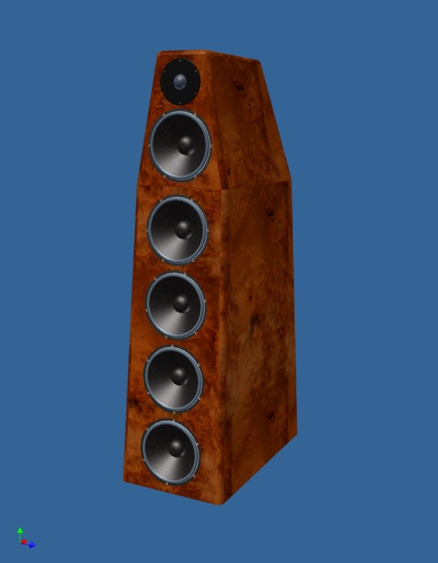

PJ,
Did you ever come up with a design idea for your new system. The reason I ask is that I think I have come up with a good way to design a high efficiency medium sized floor standing speaker with a reasonably narrow baffle. I have this design problem which is different than the one I have for the HT. I want to replace some inexpensive stand mounted two-ways which are in the living room system with a nearly full range, dynamic, easy to drive speaker. Right now I have a Morel MDT33 hanging around unused and my idea is to use it as the starting place. The idea is to select drivers that allow for high dynamic range and sensitivity which will also sound better at low volume levels. After all of my iterations I have hit upon this formulation and I though you might consider it.
First, I have a 92.5 db sensitive tweeter that I want to use and I want to use it without having to pad it down much, if at all. So then I need to find a mid bass with around a 93-94 db sensitivity. The only one that I have been able to locate thus far with a reasonably smooth response is a Foxtex 6 inch full ranger. I generally like my upper end about .5 db lower in volume and crossed around 3kHz and this driver should work for this. Pro tweeters and drivers could be used to create an even more efficient system.
Next come the rest of the design concept. Dealing with baffle step and getting good bass in a small narrow cabinet.
The idea is kind of like a Watt/Puppy with a pyramidal upper two way unit on top of a lower bass unit. THe difference is that it will be a little taller and narrower and have a slightly sloping side wall on the lower cabinet. The kicker is that I will use 4, 6.5 or 7 inch drivers wired in series parallel to give an 8 ohm load for the lower section. This will keep the cabinet narrow enough to make it easier to place and have higher WAF. Now, since there will be four drivers shouldering the load and operating in only the lower frequencies, they do not need to be expensive drivers but can be of good quality value priced drivers.
The idea is to cross the lower units at or near the BSC frequency and select the sensitivity of the drivers so that combined they give the needed BSC. This should give me the full 6db of BSC without any additional power drain from the amp if the woofers have the same sensitivity as the mid/bass. Together, the lower drivers will have the surface area of a 12 inch driver so I should get good air coupling for better bass dynamics.
I will probably only want 2-3db of BSC in the room for these speakers so I will find some drivers of a little lower sensitivity than the mid/bass. So as I see it I could have 96-99db sensitivity in the lower octaves which should be quite dynamic for a speaker using standard home audio drivers.
The beauty of this approach is that I don't have to waste driver efficiency and use much if any resistor padding on the drivers which can rob the life out of drivers.
Here is a 3D mock-up of the above idea:
yeah I have also considered designs of a similar nature. I'm really unsure at this point what I want to do. I'm even considering the Geddes kits, which I know go against everything I have been saying, but I dont know. I mean, I just can't come up with something that sounds good to me, has the efficiency I want, and the dynamic abilities. I'm trying to decide if I can live with such large speakers.
Earl is saying the 12" is better in every way and I should get those, but I mean, 22" wide isn't exactly a small thing to hide. I feel like my best bet would be to turn them into a work of art, and not try to hide them. you know, fancy veneer, unusual enclosure shape, and maybe painting the baffle some bright color or something. We shall see, I still prefer the idea of a smaller profile speaker, but I keep hearing good things about them, and there seems to be some pretty sound science behind the designs.
I ended up getting a bunch of those Dayton 8" reference woofers and building a test baffle for my focals. I wired them so the Focals were basically a mid and tweet, around 90db efficient. Then wired up 4 of the woofers per side in a series parallel configuration giving me around 91-92db's efficiency. I wired them up using a series crossover on top, and a parallel configuration for the woofers. Still wasn't enough for me, I wanted more. I felt like the midrange and tweeter still could sound compressed durring large peaks. I tried replacing the tweeter with the HDS peerless, it was no better. I mean, its a great tweeter, but it just didn't give me what I was looking for. I even tried replacing the focal midrange driver with a Seas unit, running that with the Focal tweeter and the HDS tweeter, still wasn't what I wanted. I'm just thinking I really want serious efficiency to get the kind of dynamics and realism I'm looking for. None of these setups, as good as they may be, gave me the effortless sound I'm looking for.
Now, having said all that, I've never heard a big wide monster speaker that imaged good. I've owned two large towers, which imaged horribly. My father owns Klipsch Corner Horns, they don't image well, IMO. Only speakers I have heard that imaged well generally had a narrow footprint, so that is one thing that concerns me about the big wide speaker idea. I mean, will I be making another trade-off.
