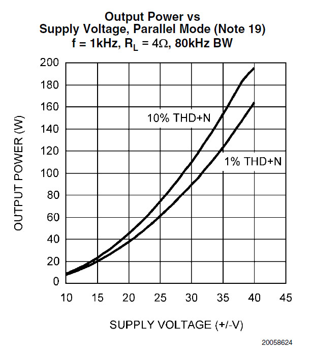

Please read this article first: Amplifier Power Ratings
The amplifier's power will depend on supply voltage, available current and load impedance. Assuming first two parameters don't change, the power will double when moving from 8 ohm speakers to 4ohm.
To maximize power from LM4780 kit, you need to use voltage supply close to maximum allowable rating, which is +/-40V. While with a single amp inside LM4780 chip (half of the chip as used in stereo mode) that would be not a good idea as amp would not be able to produce enough current, connecting 2 amps in parallel should be fine and you will be able to get 120W. The transformer should be at least 25v + 25v.
Parallel is when you have inputs and outputs of both amps connected together, and for that you do not need balanced source.
Bridged is recommended for 8 ohm loads, and can be compared to both amps connected in series, where you feed each amp section with opposite polarity signal and the output is taken from "between" the amps with no reference to ground. Read page 7 of this manual for more info: http://www.firstwatt.com/downloads/f4_om.pdf

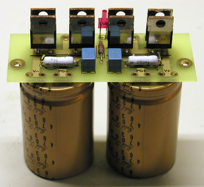

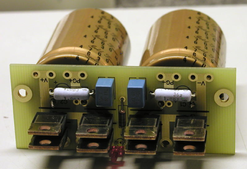

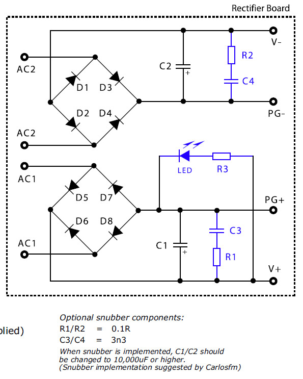

Looks like each amp board only has a 1500uF smoothing cap per rail.
For the intended use i.e. mono bass into a 4ohm load, wouldn't it be smart to increase that? Maybe an extra 4700uF or even 10000uF per rail connected between the rectifier board and the amp board?
That's a good point and certainly worth trying. There are dedicated pads on rectifier board to mound additional caps. Some people also prefer to use snubbers when there's more capacitance and there's also space on board for those parts. However, using 1500uF is a good starting point and you may not necessarily like more caps.
Pictures show LM3875 PS board and for LM4780 the layout is very similar (although diodes mounting is reversed).
Thanks for the tips. I'll try it as is first and then if bass performance needs improving, I'll add some 4700uF-10,000uF caps on each c1/c2.
Even with that extra capacitance added, the snubber components are still optional as well, yes?
Yes, snubbers are optional. Generally they supposed to improve definition of bass when large caps are being used. In a long run I found them too manipulative to a sound.
