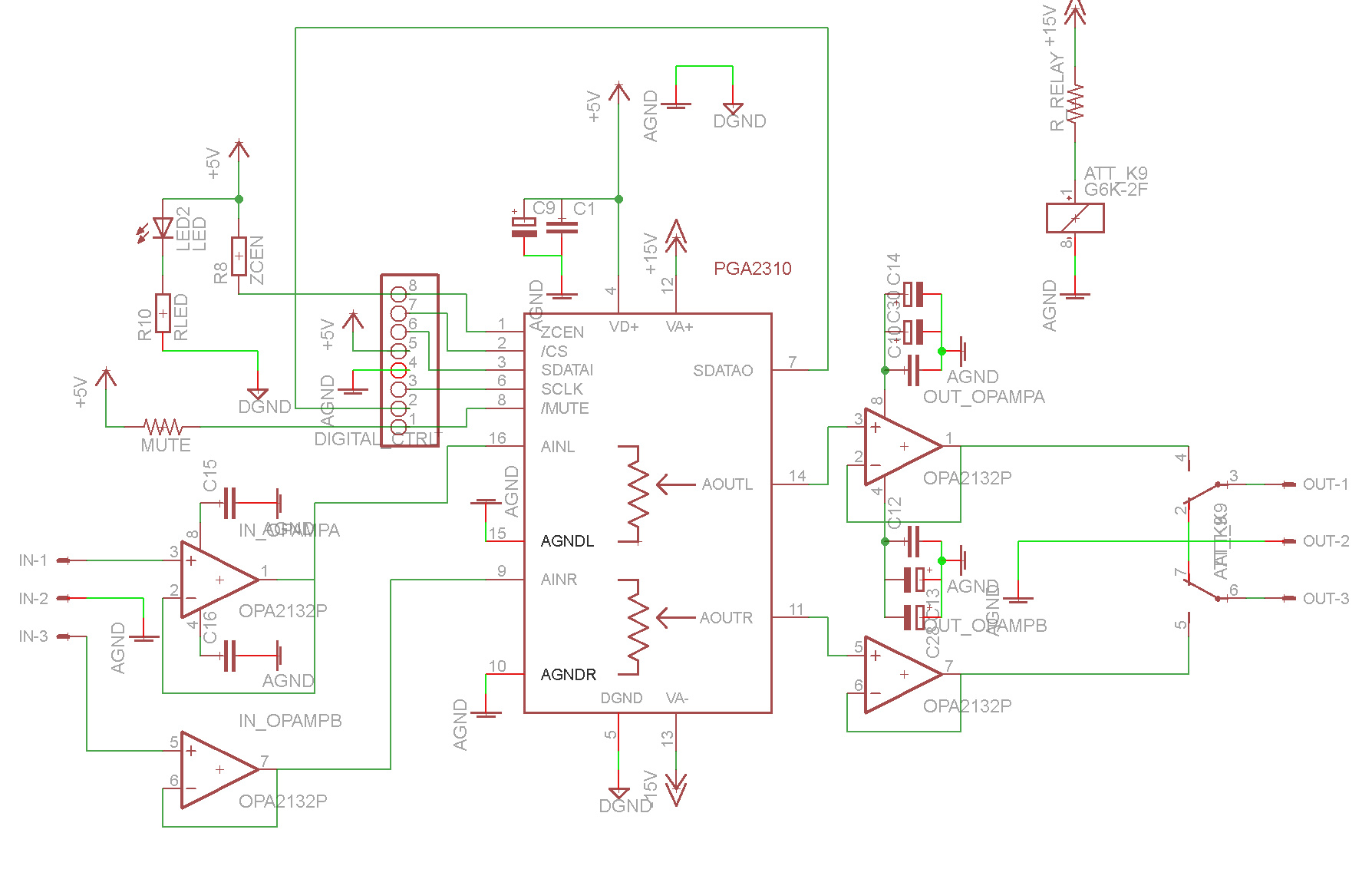

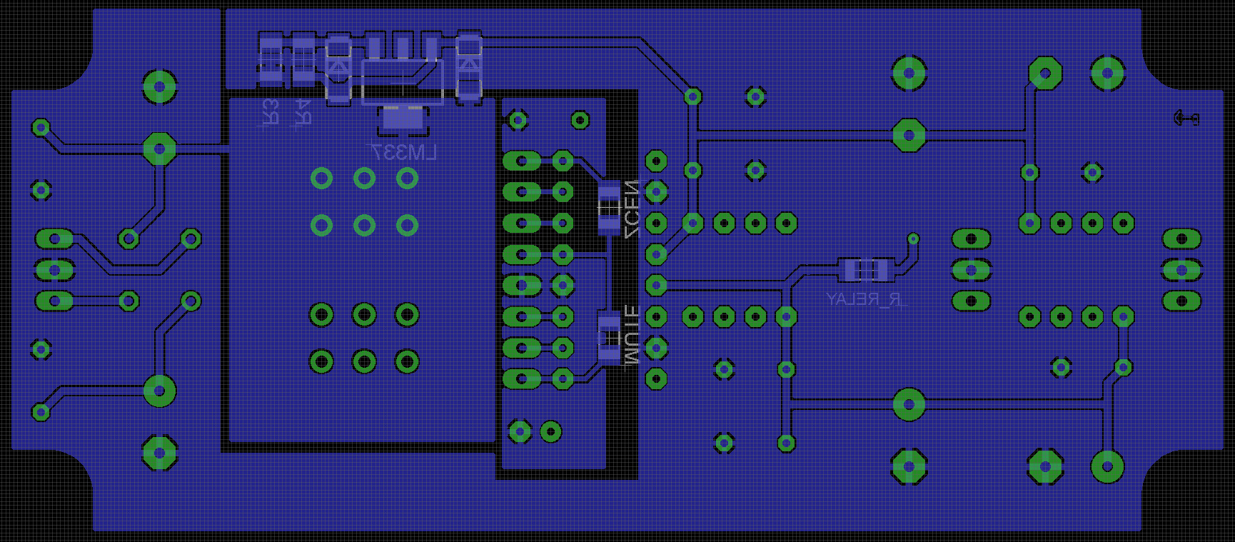

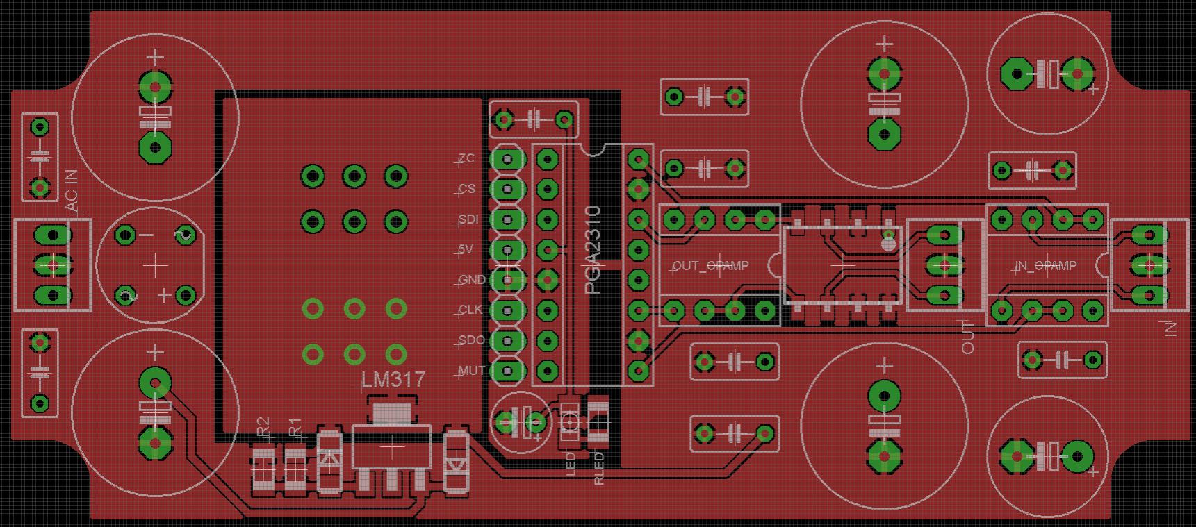

I have no clicks, noise or any other problems on my implementation. However, I took a lot of care in the layout - the uController is isolated competely from the PGA via optos. The rise fall times on the digital control signals are as a result quite slow was well (a few us) and this also helps since you don't have fast rising edhes in the vicinity of the chip.

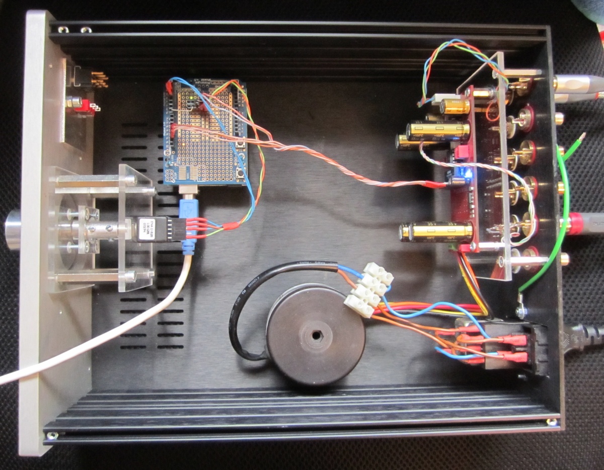

"USB DAC ---> PGA ---> Hypex Amp ---> Speakers = Noisey""
I am willing to bet you have radiated noise from your Hypex units, or, mains conducted noise from the SMPS I see in your photo.
If you have a common mode choke, you might try that on the mains cable. Only other alternative is to move the hypex modules further way. If the noise goes down when you do this, it likely radiated noise - if not, look at mains conducted noise.
How are you coupling your control signals to the PGA - is it a cable, or does the controller plug onto the pins?
See the attached picture. The thing on the top left of the case is the Arduino which is connected to the encoder, USB and the PGA module. The PGA modules gets Vd from the Arduino/USB. Before you suspect the USB for the noise, I've tried setting the volume and then disconnecting the power to the Arduino as once the PGA volume has been set it stays even when the digital section is not powered. I've also tried battery power.
ok - if you short the inputs, what happens
Short the input to the Hypex amp or the input to the PGA? When the PGA input is shorted, there is noise. When the Hypex input is shorted, it is silent.
Both the Hypex Amp and the PGA module power supplies have mains filters, similar to this thing. I tried plugging the PGA module into the mains on the other side of the room, no change.

If is schematic in post 22 valid, I see here more possible problems:
Undefined ground potential at inpput (missing resitors from OA +Inputs to groud), missing input hf filtering (some RC lowpas at inputs, blocking capacitors..), missing series resitors (15-100R) in outputs, capacitive load (cable ..) can cause instabilty and oscilations-manifests itself sometimes as noise.. Output opamps are not needed, PGA internal opamps can drive relatively low loads (600ohm an more) direct.
So, you mean the following:
1. Some resistors from Input to GND, say 10k?
2. Input capacitors, as in caps in a series with the signal?
3. Resistors in series with the output, say 100R?
Yes, this defines the input impedance of the unit too. With this set too high or undefined you can get problems.
Yes, these block any DC but might not be required. BV however was also referring to an RC network, with R in series and C to ground to form a low pass. This will prevent any high frequency grunge from entering the device that could cause problems.
Absolutely, these are necessary to keep things stable, although whether or not you will get instabilities depends on the cables connected to the system, the load at the other end and then the opamp driving the load. The 100R effectively decouples the output from any parasitic reactance that could cause instability.
I think all these suggestions are valid MAXW. So add the series output resistors, add the input bias resistors.
But, I think you still have noise problems from your Hypex units and SMPS. You only have noise when they are connected in h signal chain. You may need some screening and mains filtering to solve this.
