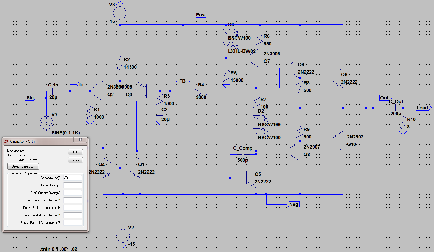

Getting a little help building an audio amplifier
I'm more inclined to help somebody who includes a little profile info about himself and his background . . . but since you provided a link and attached the circuit file I'll give it a shot. (At least until I have to actually THINK about the problem - thinking makes my brain hurt.)
Computer programs like LTSpice are rather simple things. They tend to do EXACTLY what you tell them to do . . . which MAY (or may not) be what you want them to do. Your attached circuit file simulates nicely, and its simulated behavior agrees with my intuition for the topology and values you have entered. (I have not done any calculations to check against simulated results.)
Your big error is the capacitor values you specified. The original SPICE program expected capacitances to be specified in FARADS and LTSpice has adhered to this standard. Most practical capacitors have values in the MICRO-farad, or PICO-farad range. Consequently LTSpice sees your C1 as a 2,000 microfarad capacitor; C2 is 200 uFd. While probably not very realistic, these values are tolerable. The 200 uFd output coupling capacitor with the 8 ohm load should be flat to a few hundred Hertz if I remember correctly; this may not be your design goal but you can see it in an .ac analysis and easily correct it.
What is causing the simulation results to be different from your expectations is the compensation capacitor (C3) value. The web page for your circuit suggests that 500 PICO-farads is a suitable value. Your circuit file calls for 2000 MICRO-farads - a value FOUR MILLION times larger than shown on the web page!
LTSpice allows you to use letter abbreviations for many standard engineering power-of-ten notations. In this case, use the lower-case "u" in capacitor values to represent "micro-farads", and lower-case "p" for "pico-farads". (I think those letter abbreviations are accepted by default, but you might have to poke around in the "Control Panel" menu and check a box to activate that feature.) Other letter suffixes it recognizes include upper-case "K" for "kilo-", upper-case "G" for "gig-", and I think it accepts lower-case "n" for "nano-". BE CAREFUL with "M"!! That is used for "milli-", e.g. "10M" could be the value for a 10 milli-ohm current-sensing resistor. If you want to specify a 10 MEG-ohm resistor, you need to spell out "10MEG".
Once you have corrected that problem . . . the LED's you use in the bias networks are setting the idle currents way too high! I'll let you do a little background investigation to get a better understanding of why it works this way.
(You can use LTSpice to do some of this investigation. Look at the DC operating point voltages for the nodes associated with the bias networks, then compare them to the operating point voltages when you use the diode types specified on the web page where you found the circuit.)
The output transistors you chose (2N2222/2N2907) are really NOT suitable for driving an 8 ohm load. I'm not sure how the simulator will behave since you're asking it to operate these devices well outside their design envelope. (I don't know if the devices called for on your circuit's web page are available in a basic LTSpice installation or not. I've added quite a few devices to my "standard.bjt" file, so just because a device is listed on my installation doesn't mean it's available to you. You should learn how to paste device models right on your schematic diagram and call them out using the "Component Attributes" dialog but for the first few hours you play with LTSpice it's easier to use the built-in models.
While you're playing with this file . . . add some labels to a few of the nodes so you can easily refer to them by name rather than cryptic (and changeable) node numbers. Also consider changing a few of the component designators to more meaningful names.

Thanks so much for your help. I made the changes you suggested. I changed the caps, the diodes (to those of the original circuit), voltage rails to 13.8v, added the models for the power transistors and the circuit seems to be amplifying properly.

Thanks for your response.
I have already added the proper spice models to my spice directory. I was not asking for someone to find the models and do it for me. I was just stating that because I didn't want people to waste their time opening it if they couldn't simulate it without the models that I have. I suppose what I should have done is just posted the text here for each model that I added and others could add it to their libraries if they chose to view my circuit. Sorry for the confusion.
I am also sorry that I posted a link that was apparently not private. (wasn't thinking 🙁 )
Current Circuit: https://www.dropbox.com/s/48974sqdrojro7o/Working Circuit138e.asc

The circuit posted above still give me a very clean output with a gain of 10. I have changed some of the components to those that I have on hand so I could build it. I did build it and it does work, but sounds very bad. My goal is to make it sound good 🙂.
My hope is to learn about amplifiers by studying this circuit. I appreciate the bullets you posted. I will be running through those exercises later today.

Hello all, I finally got it working on my breadboard. It plays music, looks good on my scope (no noise/cutoff).
The only concern I have is that it has a gain of 8 and in simulation it had a gain of 10. What could have caused this? Thanks for your help.
I would look a little harder at your built amplifier and compare the circuit and the passive component values to those used in the simulation.
The gain should be identical (to within minute limits) of sim vs actual build for a simple design like this . There will be a real reason why the two differ. It could be a component value error or even something like a wiring error where the feedback signal is getting "modulated" or modified due to "real world" wiring having resistance. Are you measuring the gain at "mid band" frequency where the capacitors reactive component is negligable ?
Agree and add: real parts have tolerances.
Even if each one looks small ... they add up.
One feedback resistor 5% higher, another other 5% lower ... now you have 10,5% gain diference.
The gain should be identical (to within minute limits) of sim vs actual build for a simple design like this . There will be a real reason why the two differ . . .
I agree. The mid-band gain in this circuit should track very closely between simulation and measurements. If you are constructing with 5% tolerance resistors I wouldn't expect more than about 5% difference.
Can you share details of the procedure you are using to measure the gain?
As a quick first step to troubleshooting I would measure the values of the two gain-setting resistors with a multimeter. If that looks OK, I'd look at the DC operating point voltages (no signal applied) on each of the transistor connections, and compare to the simulated values. Since transistor characteristics vary widely even within a given type number you may find differences as high as 20% or so, but certainly anything greater than that would make me look for a construction error or a defective component.

Yes I believe I am measuring at midband. I checked again and I am getting a gain of 9.6 peak to peak today. I don't know what I was looking at yesterday .
