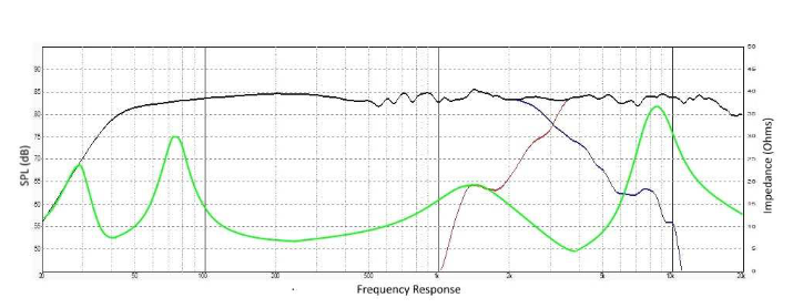

This is the crossover shown on the parts-express website. Very different from the diagram in the "manual" which you are showing.
https://www.parts-express.com/pedocs/specs/300-7140--c-note-crossover-with-frequency-response.pdf
Can't comment though if it is correct...

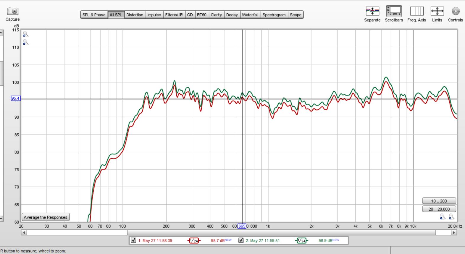

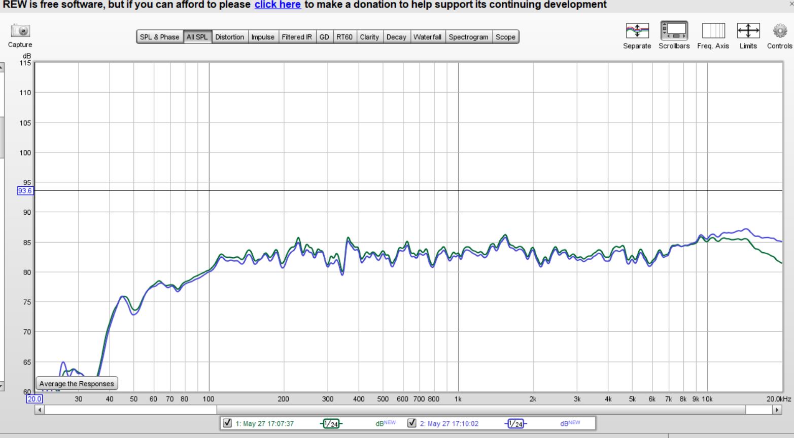

looks like the crossover is what is causing the rise, reproducible on all 3 fully assembled speakers
- xover measurements -
the below shows a full sweep assembled
sweep with just the mid bass (mb)
sweep with just the tweeter (tw)
- no xover -
just the tweeter
- no xover -
just the tweeter
