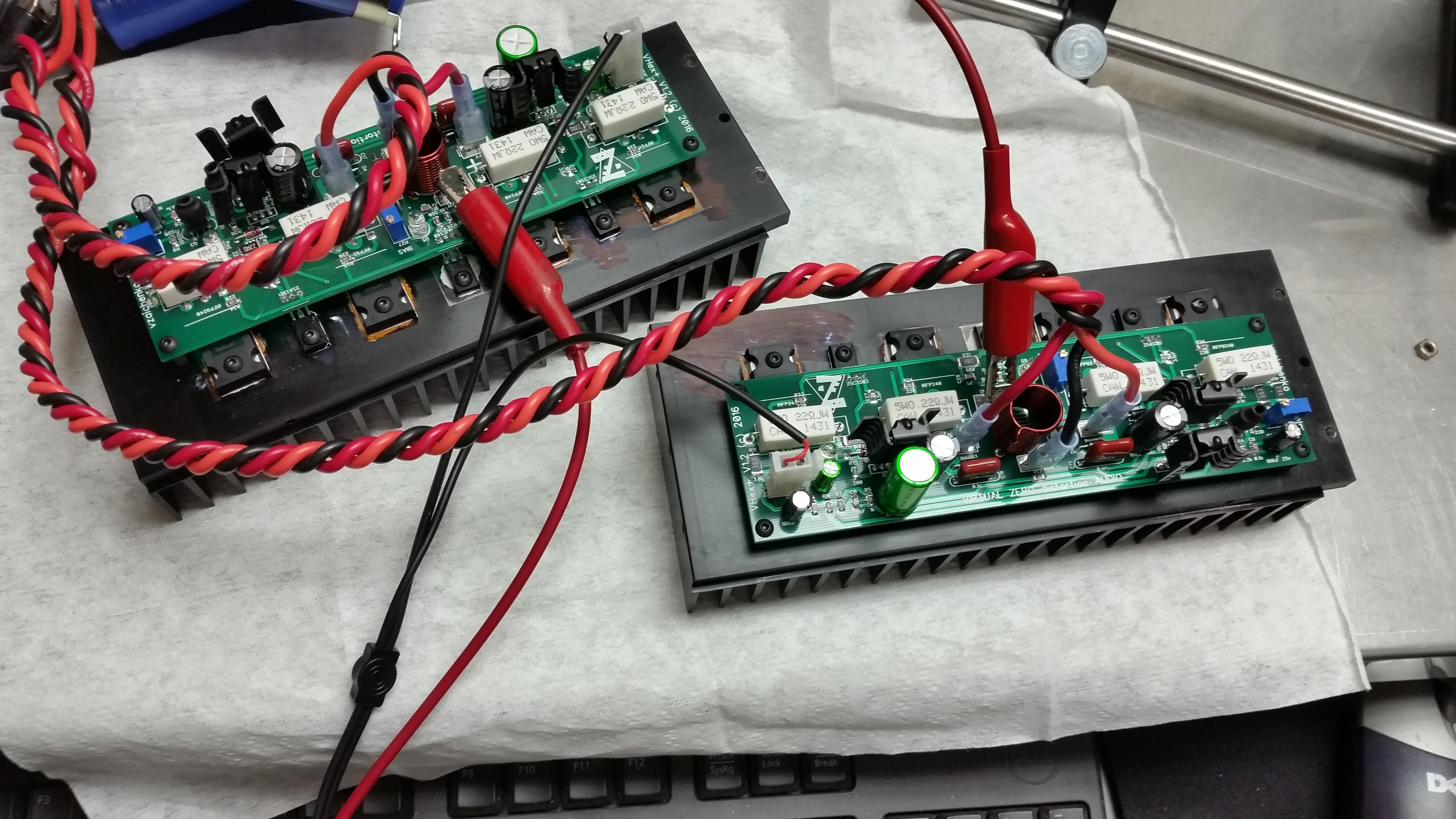

I think your application may require an amp design with at least two in parallel to handle that current and that power.
The vHex amp from vzaichenko and Jwilhelm uses 2ea and does 150w I think.
http://www.diyaudio.com/forums/soli...-amplifier-simulated-tina-24.html#post4687317
