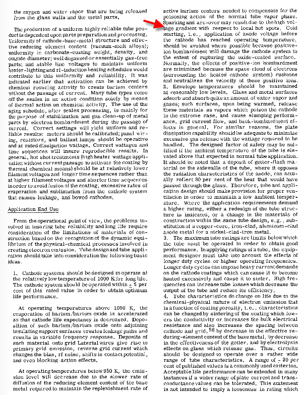

An easy going but excellent introduction to getters can be found in RCA (1963) Electron Tube Design, p519 onwards.
Technical books online

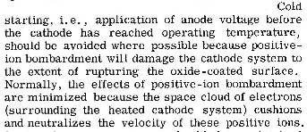

Page 67:
Can you double check that page number? I don't see that quote.Page 67:
It's on page 67 in this edition: https://archive.org/details/ElectronTubeDesign
In another PDF it's on page 59.

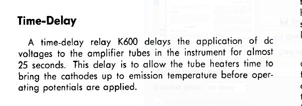

Well, Tektronix chose to preheat, in their instruments.
If in doubt, one could do worse than follow such masters.

Extract from the Tek 551 manual:

An interesting example.
The Tek 551 uses solid state rectifiers and is one of the first American professional high grade instruments to do so. In early production, the delay relay K600 controls slave realy K601, which holds off HT to some but not all the multiple HT rails in this oscilloscope.
It has another, more critical function: The regulator for the +100V rail uses the -150V rail as a reference. If the -150V rail has zero output, the +100V rail must also have zero output. Relay K601 temporarily connects a 500 ohm resistor around the +100V regulator triode, thus causing the +100V rail to have some unregulated output until the -150V rail has stabilised.
In other models designed later, when experience had shown that delaying HT to tubes is not a problem, no delay relay was used.

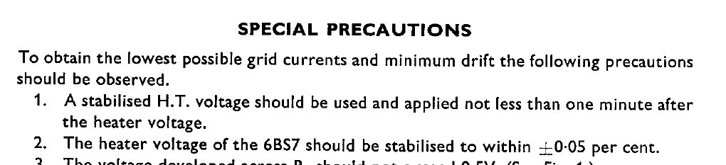

Van de Weijer's advice corresponds exactly to the precautions given by the UK firm Brimar, in an application of their 6BS7 for electrometer applications (ie when lowest grid current is the main objective). In this case, preheating - for one minute is mandatory.
