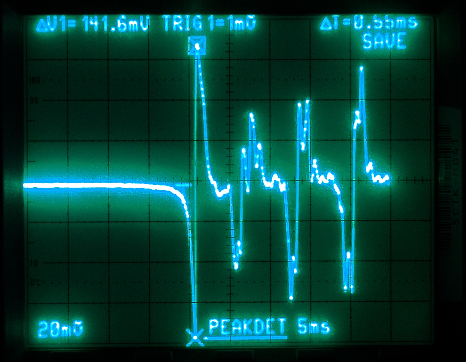

A guitar can put out signals over 1 volt peak to peak. Over 10 years ago there was a thread in these forums, the Hundred Buck Amp Challenge which is now a sticky at the top here. People were asked to design a guitar amp with a total parts cost under $100. Some of the participants had never made a guitar amp before and therefore inquired about the signal levels that come from an electric guitar. I took every guitar I have, put a scope across its output and blasted away on the strings. Here is a scope shot of a single note on the hottest guitar I have, an old Guild with Dimarzio pickups. The scope has a non Tektronix 10X probe on it which the Tek scope did not detect so the actual signal level is over 1.4 volts peak to peak. Blasting out some 6 note chords pushed the output to about 2 volts peak to peak but the scope would not trigger on 6 note chords so I could not get a picture.
If you play anything more than simple quiet notes you will need some compression or signal limiting between the pickup and recorder.
