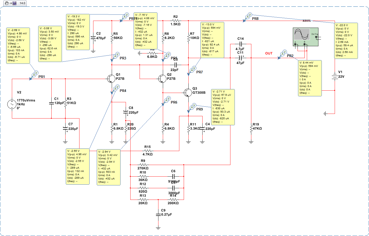

The original comment about low noise of the AF379 completely ignores the flicker-noise knee frequency - 600MHz capable RF transistors' noise specs seldom give this, and typically noise increases with decreasing frequency, sometimes dramatically, you cannot infer audio noise performance from RF noise performance - you'd have to measure it rather than extrapolate from 100MHz data.
About AF379 LF noise, is entirely true that one needs to test it first... I remember using AF239 in some project and having more noise than eg. a 2SB486. The 2SB486 are made for low noise audio, not RF (of course... is a slow alloy junction transistor). And fortunately the cause are not RF oscillations; the AF don't oscillated in RF (sometimes RF oscillations are the noise culprit)
The russian P27 are made for LF applications in mind also.

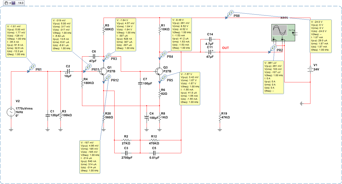

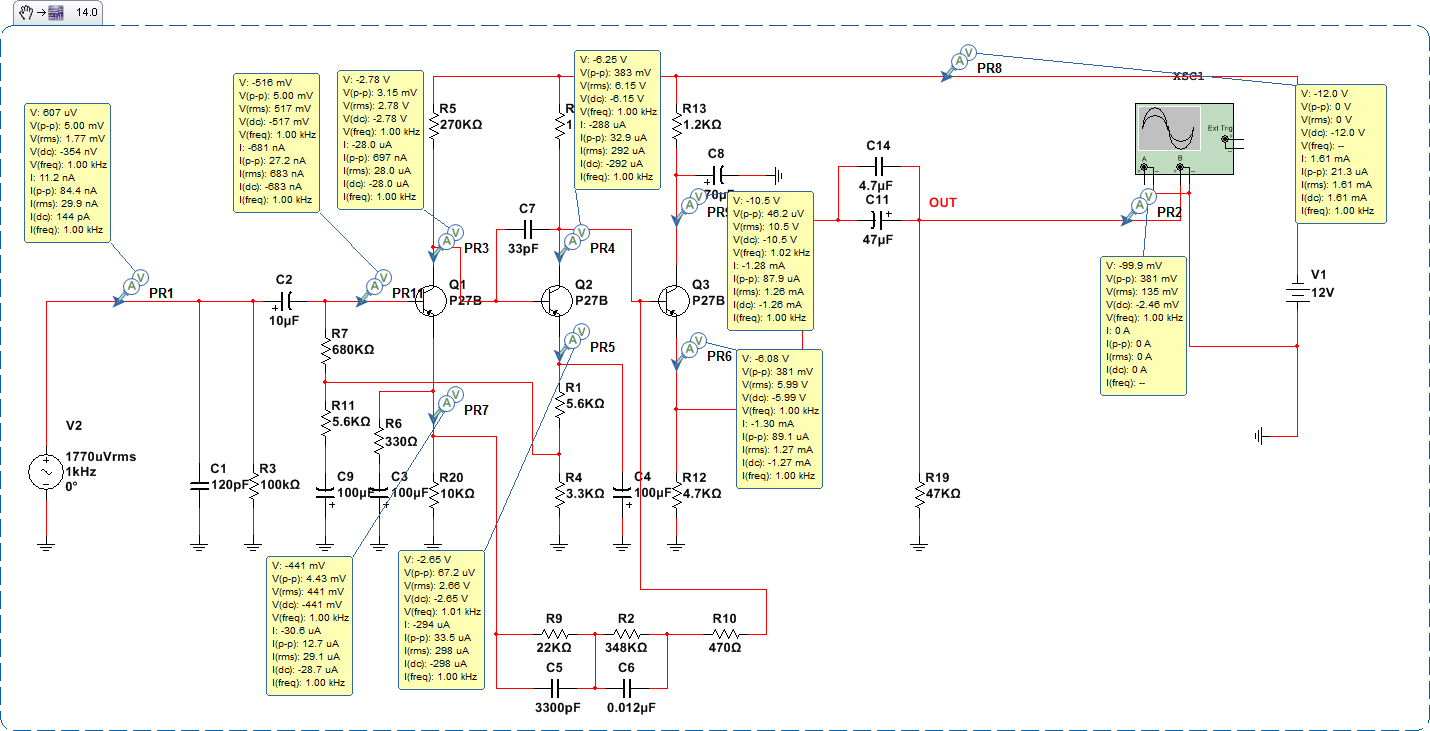

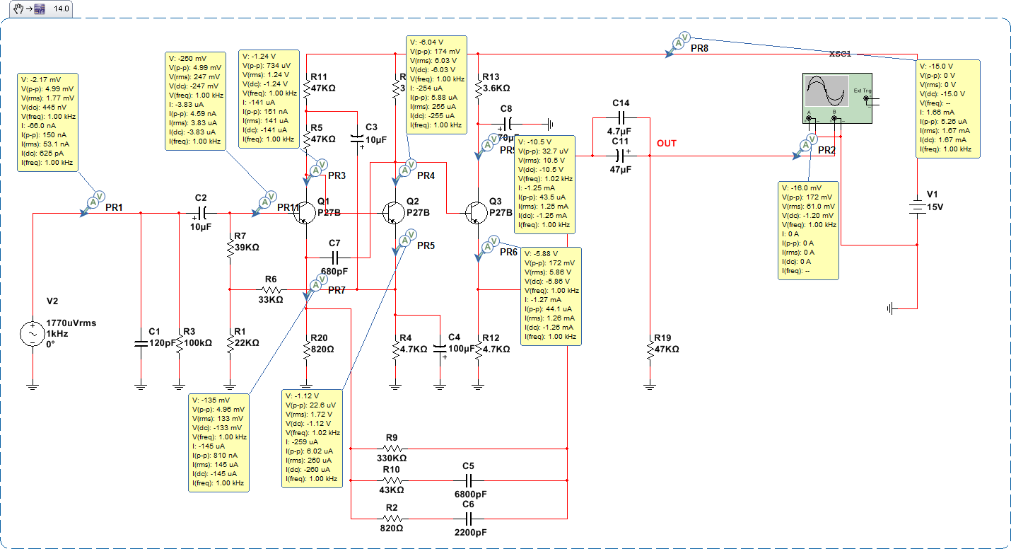

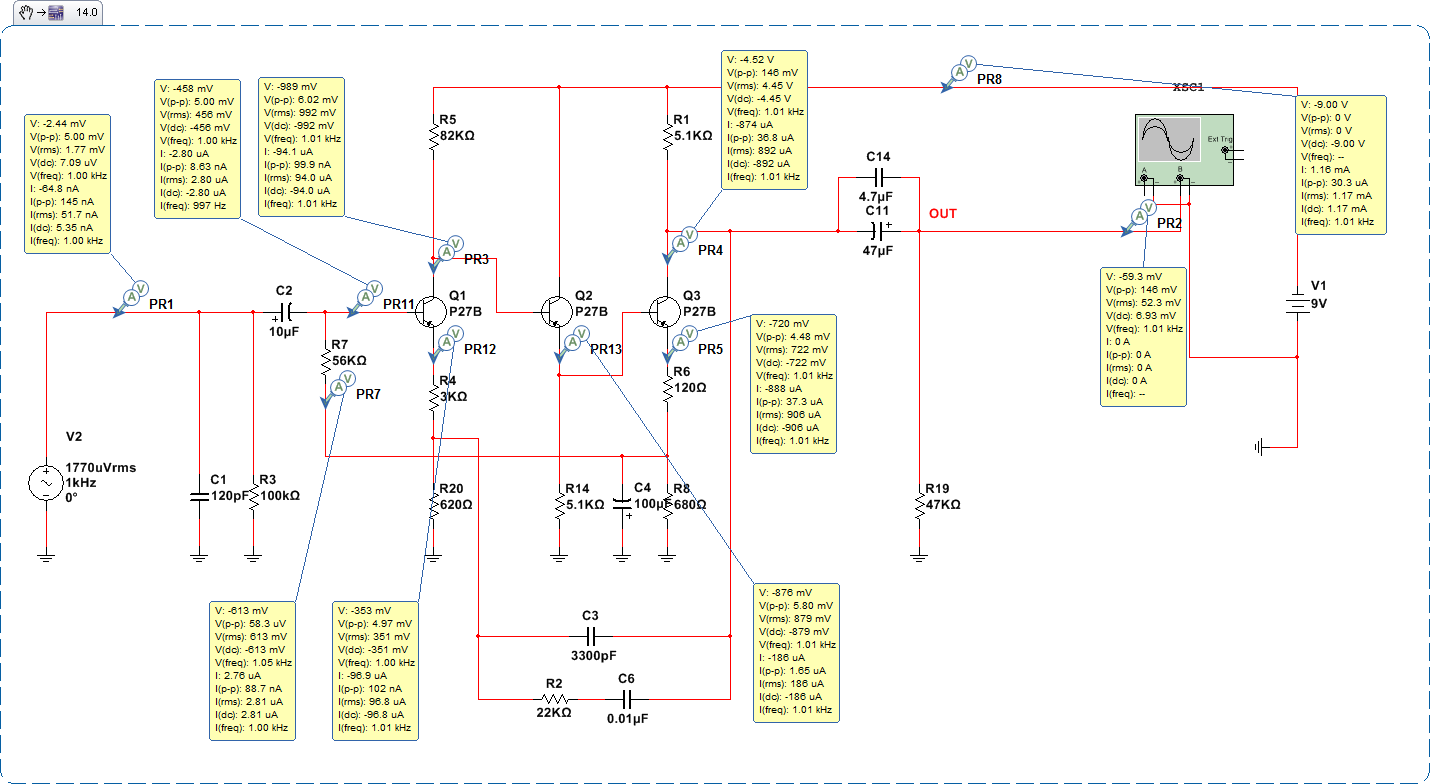

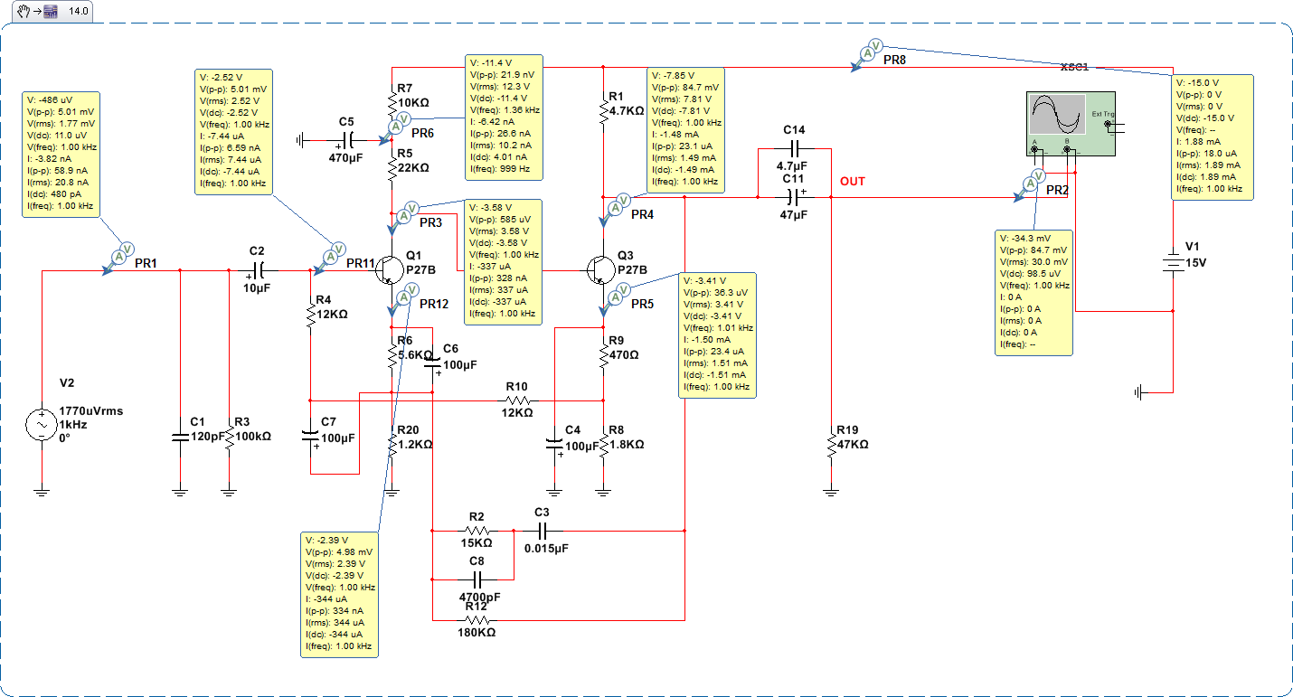

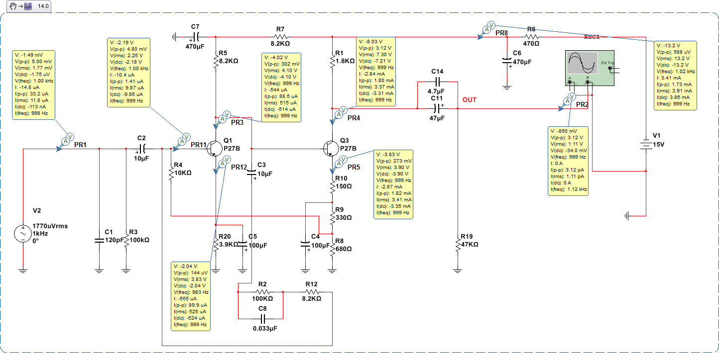

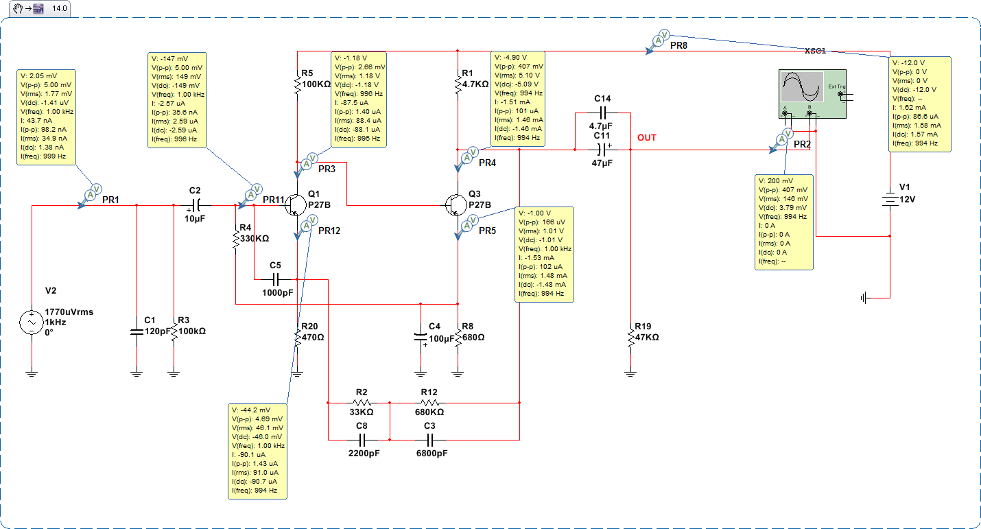

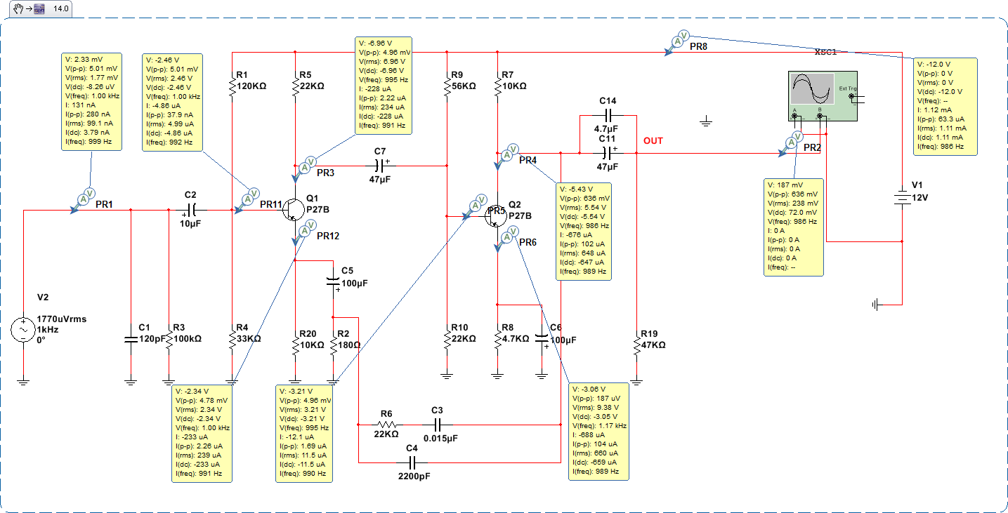

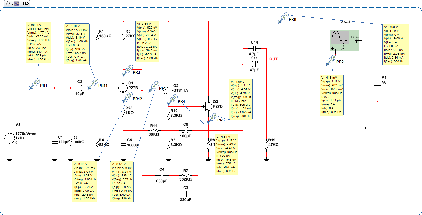

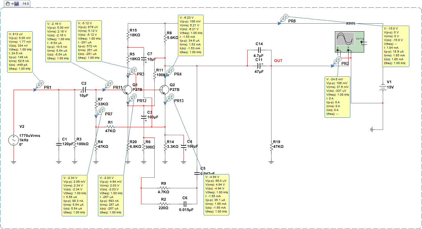

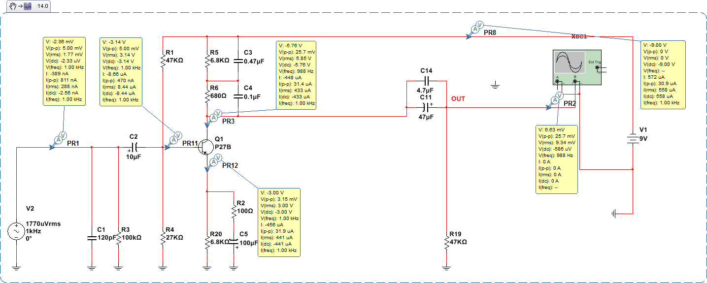

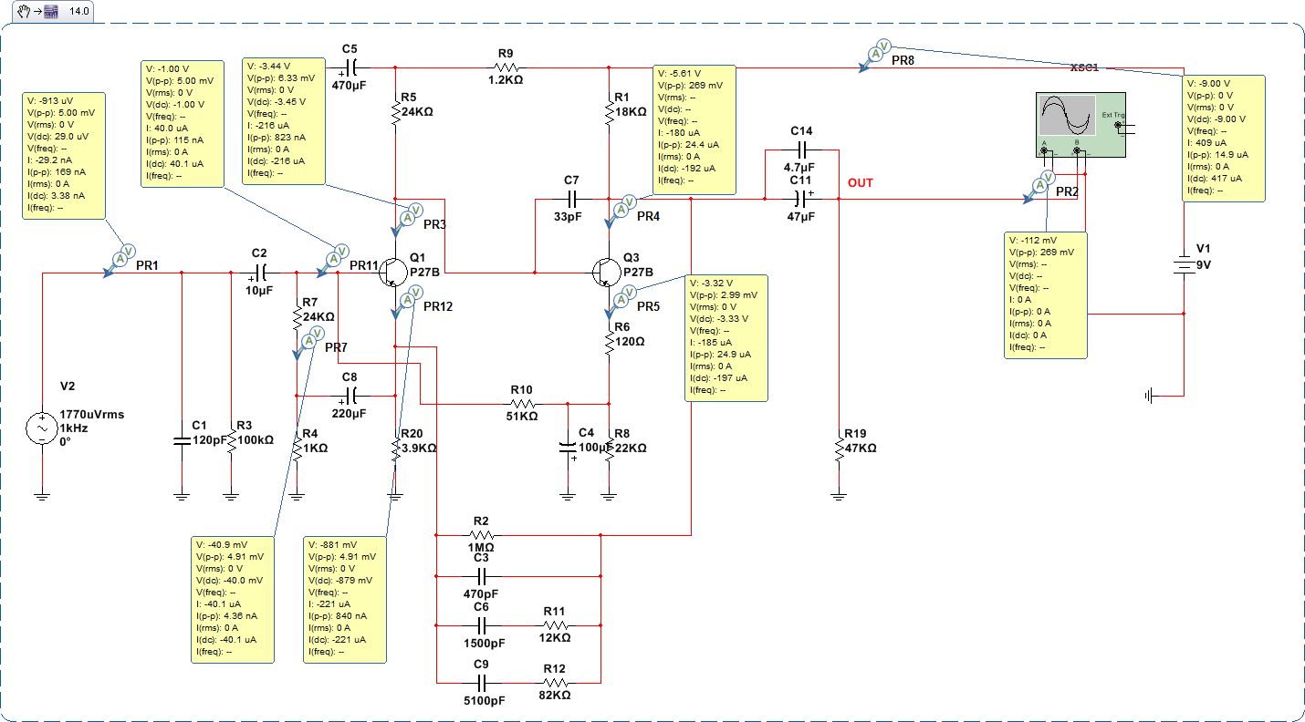

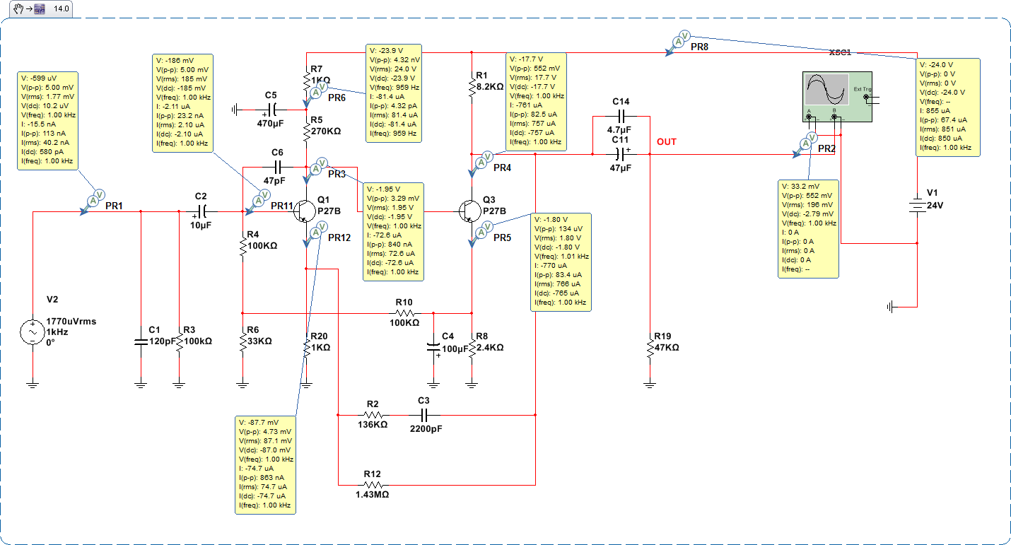

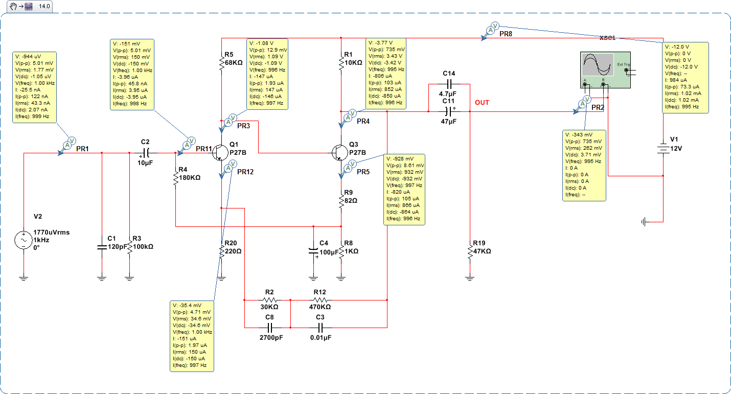

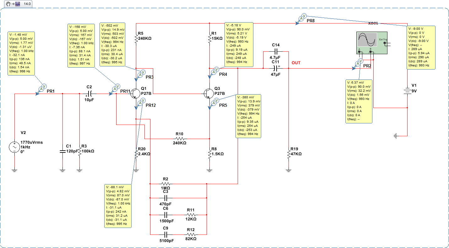

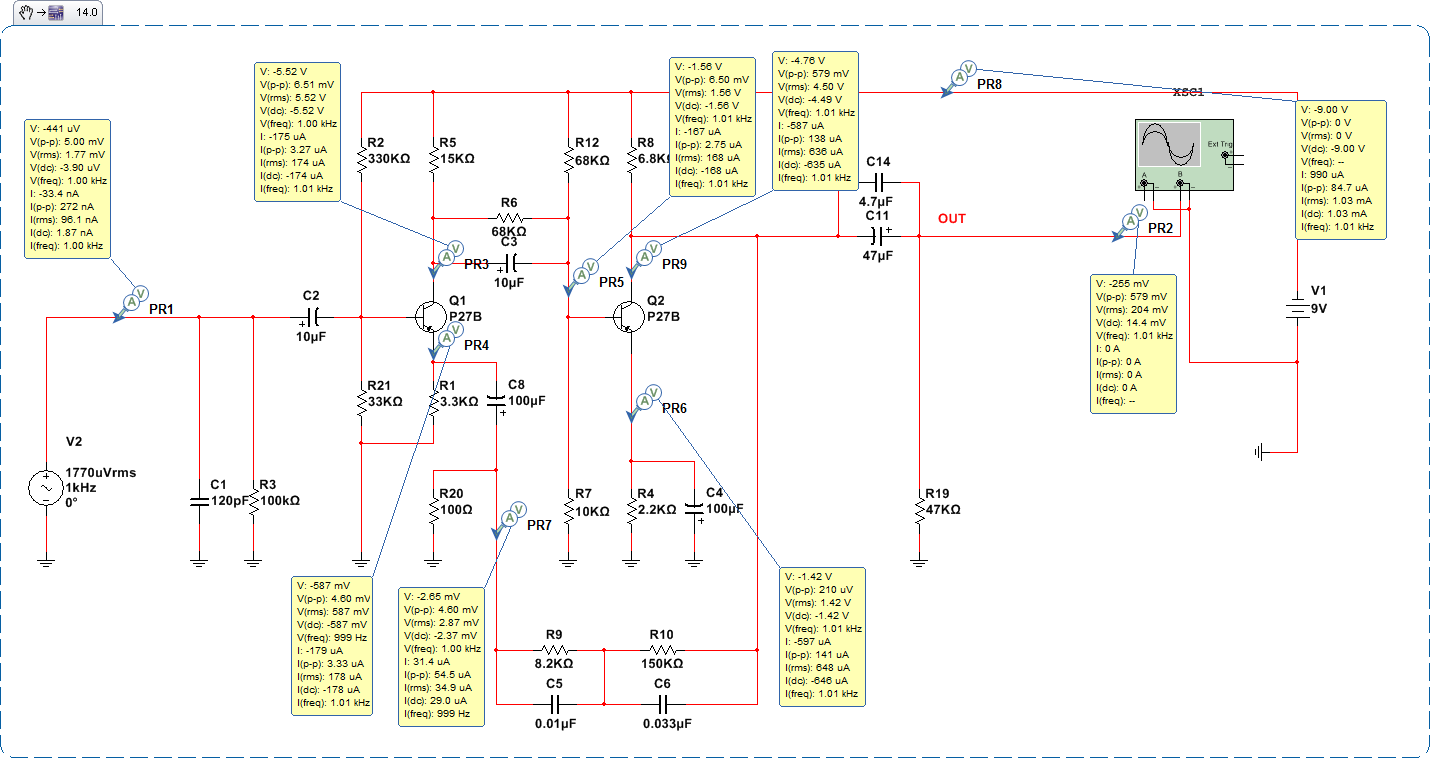

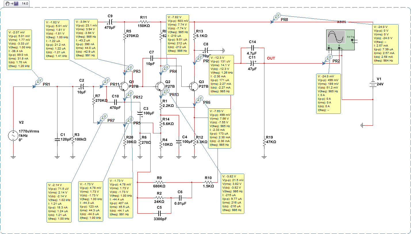

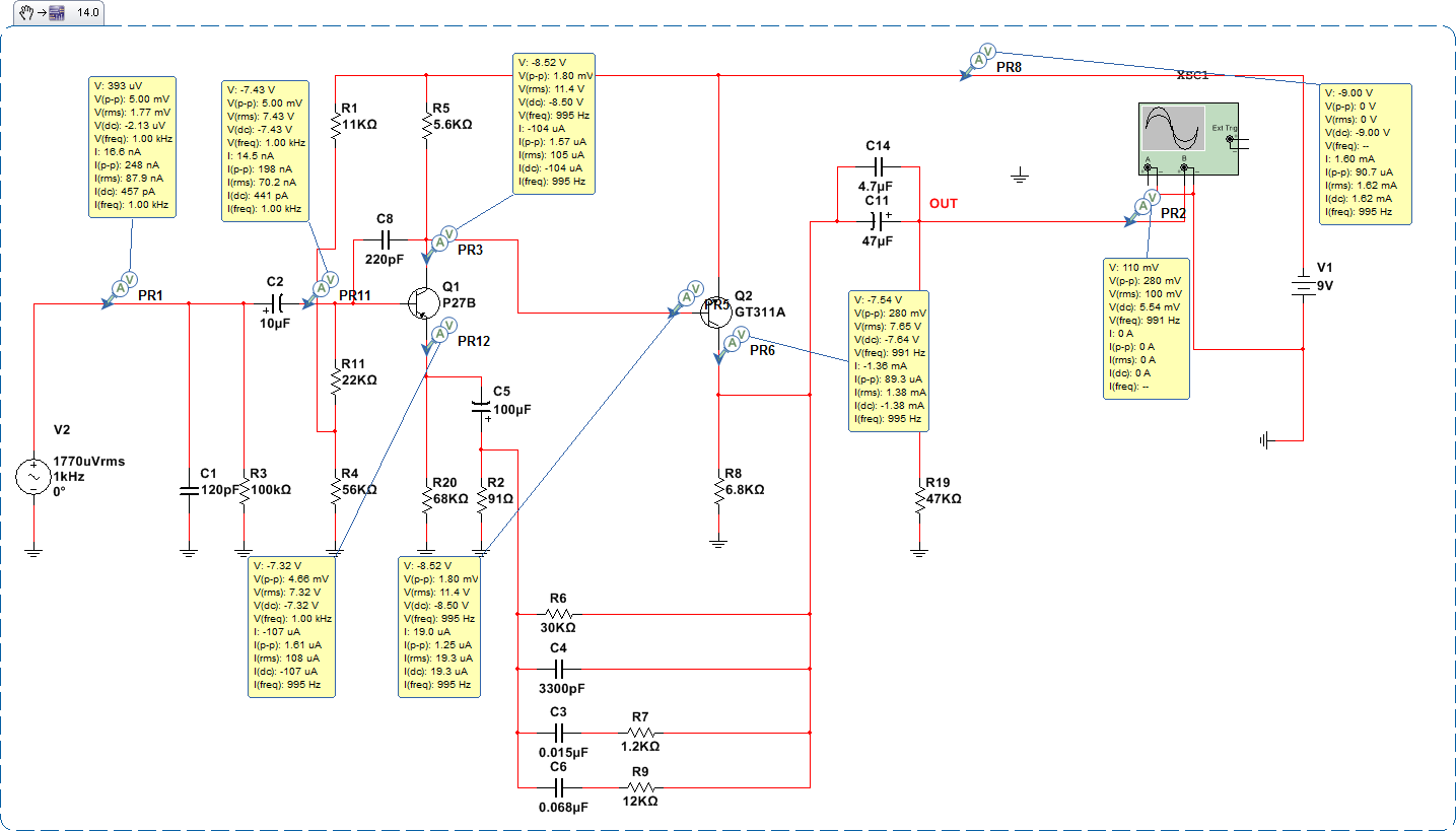

I'm thinking in purchasing some and build a pre like one show by Jenyok post #6, figure 5, but with cascode on second stage.
About using those parts in "2019" project... Let's see some:
1 - I love to experiment with challenging technologies far from mainstream. Silicon is boring to have good noise/HD results. I want to have it with Ge or tubes.
2 - Is fun, only for fun.
3 - some people have old cars, old houses; I have old electronic circuits.
4 - Not to mention the sound... sometimes a not so perfect project bring a good sonic result, as crazy as it seen from pure technical standpoint.
