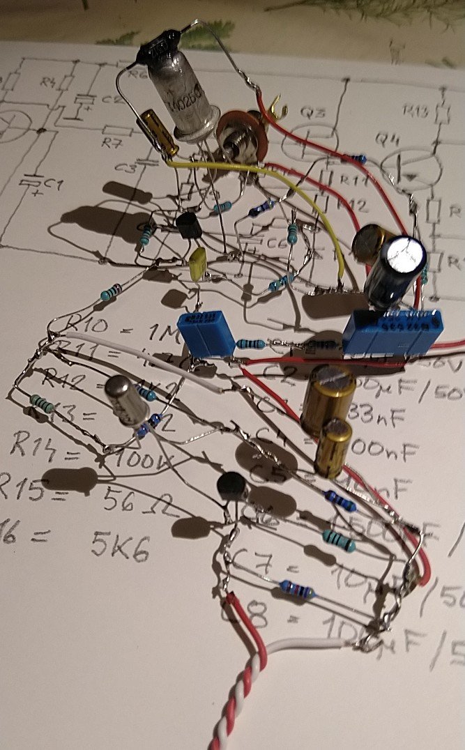

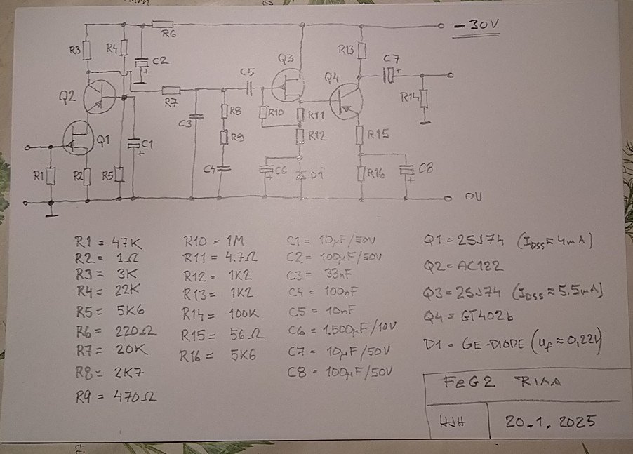

At message #630 I had one possible schema, but it have troubles when temperature changes and it always changes little or more. As you see Q4:s Vbe voltage biases also second P-jfet and fet's bias drift with temperature. With constant temperature this one works quite well.
So, here is the next try, to name it , it can be FeG2. This one is more a standard textbook solution.
And the protype looks like this. Diode D1 is qlued over Q4 and this is important for DC stability to keep these parts around same temperature.

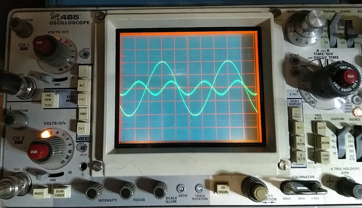

This really works, measured distortion is 0.35% at 5mV input. Gain is around 43dB. And it sounds good. Distortion is mainly second harmonic look the smaller trace here which is taken from distortion analyzers output. Max. input voltage is around 50mV and more voltage in makes output stage clip. Good enough from this simple design.
Many members seems to have new or almost new measuring equipment but these old work as well.
Drift changes only DC currents trough Q3 and Q4. Distortion must be same with emitter degeneration. Can affect clipping if temperature changes a lot, say 10 degrees of Celsius. In any case both circuits works quite well.
One circuit that I need to locate where I saved the schematic...

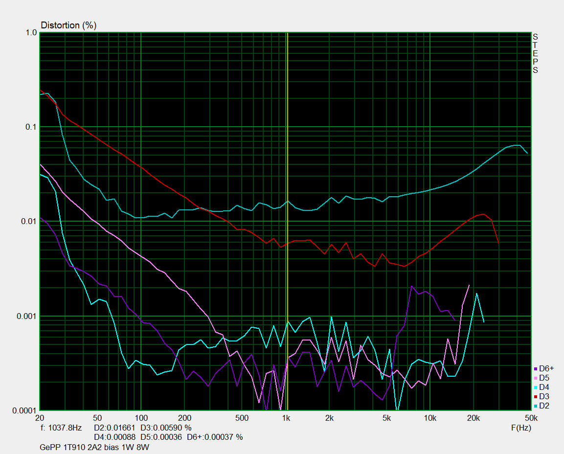

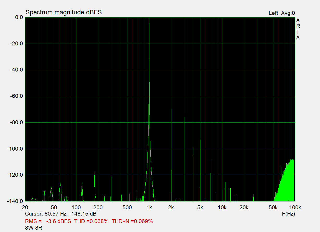

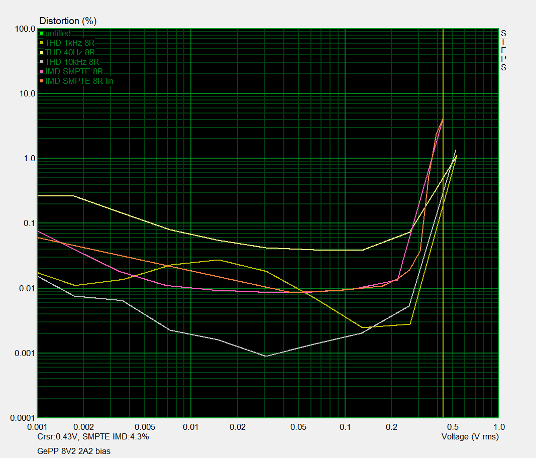

A amplifier I built 3 years ago, using output very much like the Susan Parker Zeus (output buffer), but using Ge transistors for the output: in this case, 1T905 and 1T910 forming a Ge darlington, with generous bias. In curve traces, it have very good low saturation voltage, excellent for low voltage projects. Like this: for my amp, the louspeakers are directly connected to emitters of the outputs (then, the output trafo is a CT choke). Then the PSU needs to have far lower voltage, due to brutal low impedance seen by the transistors (especially when enters the class B region). Only 9V for the +B; the CT choke makes it like almost 4 times it's value (like for every PP trafo amp). Driven by a 2P29P pentode input, CCS loaded, with a MOSFET follower using a 2SK216 for driving the interestage trafo. With that, I obtained the following measurement results:
Even with 8W, the distortion was lower than 0.07%, with 8R load. Without any global or interestage feedback (only the foloower action). With great harmonic content.

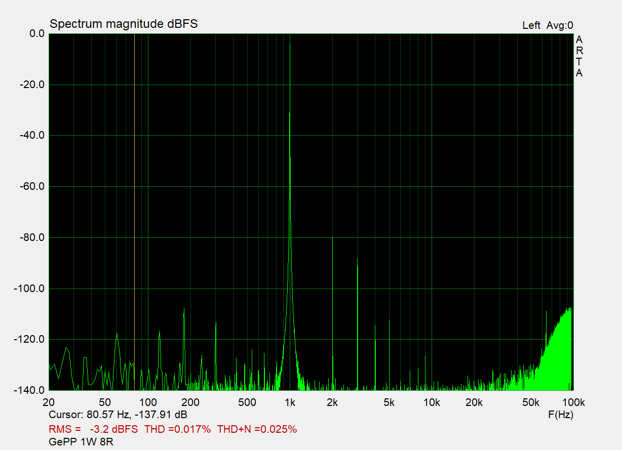

0.017% at 1W with excellent harmonic content.

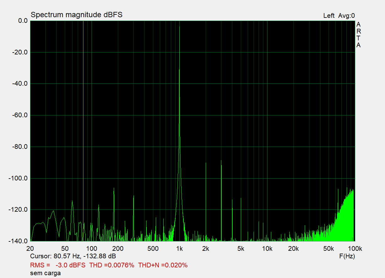

Without load:
Interesting, the output stage are holding of this own; not much changes with load at this point!
Of course, iron elevated HD at lower frequencies (due to finite impedance driving, more probably due to interestage). Only a little increase for the HF part due to trafos. NOTE: in fact, in the sweep measurements, the 20kHz HD is lower compared with lower frequencies.

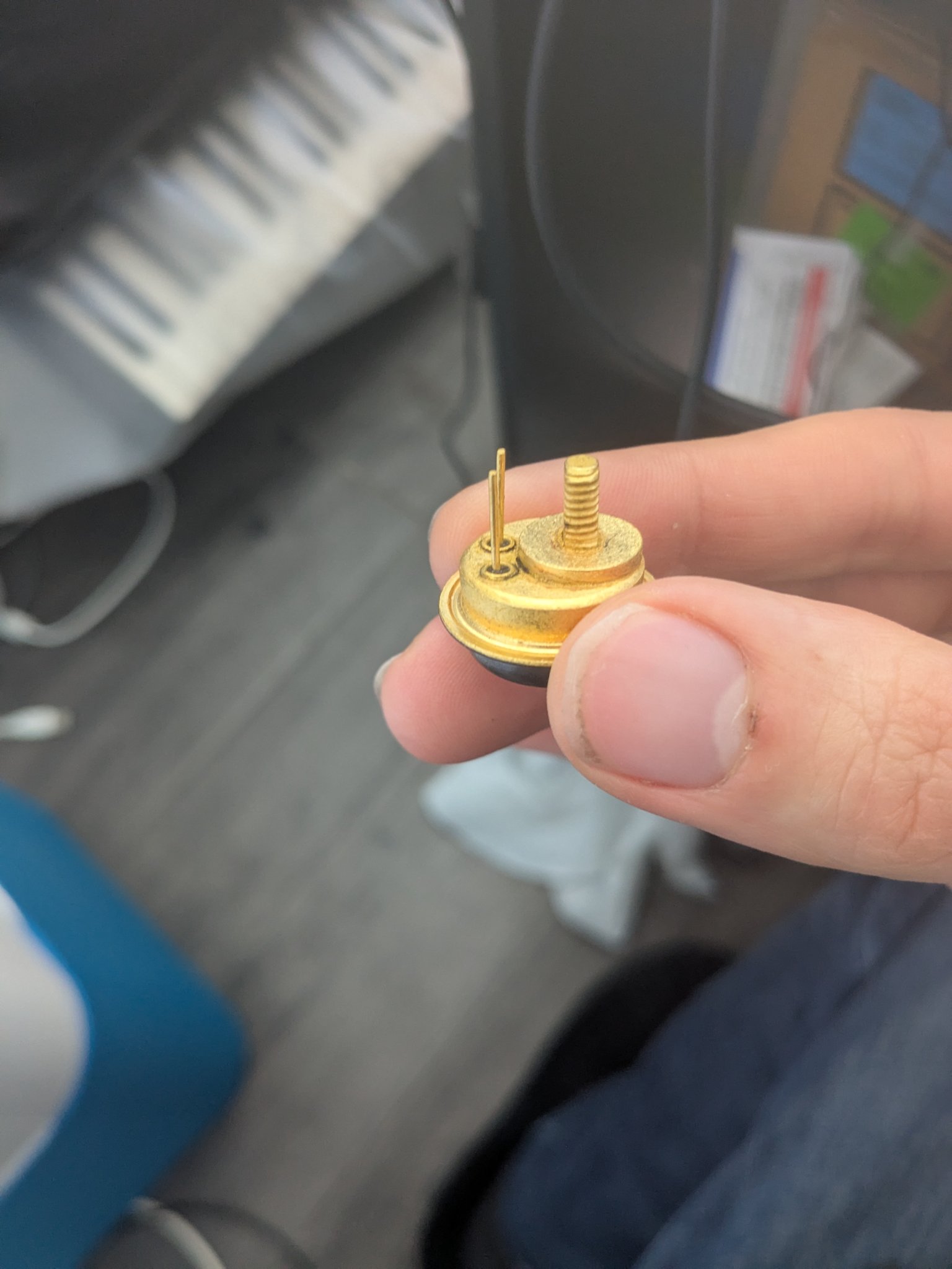

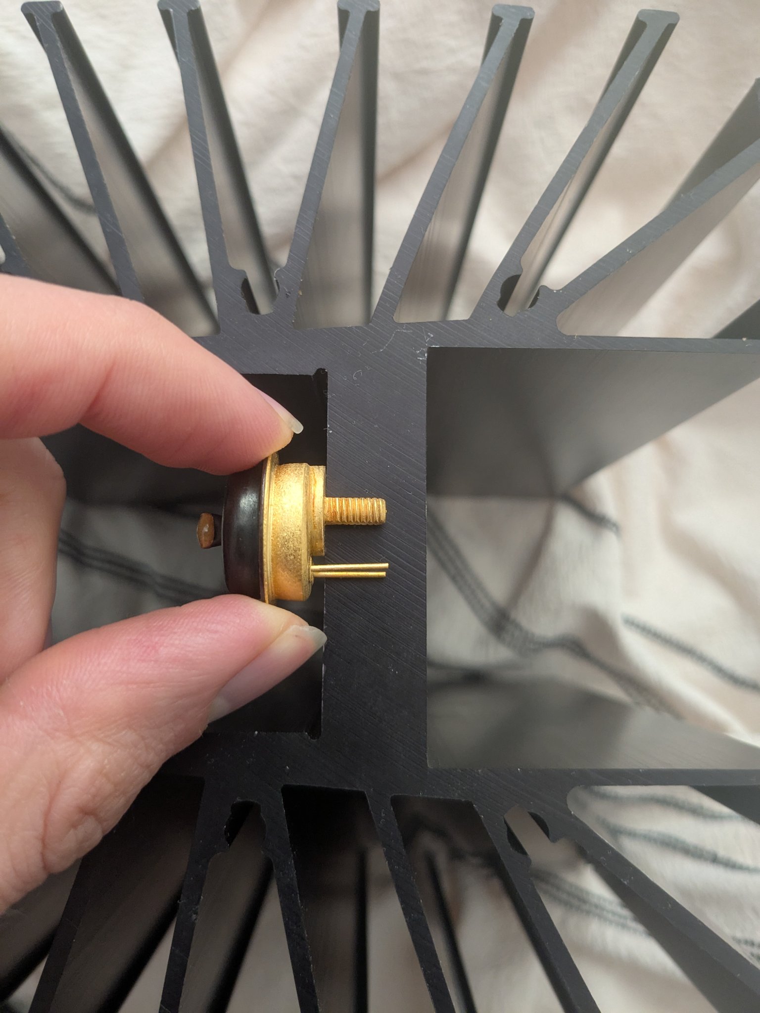

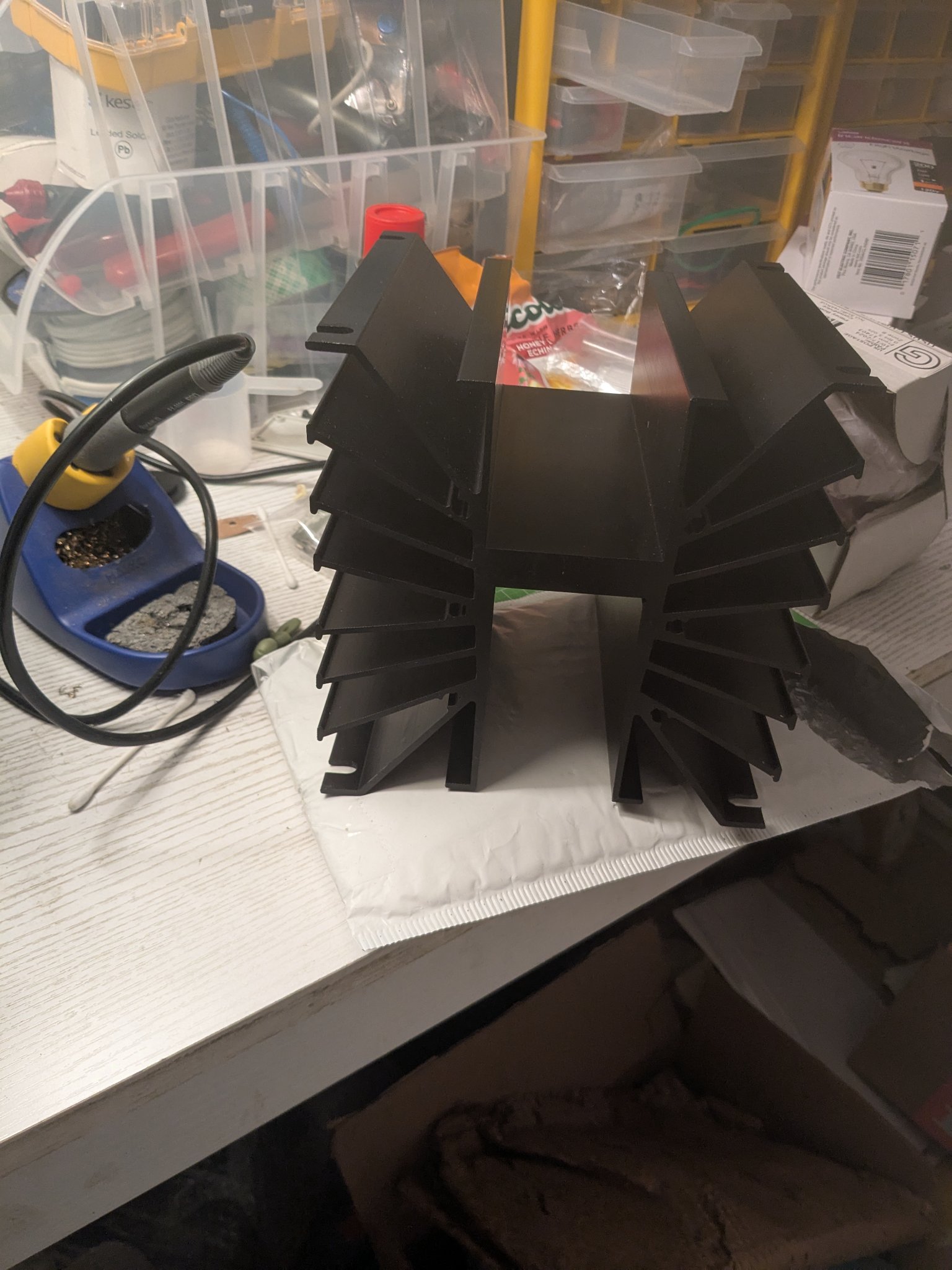

I had a bit of a basic question, but thought I'd ask those on the thread.
I have a quad of unmarked W.E. Ge power transistors, supposedly good for 50W dissipation at 25°C that I'm hoping to try in a simple Class A SE amp. (With choked collector or emitter)
Before I can try and make basic curves and see what I'm dealing with, I'm wondering about how to mount it to a heat sink.
Strangely, the collector thread has a ~1/16 inch raised "seat": it's not flush with the emitter/base leads. I can't understand why, as the smaller seat diameter is only ~45% of the larger dia.
I'm mostly wondering if the small 0.455" seat dia would be enough surface area to run the transistor at up to, say, 19W dissipation? (I have a 19V Mean Well, I figure 1A would be the max Ic I would aim for) I'm really trying to keep the device temperature as low as possible. (I saw that TO-220 parts might have a slightly smaller collector area, which gives me a little hope)
I have a large heatsink, but would need to drill clearance for the transistor to about half the depth of the mounting shelf (from bottom). I'm thinking this might result in less thermal resistance than using a separate (much thinner) spreading plate.
(I might even try mount a 2nd transistor and try PP)
Appreciate any pointers anyone can give.

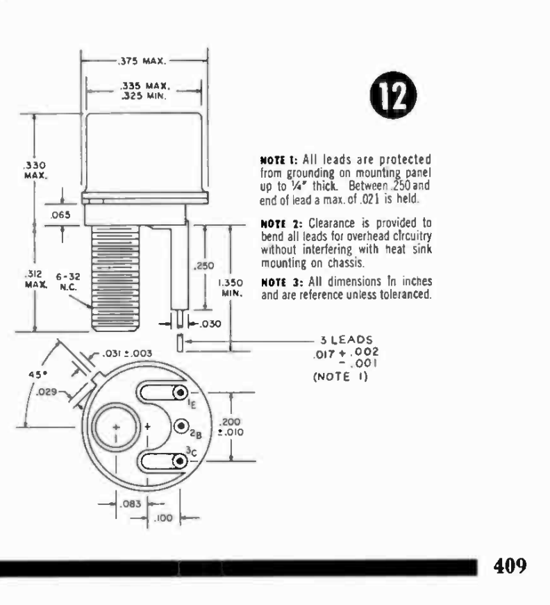

This case looks similar, doesn't it ?
Pretty similar, yes - though that example seems to have the base/emitter leads at the same level as the collector - unlike mine, unfortunately.
they were not rated for very high DC voltage,
The person I picked them up from mentioned seeing ratings of 50 or 60VDC max, but that's the extent of the info I have. Hopefully they'd make for an interesting experiment.
Well, do initial experiments below 20 VDC. Then maybe measure leakage current and increase C-E voltage until it starts to come up. It would be a shame to kill them unnecessarily before you can have fun with them.

With a low noise fan you can achieve good dissipation. Without any fan, will be difficult to maintain low junction temperature and operation suffers.
Reactions: jt23
All I'll add is that all semiconductors are heat sensitive. Germanium is more so. So whatever you do, keep them as cool as you possible can. I wouldn't push them, they will fail sooner even it it works. If you look at older equipment using Germanium power transistors you will see the heat sinks are larger than units using silicon transistors. There is a hint in there.
You will see more class A designs with germanium parts. That is simply because engineering thinking was still mostly tube based. We were still learning how to use semiconductors. Designs shifted as we learned, silicon simply came along during that process, plus they were cheaper and more reliable. Aside from higher beta, Germanium devices offered no advantages over silicon. So treat them gently, they are not as rugged as the parts we are used to using today.
