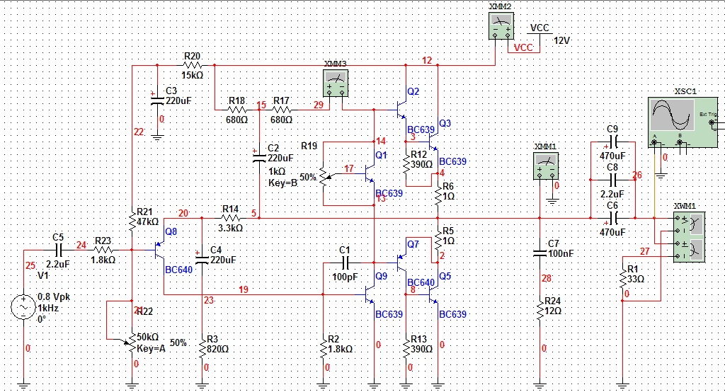

The last pic that elvee posted is the way i always connect a quasi complimentary output stage. I have seen power transistors explode when connected any other way. The actual output transistor (when connected as elvee shows) is in a local feedback loop created by the driver, the whole thing is under much better control 🙂
I did some simulations connecting the emitter resistor to the collector of the sziklai pair like elvee did it, and you guys where right the distortion went from
0.0780226% to 0.0338128% at 277MW in 33 Ohm
so i stand corrected (hope this is the correct phrase).
Thanks guys 🙂
Here the new schematic

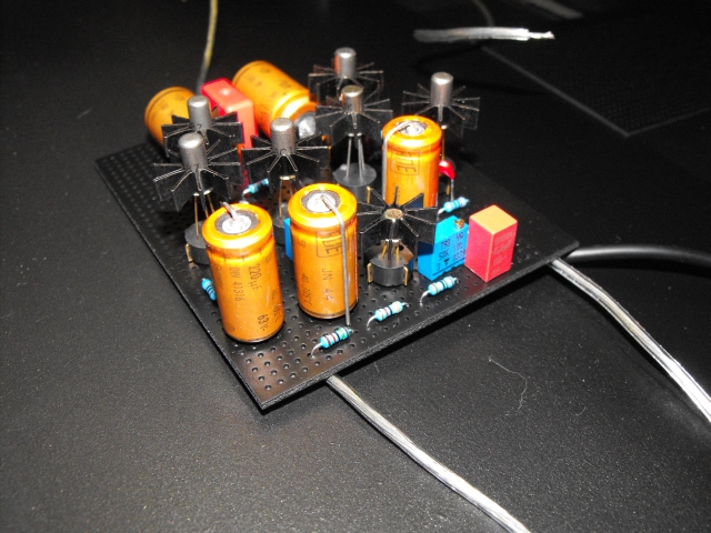

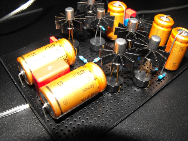

Here some pics
Nice job Captain. It takes me back 25 or 30 years....
Some ideas for further improvements:
Only Q3 and Q5 require a heatsink, and there is still room enough at the top of the case to attach a second cooling clip.
Q1 should preferably be in thermal contact with Q3 and Q5, or alternatively with Q3 or Q5.
When electrolytics stand on their positive end, there is no risk of short-circuit between the positive wire and the can.
A regulated supply will bring little improvement, if any, and if it is not perfect, it might even make things worse. A big fat filter cap is all that is needed.

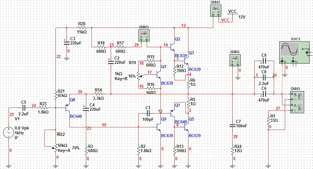

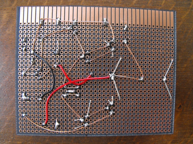

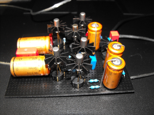

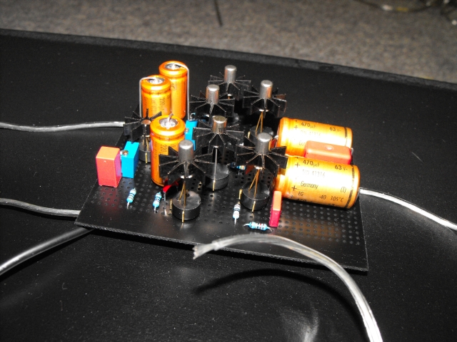

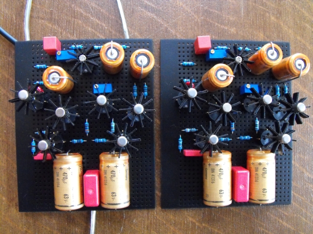

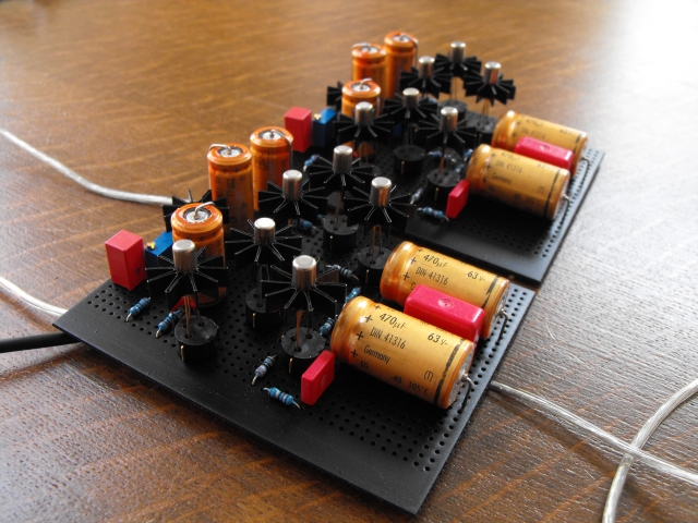

Final
Final schematic and second channel
Everything works fine🙂
it sounds very soft.
I have heard many headphone amps in my life (worked in a theatre) and this one sounds so soft it is almost like the ultimate wooly warm sound.
No hiss or hum problems at all (even with germanium transistors)
well overall gain is exactly 4 so i didnt expect much instability.
it doesnt oscillate at any sircumstances.
and there is lots of power here DAMN!!!!!😱
pics below
