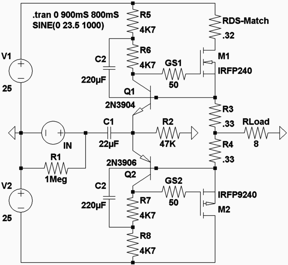

Germanium transistors still have utility as comparators, especially
so when needing to control a MOSFET current source with very
low dropout. Its Nelson Pass' Aleph pair I'm suggesting you use...
I am fortunate to have a few hand matched complimentary pairs
of small signal germanium transistors. I've had a long time to think
on how best to abuse them.
Obviously, you switch from Silicon to Germanium, the Voltage gap
is less wide. Bias resistors in this style output totem scale smaller.
This diagram is an oversimplified unity gain follower. And does not
show the proper bias for germanium transistors, but gets the point
across about how this pairing might work.
The MOSFET gate tends to an equilibrium near its threshold. And
this protects the Germanium collector from seeing too many Volts.
Its a win-win for both components.
You might wanna throw a Schottky across each emitter backwards.
Just so's there's no possibility to reverse bias the germanium emitter
into breakdown. That ruins Silicon, I don't know bout Germanium...
And then a Zenier to further protect both the gate and collector.
If something goes wrong, no reason to risk exploding rare antiques.

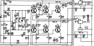

There is one advantage I came to think of actually, and it is that the germanium trannies are much slower so you might not need to much freq compensation to make it stable.
Back in the sixties and early seventies, when cheap small signal silicon were available, but higher power devices were rare and expensive, most amplifier had a quasi complementary output using Ge power transistors.
Pick any 15~~30W design from that time, it will most likely use that configuration.

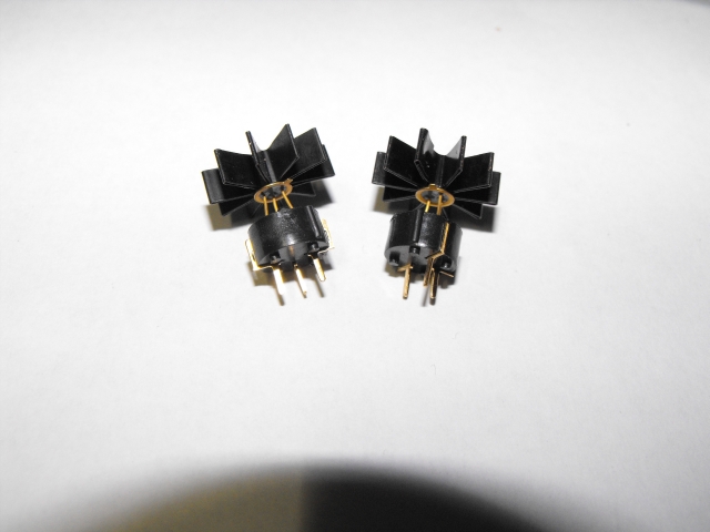

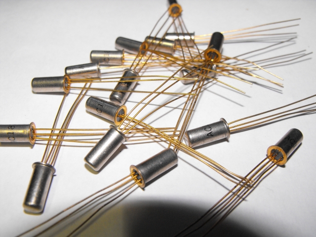

Well the story is i have about 30 ac187 transistors wich are NpN germanium transistors rated at 1w power dissipation with a Hfe of 300 or so.
And i want to build a headphone amp with these devices in the output
and to make a quasi output configuration (so 2 NpN output devices) i can of course use the same AC187 to make a full germanium darlington for the positive side of the class AB follower but for the negative part i could use a germanium PnP transistor as driver, but i was just wondering if it is even possible to use a BC179 PnP (for example) silicon transistor in sziklai combination with a AC187.
Note: i will use 2 NpN transistors in the output since i have so many of them and i already matched these devices in Hfe.
And these AC187 transistors will also be used for the VAS stage and VBE multiplier in the bias circuit.
So maybe somebody knows if this is possible

Well these are military spec AC187 (gold pin) and the lowest one had an hfe of 117 and the highest was 387 these are accurate measurements.
I did these measurements with highly precise Philips measurement equipment and i did not beleave it myself either at first.
until i checked these measurements with normal modern silicon transistors, and the measurement equipment was accurate.
I know that an average germanium transistor has an hfe between 30 and 100 or so.
But according the datasheets these AC187 transistors should have an hfe between 100 and 500 so this is normal for these types.
But could someone specify if this configuration is possible??

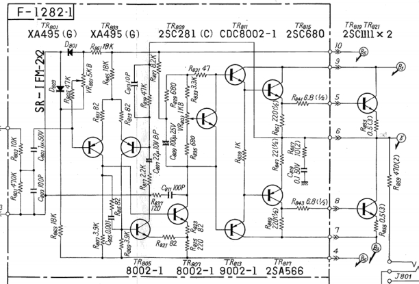

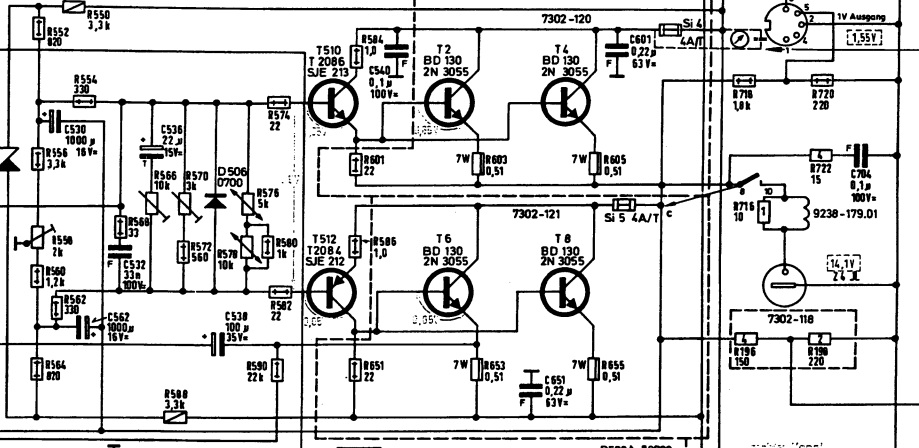

At this moment I am looking at a 35 ish year old Goodmans 3000 receiver this uses Silicon drivers with Germanium output devices in a quasi complimentary output stage this stilll works very well
Also around 1972 i seem to remember a hifi news article for an amplifier with Silicon Drivers and Germanium outputs

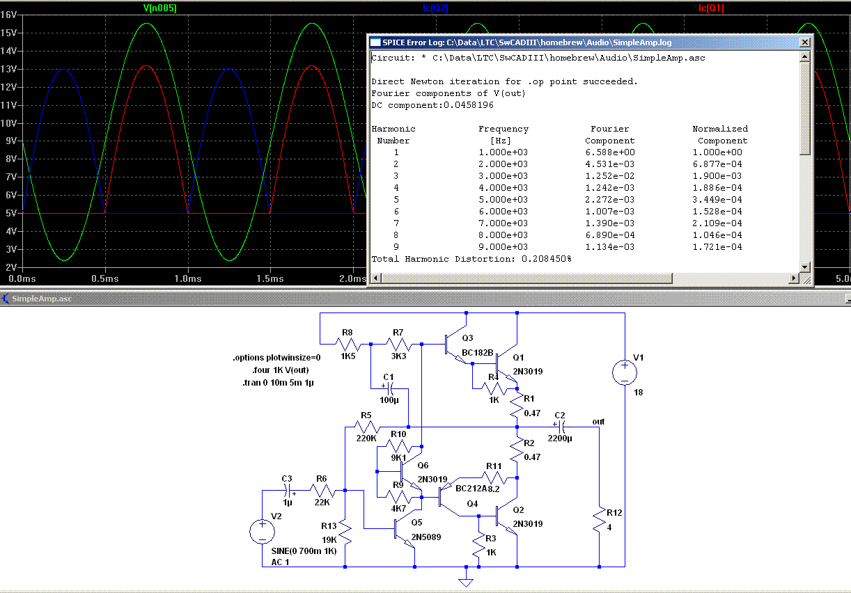

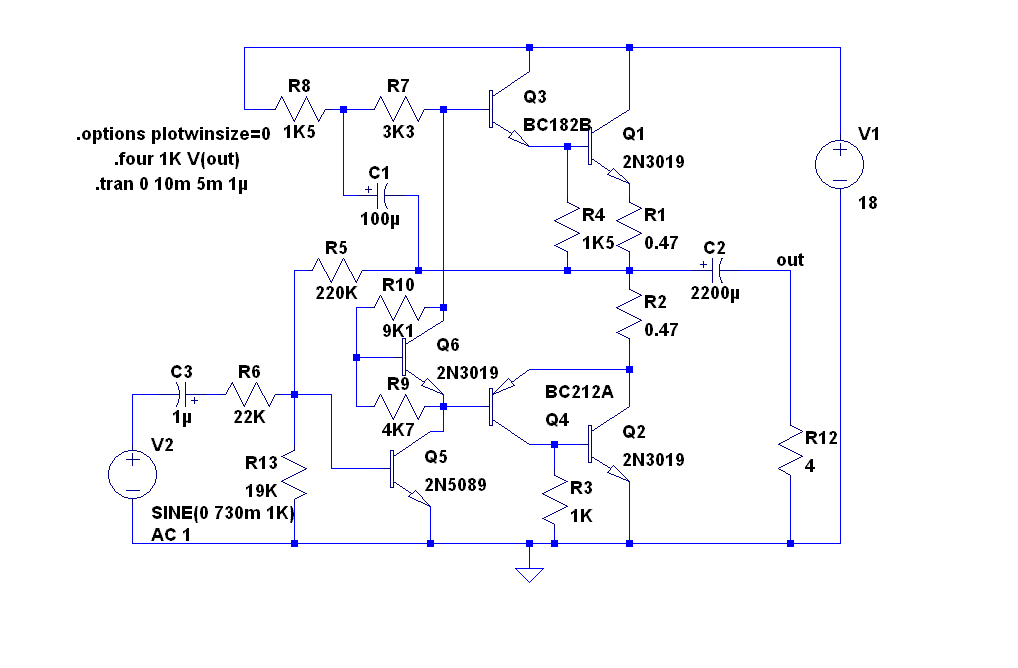

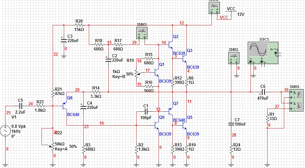

You can use a classical amp schematic like this one.
Only minor adaptations in the resistors values are required to make it operate with germaniums:
You can replace Q1, Q2 and Q6 with your AC187s (all attached to the heatsink).
R10 will have to be increased to get a proper quiescent current, say 10mA.
You can use a fixed 10K in series with a 22K adjustable.
Be sure that the adjustable is set at 0 ohm before you power up!
With no signal, you increase slowly the resistance until you get 5mV DC across R1.
R13 has to be adjusted according to the power supply voltage. You can also use a fixed 10K + 22K adj.
It has to be adjusted so that the (+) of C2 sits exactly at half the power supply voltage (9V in this case).
With the indicated values, the amplifier is theoretically capable of giving 6W into 4ohm (@ 0.30% THD).
Probably a bit over the top for the AC187s.
Other transistors can be any small signal silicons.
Yes i already designed a circuit myself in multisim before. (see the picture)
But i only needed to know if the silicon germanium comination was possible.
Note that the transistors in the circuit are not the correct types this will be the AC187 transistors of course.
and the first pnp transistor will be a BC179b and i allready found goog PnP Germanium transistors so the output stage will be fully germanium now

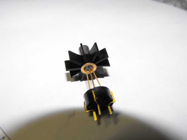

But thanks guys, i also attached some pictures of the devices
Good old stuff right???
If you use all germanium transistors (the input transistor doesnt matter), your schematic should work without modification other than mere adjustment.
Ps
You should put the lower 1ohm resistor the same way I did on my schematic.
Ps
In the case of the Grundig, it is understandable, because they have a balancing role for the two transistors in //.
But in the case of the Sansui, the lower one is practically useless from a T° stabilization perspective.
One might argue that it helps symetrizing the output stage, but this kind of quasi is hopelessely asymetrical anyway, and the effect of the resistor is marginal.
PS
And in fact, placing the resistor there destroys the symetry of the global, composite transistor, which is much worse: I just checked on my sim, when i put the resistor in series with Q2, the 2nd harmonic distorsion shoots from 0.17% to 0.61%.
This settles the case.
If you can measure distorsion on your simulator, you can try both options.
PS
