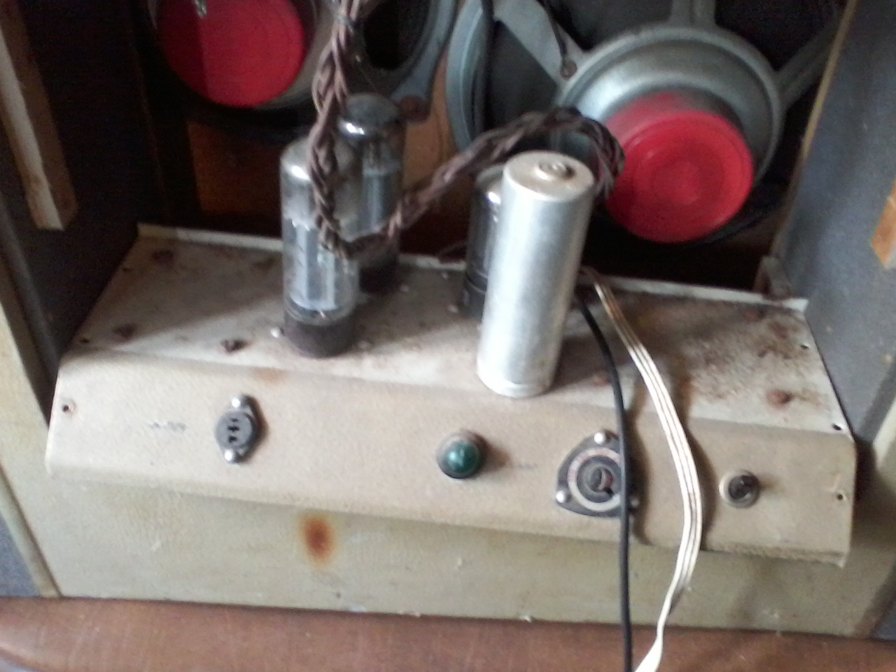

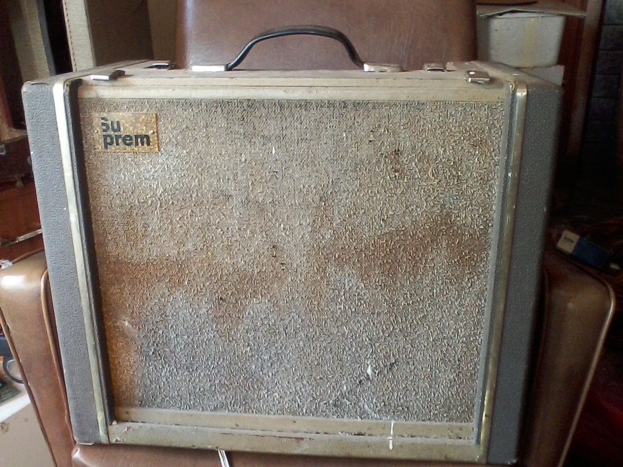

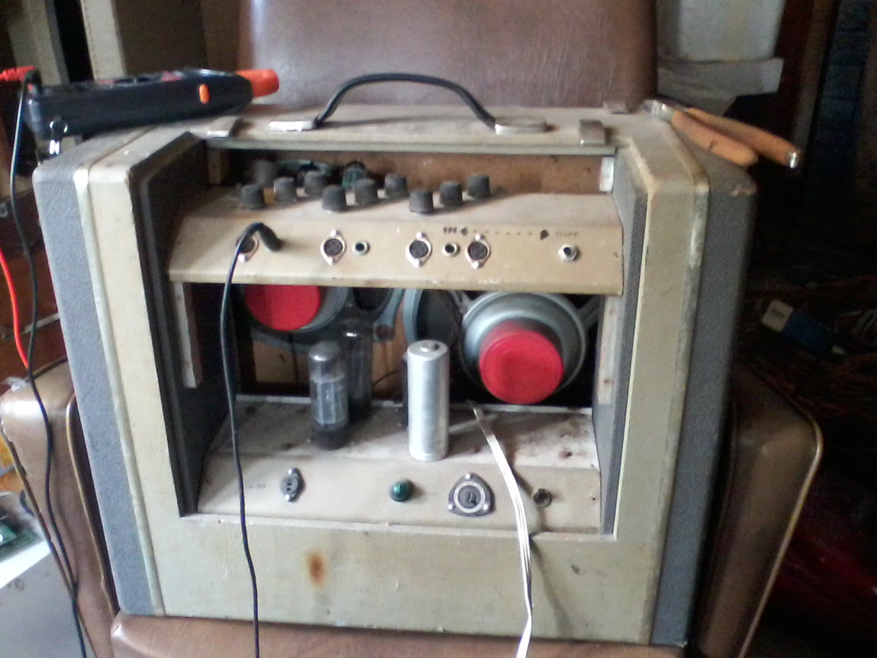

been given this amp to fix/restore braned on front as "SU PREM" telefunken and siemens valves + speakers made in Dortmund. power amp has El34's push pull superlinener i think, this bit works ok.

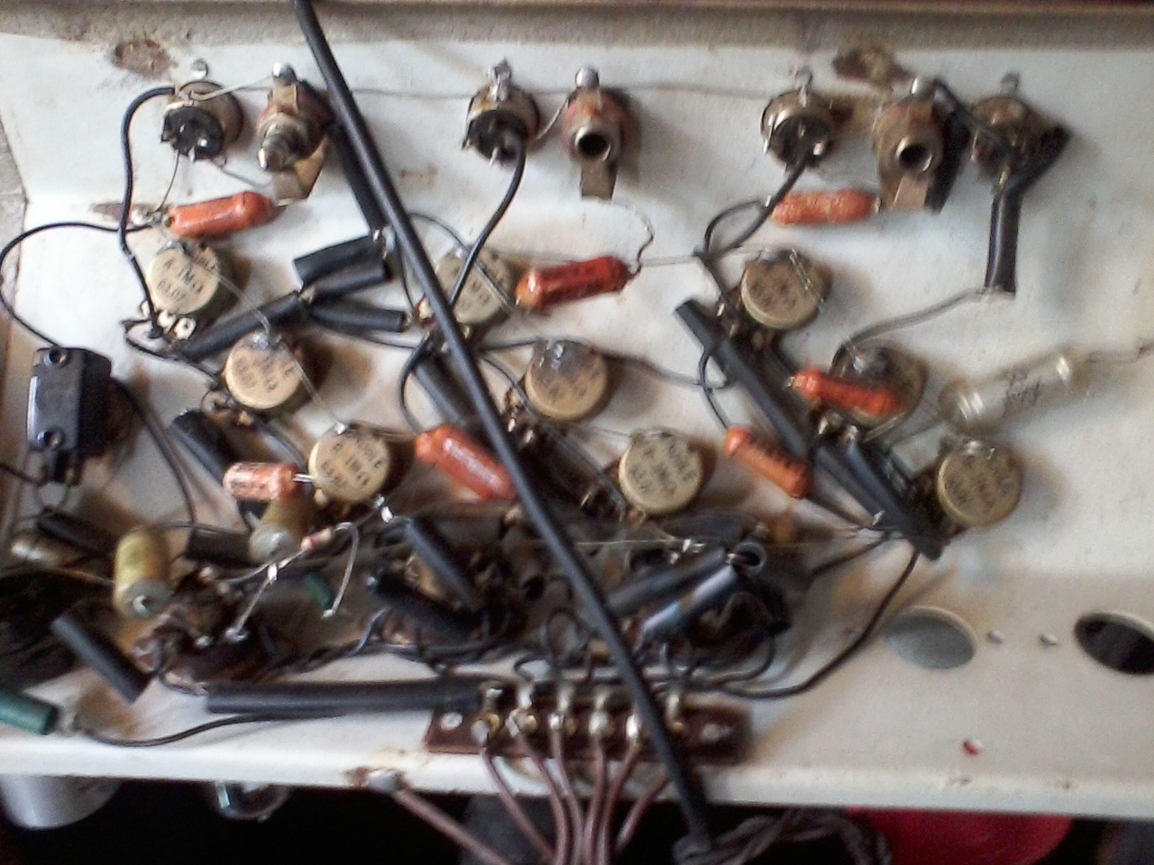

but the pre amp has really been messed with if anyone can identify this amp or has a schematic that would be really cool other wise I'll hav to do it the hard way and figure it out from whats still original on each Chanel any help suggestions or comments wellcome

Personally from that, i'd start from scratch, get more tagstrip in there and clean it up a bit.

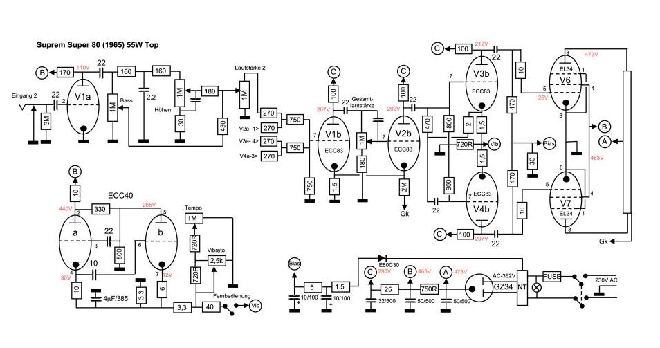

Prowess Amplifiers - Misc - Schematics - Suprem Luxor 30
That may help with the PI and power section, other than that, i cant find a lot...
