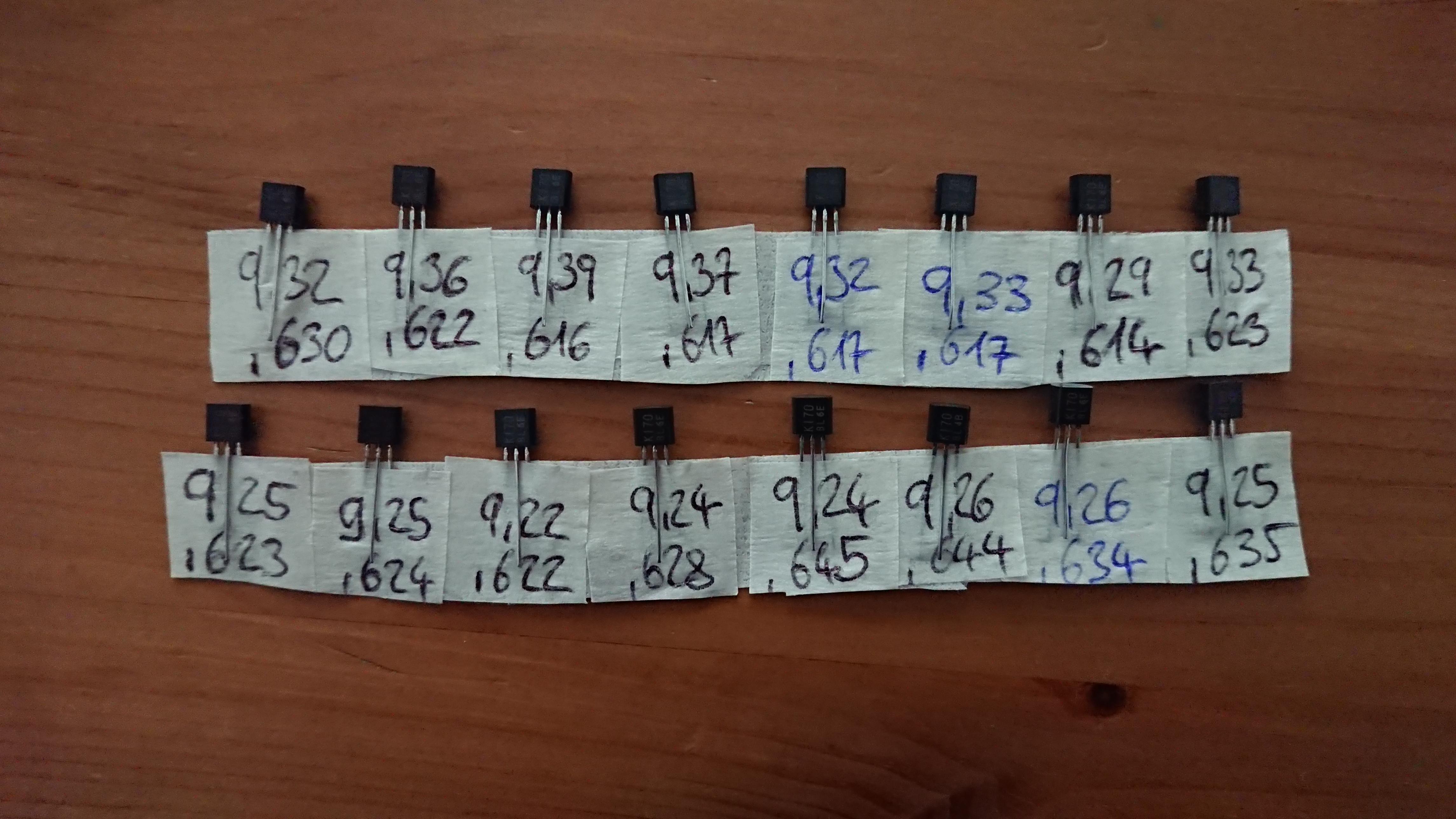

I got mine. How much important of 0.02 and 0.07 differences? Could i use them together with any project?
Thank you

Hi Alchamist,
those differences are in the range of measurement error on my non-professional matching jig. So maybe the matching is even better, or even worse.. Build that simple Jig you can find in Post #1 of this thread and you can experiment yourself. You will see how measurements differ with surrounding temperature. We match at 20°C, but we use them in amps with 30°C, 40°C, 50°C Temperature inside.
Of course it is impossible to get 20 octets with 101% perfect matches when using a pool of "only" 400 or 600 devices.
As you can see each octet consists of 2 tighter matched quads with very equally Idss and Vds and you can pick your devices like you need them. Each quad consits of 2 tight matched pairs with almost 100% same Idss and Vds. As we can see on your pictures each device is marked clearly and if you cut the stripe after every two devices you will have 4 perfectly matched pairs.
If you degnerate matched JFETs of both left and right channels of a preamp with a source resistor of 5 ohms to 100 ohms then they will "match better" and their curves will be almost identical. This would be the case for some JFET RIAA preamps ("le Pacific", Pearl, BHL deluxe, 'Salas FSP' second gain stage).
