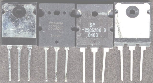

Genuine 2SC5200 ???
Sorry this jpg file not compact.
Attached is scanned image of two 'Toshiba' 2SC5200-O from six just purchased fron Farnell inone UK.
Also for reference two genuine Toshiba 2SC3281. My previous 2SC5200 are in prototypes and cannot be photographed - they look just like the 2SC3281 with symmetrical pins and very shiny smooth metal backs.
Anyone seen anything like these new to me 2SC5200 before - the back are a soft white metal and one has a black paint run down it.
More fakes I wonder, but from Farnell !!!
Cheers ........... Graham.
Oops ! had to resize.
Attached

I think I have already seen this signature with three diagonal arrows in some 'alternative' 2SJ50 and 2SK135 devices I bought sometime ago, when the original Toshiba ones were discontinued long ago
Also, I think there are lots of companies currently manufacturing 2SC5200 clones/fakes and others selling raw '2SC5200' dies, check this out :
http://jingxin.en.alibaba.com/produ...__Silicon_PNP_NPN_Power_Transistor_Wafer.html
I have nothing against China or India, nor against alternative manufacturers. But if they want to clone Toshiba or Sanken devices and gain good reputation with that, they must manufacture them with comparable quality instead of making unusable stuff. Otherwise, they will be allways known as 'those m***er *u**ers manufacturing s**t'
So this signature with three diagonal arrows is from Magnatec

My transistors look just like the left 2SB1429 in your 'transfal.tripod' posting.
The heatsink is visible through the epoxy.
The epoxy is unevenly chopped at the top of the body. (My scanner did not show this.)
Epoxy sheaths the pinouts.
The outer pins are not symmetrically shaped.
Tiny numbers/letters appear inside the indents beside the mouting hole.
I cannot understand the Spanish, so don't know whether the left device is meant to be genuine or not.
My thought is - that a 'generic model' could have been re-numbered !
I would however be doubtful about any 'generic' having the low capacitance that comes with genuine 2SC5200s.
Cheers .......... Graham.

The author of the website thinks that the left 2SB1429 transistor is genuine, as it survived where the the transistor of the right side blew, but obviously this package style is not for from Toshiba, so it may be just an acceptable quality fake or a rebranded similar transistor from other manufacturer
My fake collection :
'F', 'R', 'B' are obviously invalid hFE ranking letters
The '8F' ones have a diminute die, the '4RB' ones have a bigger die but still much smaller than the originals. Both were covered with white silicone
Not much to say here, these are classic fakes...
Lots of wasted money :bawling: :bawling: :bawling:
The extra copper plate [in addition to the TO3-P plate] used by Sanken enhances DC and pulse SOA, altough not all models use them. TO-3 devices from ON-Semi use a similar copper plate between the die and the steel case. I think I have some fake and genuine Sanken 2SC3264 and 2SA1295 already opened but I didn't remember where I put them...🙄 🙄
Unless I'm wrong, the C3264/A1295 pair features too big a die to fit inside a TO3-P package

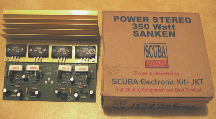

I think this circuit produces only 50W@8 ohm / 90W@4 ohm so the fake devices may work fine
Those 350W ratings usually come from the sum of the peak power produced by both channels driving 4 ohms each
Even TO-220 devices should work here [ie: BD911/912 from ST]. Anyway, those MT-200 cases actually contain TO-220 dies... 😀
