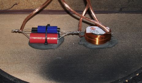

I'm still working on fine tuning these wonderful speakers. I just ordered a pair of Janzten 10uF Z-Superior caps to replace/upgrade the cascade bypass bundle I have in there now, which also includes a 1uF Z-Superior cap.
There's also going to be a few more little tweaks here and there in the near future for these babies!
And after some more research, I settled on a pair of these Jantzen wax foil inductors to finish off the crossovers. These and the caps should be here by Thursday the 1st. Hopefully, after getting back from Cars & Coffee, I'll be able to start the swap out with these new components.

The tweeter attenuation circuit was omitted, leaving only the 10uF cap and 0.47mH inductor.

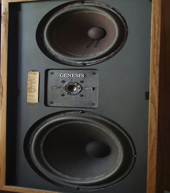

It's not a 3-way system. It's a 2-way with a passive radiator. The woofer is wired directly to the amp, so it in fact runs fullrange.
Your two element 0.47mH/10uF replacement filter is therefore surprising, and I have no idea how it is wired or to which drivers.
The crossover is ONLY for the tweeter.

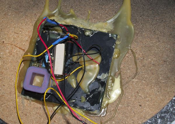

The only problem I see is there wasn't nearly enough glue used in the crossover.
Isn't that crazy?! Someone was way too happy with the glue. I kind of doubt that was done at the factory. I had to take a huge flat blade screw driver and a hammer to them to get that crap off of there.
I'll just be using more of that duct seal to hold the new components in place like last time. Works great!

Speaking of upgraded parts, here they are in all their glory.
I guess it was true about using cascade bypass designs like I did makes a bit of a "smearing" effect. Even though the treble always sounded great, there was a very slight, barely noticeable "fizzy" sound on the leading edge of the treble. That is now completely gone. Nothing left but absolute clean treble.
That's about all I can say right now. People say it takes upwards of 300 hours for these caps to fully burn-in, and probably similar time for the wax-foil inductors. That's be roughly 2 weeks for me since my system is up and running literally 24/7/365.

Charles - I particularly like the crossover damping material

Great job, chops! I'm thinking about building cabinets for a set of Genesis II drivers. How thick is the wood used for the walls of those stock cabinets?

Yes, as Chris mentioned, the enclosures are made of 0.75" particle board. And also as Chris mentioned, the resistors can simply be bypassed/deleted.
When they were in their stock form, I always left the switch on the back at "Flat" or whatever it said on there.
If I were to build new enclosures for these, I would use 1" baltic birch plywood with some form of internal bracing. I would double up on the front baffle and go with 2" total thickness as well as have the baffle come up flush with the edges of the enclosure. I would also keep the driver arrangement as is, but either make them mirror imaged or put them all inline in the center of the baffle.
The stock enclosures are well built however. Yes, you can feel all of the panels vibrate with the music, but I can't help to think the enclosures are coloring the overall sound enough to notice. I'm sure I'm getting more colorations from the room than I am from the enclosures.
Charles - for a new enclosure 1" might be overkill for BB plywood, I'd think nominal 3/4" with bracing should be more than sufficient, and I'd definitely eliminate the recess of the front baffle.
As for driver placement, I'd be inclined to at least mirror an offset the tweeters - is there room to do the same with the woofer and PR?
