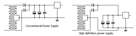

A first (and simple) application of the shared Current Power Supply is entry point of rectifier. I catch this tip on this DIY forum about power supply. One person say that He connect rectifier near amplifier and not on the filtering capacitors. This point don't seems to find any interest!
This wiring greatly improve sound : more details (less foggy sound), sweet and softness, depth bass. I implement in my Model 4 preamplifier.
I give comprehensive schematic on attached picture. To understand differences, draw current during charging and discharging capacitors.

Hi Eric,
The size of the capacitor is determined by four things: First is the power line frequency, which determines how often the capacitor gets charged. Second is the input voltage level, which determines how high the capacitor is charged. Third is the amount of current drawn by the load, which determines how much the capacitor is discharged. And forth is the desired output voltage, which determines how low the input peak voltage can be.
The schematics shown in the earlier post have a 250V center-tapped transformer so the input voltage is 350V. The load for that preamplifier is 30mA plus a little more for the shunt, say a total of about 40mA. The output voltage is 214VDC. The charging frequency is either 100 cps or 120 cps depending on your power source.
With that, 1.8uF was fine for a 60Hz power line but not enough for a 50Hz power line. I did not have a 50Hz power source to test so I tried adding a second 1.8uF capacitor in parallel and that worked fine. The actual value needed is probably about 2.5uF for 50Hz. You could put together a formula to calculate the size of the capacitor but I find it easier just to make a few measurements.
If the capacitor is not big enough, you will see a notch in the output voltage at the charging frequency. The notch is caused by the negative peak of the input ripple dropping below the level of the output. The capacitor needs to be only big enough to keep the negative peak of the ripple from dropping below the level of the output. It doesn’t help at all to make the capacitor any larger than it needs to be – in fact it hurts because the charging pulse is shorter.
Your comment on the importance of the entry point is interesting. I know that the resistance of a few inches of wire can cause a problem if you get the routing of the ground wrong. I had not thought about the importance of the routing of the voltage, but of course it is just as important as the ground.
