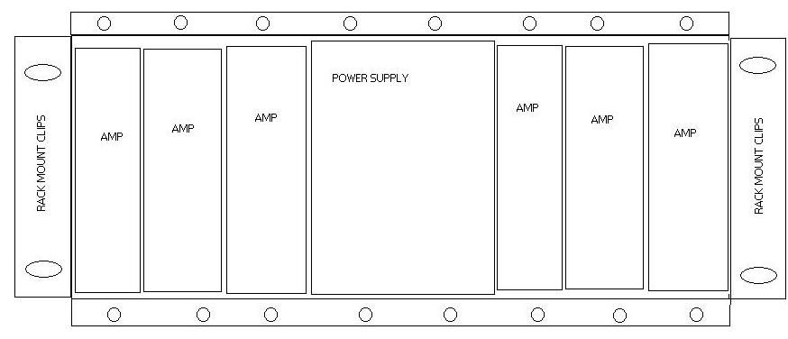

Generic Open Chassis Design ...
Hey All ....
Is anyone interested in a generic chassis design effort ???
I've got an idea for a Amp Packaging system . Something that ANYONE can use . I've been lurking the audio boards for DIY projects and I noticed, everyone and thier brother has an idea for an amp circuit, but the hardest part about "any" of this is making it "real" . You know , the "package" . This is what I do for a day job :) Well ... Mostly PCB Design lately ....
I've been thinking of making a "rack" system , with modules to plug in and out for different amps and power supplies . More of a heat and power management "system" to build/test audio amps in ...
The cards would/could be the power supply and different amps for different users ... i.e. home theater , 100-200 watts x6 or x7 with 250-1500w subs ??? relay card for multi-room users ??? maybe a power supply for the car stereo crowd ??? a one size fits ALL scheme ????
My idea is to have an "orderable" or "buildable" cabinet. Maybe with SOME "custom" sheet metal parts built into a rack and card system . Then PCB's could be designed to fit this system . My idea here, I think, is CHEAP !!! ... OPEN, as in, free to the public DIY groups . EXPANDABLE , expendable , economical :)
YES .. I want my cake and eat it too !!!!! :)
it could be built up as 500 watts or upto 5000 watts ??? just get the bigger heat sink and fan kits ;)
let me know your thoughts .....

Hey all .....
I'm heading down this path ANYWAY and I'd like to get ANY AND ALL idea's ANYONE might have !!!!! So regardless , IF you want one or not , feel free to chime in !!! AT LEAST "one" will be built !!! :)
I've designed over 150 chassis parts and 1000 PCBs . I've been at this for 20 years or so ... working with DC to 200 amps and multi-gigabyte digital paths ... mostly designing optical switching equipment lately . I feel that I have more than enough experience to handle this job . I also have a couple of close friends, couple that do the same thing I do, and they have expressed interest as well . Couple of them are more into Mechanical Engineering than I am . One in particular works for a fabrication rep firm :) This isn't something I just came up with and posted here ... I .. like ALOT of people here .... have built a few amps for hobby .. Just so happens I'm a audio/visual geek as well as a design geek .. So most of my toys are PCB based and packaged before built :) I've been playing with the chassis idea now for a couple of months ... thinking of something I need/want for my own use . I've been hunting for AMP schematics to get an idea of what kind of power is available to work a chassis around ... then I spotted this place .... figured others might like this idea too ???????
so as a starting place .... what does everyone want "in" this chassis ?????
My idea is an "open cage" to slide cards in ... as simple as possible and as few "pieces" as possible .. 19" rackable .. leaves 16.5" of inside the cage room ???
make the pieces in such a way that...
tops and bottoms are the same piece ..just flipped over ???
left and right sides are the same .. only flipped over ????
optional sides can be configured to make the chassis taller .. or the cards/modules wider .... i.e. 1", 2", 3", 4" wide top/bottoms, fronts and backs for the cards/modules that all have the same side used on both the left and right ... then a chassis side piece would have a matching card/module side piece ...
Power .....
my idea here is simple ... just a "spec" for copper bar stock cut to fit the width of the chassis ... isolation mount a couple of them
in the back of the chassis . Then we have a "clip" that is soldered to the back of the module/card/PCB in a "spec" area OR MOUNTED to the module for the point to point designers ... different clips for different width modules too ... 4" wide clips would be REQUIRED for the power supply .. .5" wide clips for your 50 watt amp module ??? Also an option for OUTSIDE power .. i.e. the rack can be ALL AMPS with a totally separate PS chassis ...

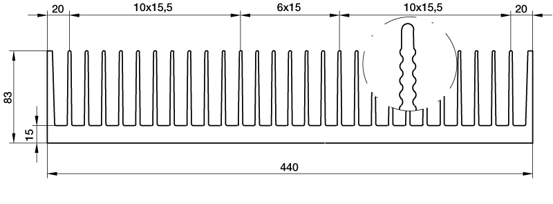

HEAT ....
find an "off the shelf" extrusion that mounts on the top and/or bottom .. mount as many as you need ???

Well, TVP, knowing that you are a seasoned designer with a good idea of the costs involved, I think you will meet with success.
The most buy-in will likely be from gainclone type designs. If the form factor can accommmadate a decent transformer and X number of 3875/4780 amps I think that it will have the best possible mass appeal. Once you have that, you might either broaden your scope to some common discrete designs or just hope that people will adapt to fit your chassis.
I don't know what the sinking requirements are of the amps you plan to pack into your chassis but you might want at least one readily sourced heatsink profile that can fit in a "standard" module. Depending on this decision the same profile in a longer length might accommadate multiple designs.
I agree
I agree with Tiroth, the design so far looks good to me.
For your slidable cards, keep in mind that a lot of people here like to make their own PCBs, so consider a way to allow for many size PCBs to work in the case, either slide in or fixed, with a common connector to connect them up.
Isn't tin good for shielding? Maybe the interior could be subdivided by a tin or other shield to make a few isolated compartments?

as for the heat and sinking it .. I was planning/thinking the "case" would do ALL of it !! i.e. the amps and power supplies would transfer the heat by mounting your "switches" (fets, xstrs,etc) on the body of the "modules" which would transfer it to the "case" ... the "case" could have a heat sink mounted on it .. top and/or bottom ... as needed . Idea here is , modular .... if your design only dissapates 10 watts of HEAT , then you probably don't need a heat sink AT ALL ... but if your building a 2500++ watt monster with only 85% eff and your burning off 375 watts ... then you'll proably want to bolt on a few heat sinks and fans to help dissapate it !!!!!
Of course ... I maybe WAY off base here and you guys WANT the heatsinks (and fans??) inside the modules ... then we can knock a couple of holes in the front and push or pull air from the rear ??????

I think that you may be confusing output power and dissipated power. Chances are good that your 600 watt pioneer isn't dissipating more than 75 watts on an average basis. KWski is referring to class A amps and heavily biased class AB, ala Pass. Ths type of amp dissipates a lot of heat continuously, while most commercial class AB designs idle at a few tens of watts and since most people aren't going to use more than a few watts RMS, the average load is low.
My A75s have over 600 square inches of heat sink surface area per channel (10"h x 13" d x 1.5" thick, 20 fins)and have no trouble at all maintaining 55C on the heat sinks, idling at 200 W/channel.
If you are talking about a sealed chassis and trying to conduct several hundred watts off each amp and dissipate it on the chassis, your devices will get way too hot to have a useful service life. At each junction there is a thermal resistance, due to the surface not being perfectly flat. Sheet metal doesn't have enough cross section to conduct much heat efficiently. all this results in a tremendous temperature rise from the heat sink to the device junction.
Take a look at the AXE-1 calculator on the AX wiki - it includes a spot where you can add the thermal resistance of your transistor mounting scheme. Let's be really generous and say each interface has a thermal resistance of .1K/W. card-rail-case-sink is three junctions, so put .3 in that spot. Don't forget the .7 onto and .7 off the device insulator. See what that does to your junction temperatures. :hot:
The only way that I can see your idea working for class AB amps is to include ventilation and a space for each card to have its own heat sink, something like what outlaw audio does here: http://www.outlawaudio.com/products/770_gallery.html# Sealed up the way it sounds like you're heading, I agree with Kilowatski, useful for class D and low power chip amp applications only.
I'm thinking you want a standard bus connection for the card edge. One connector uses a three pin high amp connector for +V,-V,Gnd. I guess this is your buss bar idea, but should it be pluggable? could always machine copper bits that mount on the card, then screw to the bus bar from the rear with copper screws. Copper does corrode, but a tight screw connection will not corrode where is matters, not for a long time anyway.
As for heat sinking, could just add custom heat sink cards adjacent to hot modules. Can have micro fans blowing out the back or even water cooling. Pull the heat from the chassis at module edge. Maybe just make your module 2 or 3 u wide by bolting together.
Another possibility. Modules are inserted from the top. Top of enclosure uses sections - flat metal or heat sink depending on what's in a given slot. or the heat sinks can slide onto the back from the top - picture an aluminum dovetail or something on the back of the module with the devices mounted to it: slide in your mode, screw to buss bars for power, slide on the heat sink (which can couple to the adjacent module spaces to make it larger).
Speaker connections on the bus as well? Comes to a problem with how many speakers you can output to per chassis. Probably best to have speaker outs on the back of the cards.
Just stormin ideas.
-b
Forgot to mention liquid cooling. Makes me cringe too, but there are a lot of water-cooled products out there now for computers. Cooling blocks that sit right on the CPU, use a small pump, and pump to a radiator (with or without fans).
Could be the top plate or back plate is a big heat sink with water cooling built in. This keeps it sealed and away from direct contact with the devices.
-b
TVP,
No way on the heat sink. Do your calculations; 130 degrees F is 54 degrees C. That means your heatsink needs to support a 34 degrees C rise above ambient. If you do the division for the 500 watts that means you need a heatsink that can handle 0.68 degrees/ watt. Do you know how large of a heatsink that would take? You would need a 17" piece of the following:

If you READ my whole thread ... I'm NOT trying to dissapate the heat across ONE LAYER of SHEET METAL ... there are ATLEAST 4 layers of sheet metal there ... and an offer of a heat sink for the top AND the bottom not to mention fans??? and why do you THINK you can't dissipate 375 watts ACROSS a SQUARE FOOT ????? you know .. that's the CROSS SECTION in this application ??? I'm not cutting the sheet metal into strips and trying to tranfer the heat from one edge to another edge .. I'm trying to tranfer the heat from ONE FLAT SIDE OF THE SHEET TO THE OTHER FLAT SIDE ... right ????
ahhh ... no ... I'm NOT confused ... I was on the team of poeple that managed to put a 100 gig optical router hanging out on a telephone pole ... SOMETHING ALL THE EXPERTS IN THE WORLD SAID IS IMPOSSIBLE ...yet they have been hanging there and running for OVER 4 years !!! I often do the impossible .. every day infact ... oh , and BTW .. it's dissapating 118 watts of HEAT in the NV AZ Sun AND you can touch the case !!! look ma no FANS either !!! :)
so your saying your A75's aren't UL listed ?? i.e. 30 deg C is the MAX allowed case temp from UL ... or are you saying they are 55 d C AT the transistor ??? and get cooler from there ??? they idle burning 200 watts of HEAT or even 200watts or 110 line AC ???? holy **** bat man ... what are they total power rated !!!!
so a car can't dissapte 250k ++++ BTU's (500kw++) through a single layer sheet metal radiator ???? heat dissapation is a matter of square inches of dissapation area ... more sq inches = more heat transfer !!!
unless you guys are talking (behind my back) about putting 3-4kw with 80% eff into this chassis .. I really don't think heat is the issue to be concerned about ...

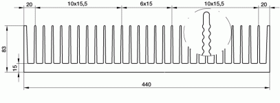

200 watts per channel is a lot of heat. That was my point about class A operation - you're lucky to get 50% efficiency. The Pass Alephs go around 33%, Zens can be 5% efficient. Some of us think that the sound quality of class A operation is worth the heat. My 200 watts (400 W stereo) idle gets me 50 watts out if I limit it to class A, maybe 150 if I go AB, since my rail voltages are higher than prescribed.
No, I don't try for a UL rating on my DIY projects, although I follow practices to make them safe. You CAN touch my cases, but not for long. ;)
Even spreading your heat across the flat surface, you've got a couple of interfaces to cross - grease will help but the larger surfaces make it that much harder to get it flat across the width, even for a professional machine shop.
Your router probably has its power devices mounted directly to the inside surface of the case, and they are massively parrallel - lots of devices carrying the load mean the junction to sink thermal resistances parallel, just like electrical resistors. Even so, I suspect that you are probably pushing the junction temperatures a bit higher than the DIY reliability "limit" of 100 C in the summer sun. Nothing wrong with that, just don't expect it to live 20+ years. Again, I refer you to the AXE-1 spreadsheet to see the effect adding more devices in parallel has on junction temperatures.
Heat dissipation capability is a function of surface area AND mass flow across it and the thermal capability of the medium to which you dissipate the heat. you need more area in space, since there is no convection.
Here's a problem I was part of a team that solved: Dissipate 5KW on VME format cards at 70,000'. Don't forget ram air temperature rise. You need a fan for low speed/altitude ops, but at high altitude, the fan will impede the airflow. You're not the only one who has worked on some difficult problems. People smarter than me did the solving, I can regurgitate the solution, but I'll probably miss some important detail. :xeye:
lowlevel has an excellent point - in a production system requiring flexibility and (field) upgradability, the card bus makes sense. However, in a one off (or even ten off) project it's just a lot of expense with no real benefit and maybe even a detriment. It's way too easy for us engineer types to get carried away with the "wouldn't it be cool if..."
