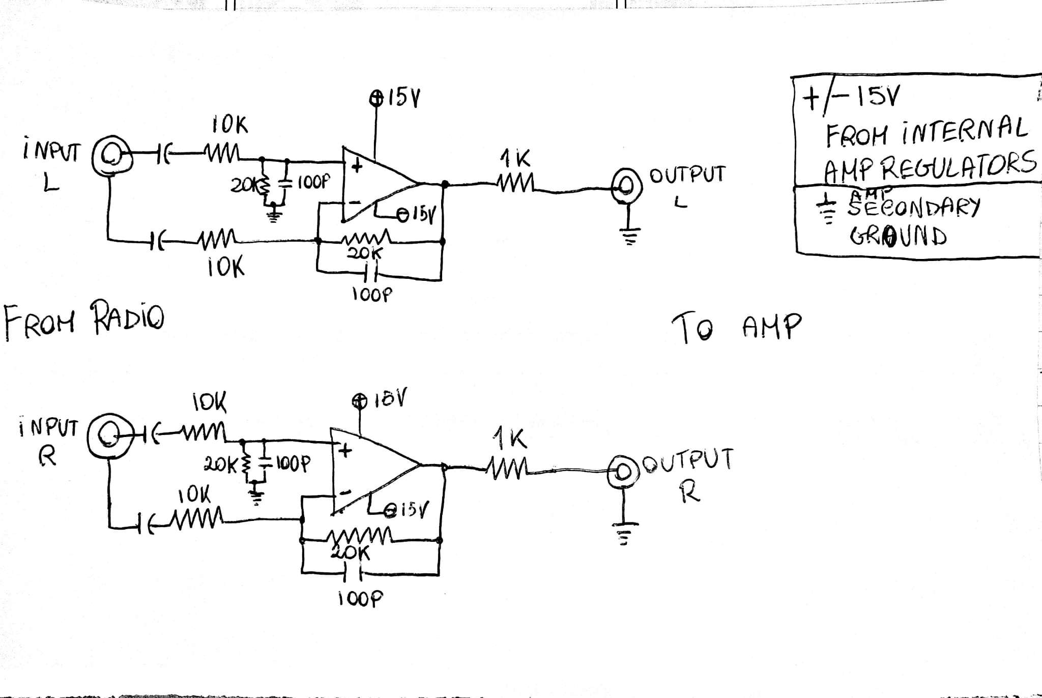

Guys, honestly I would like to try to isolate the amplifier from the rest of the system using a pair of OP AMPS (for example tl072), in this way, it seems that the shielding of the rca coming from the radio does not directly touch the shielding of the amplifier , this way you should stop the noise.
But if I'm wrong, correct me.
thanks.
It should help prevent the noise from traveling back through the system but it won't stop the amp from having the noise from the un-synchronized oscillators.
It's a lot more work than a GLI since you have to supply power to the op-amps.
Yes Perry, I agree, GLI is ready to be interposed between the RCA cables, this circuit instead must be powered.
It shouldn't be a problem, because usually these amplifiers have the preamp section on a separate board that literally detaches from the rest of the amplifier, it can slide from the chassis even without removing the amplifier from the car, so the circuit can be integrated (interposed ) working only on the pre card.
I can "hook" the power supply (+/- 15v) on pins 8 and 4 of one of the many OP AMPS already existing on the board and earn the secondary GND simply by hooking to the RCA shield of the amplifier itself.
Also (correct me if I'm wrong) a similar solution does not degrade or modify or alter the signal (especially the ultra-low frequencies) as could happen with a GLI.
I know very well that any solution adopted will not prevent the amplifier from whistling, but at least these whistles will not fit into the rest of the system, right?

Did you attempt to test one or more GLIs to determine precisely how much they decrease the low frequency response? Remembering that some have to be oriented properly in the signal path, regarding input and output?
I'm not trying to discourage you from building the circuit but is it worth it to lay out a board for a specific case, to get boards printed and assemble them, pay for the case for it and then install them?
I've been through the process of having to build various circuits and, for me, it's far too much trouble, especially when you can simply tell the owner to go buy a $15 part. Can you sell the device for that price?
If you want to modify the amp, I'd look at simply making a slight mod to the circuit that's there. It may mean nothing more than breaking the ground from the RCA shields and inserting a 1k ohm resistor, then connecting the audio input ground to the actual RCA shields.

No perry, unfortunately I did not test with any GLI, but it was enough for me to get informed online and listen to the opinion of some people who have used it.
According to them, the functionality is good, but for trained ears it is evident that part of the musical information in ultra-low frequencies below 50hz are attenuated, this is unpleasant especially because if I use a monster amplifier like that it is because I want a monstrous bass, therefore, if this device kills me down, it makes no sense.
If the device I plan to make works well, I am not going to sell it, but if someone asked me (from that moment) a solution to this problem, I would know how to do it, integrating this circuit inside the amplifier, not with an external box.
I have to be honest, I had already thought about separating the shielding of the rca with a 1k resistor, but then I thought that there will never be a real separation through a simple resistor.
What do you think about it?

3rd opinion here, I would encourage you to at least try a GLI. I used quite a few over the years, and was never disappointed. None were ever removed for audibly degrading performance.
I did a couple of op amp circuits years ago for adapting differential inputs/outputs within car systems and was disappointed that all the effort didn't work better than the simple pair of transformers in a ground loop isolator.
