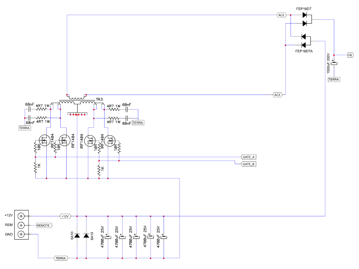

Yes. These amps have buck converters that they use to make up the various voltages for preamp and drive circuits

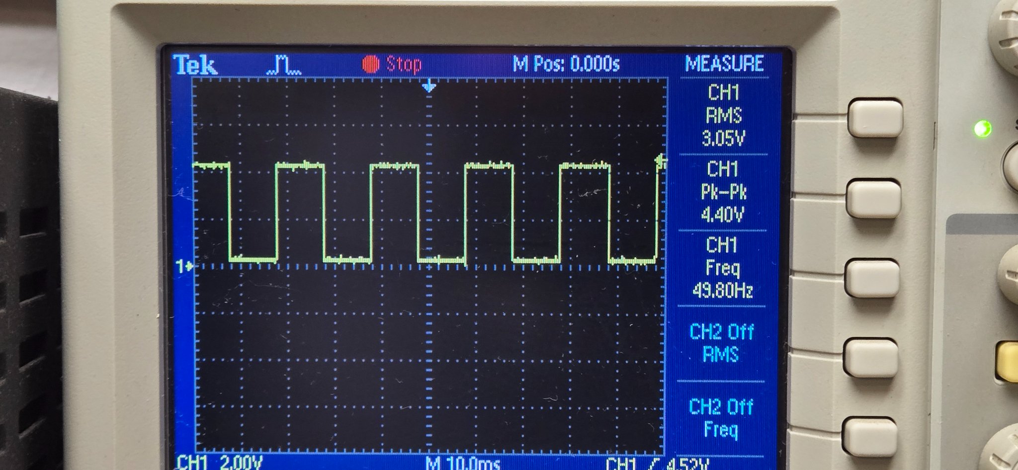

@laluns I have done as you have said. I use a QuantAsylum as my signal generator. You say to "Power up the amp with the signal and load connected" I assume you want me to be playing a 50hz tone into the amp when I power it up? Powering it up, I'm connecting to main power, ground and remote?
Ok..
Pin 1 of the CSC3127 has 10.24v, Pin 2 has 5.75v, Pin 3 square drive, on both ICs.
The power light cycles slowly, the clip light (original problem) is staying solid, and protect light blinking fast.
Pins 11(15.17v) and 14 (15.36v) of both CSC3127s have voltage but no switching

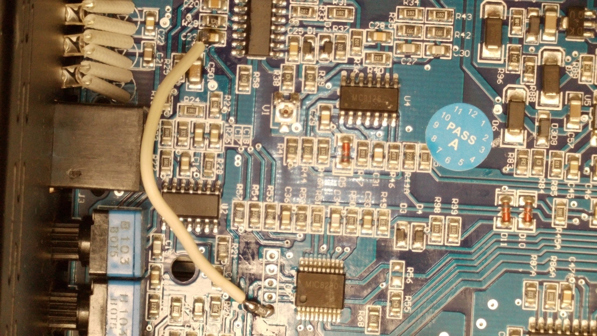

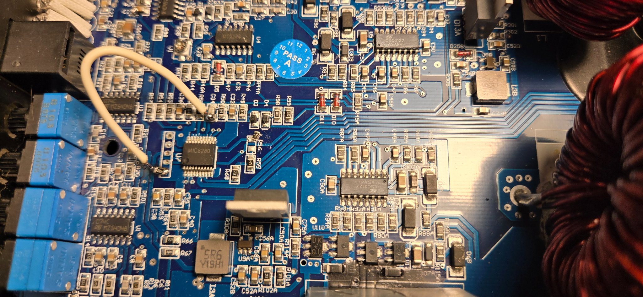

You have the MCu connected wrong. You must put a 4k7 resistor on that first pad and the other end onto pin 14 of the MCU. From your PIC on post #12 you can connect the other end of that resistor to C34, which looks like it is connected to PIN 14 of the MCU. With all the clone amps I get C34 is labeled C23. I will post a pic of how it should be done later today when I work on a few of these amps I have for repairs. The GND for the scope should be on one GND terminal of the amp. and not on RCA GND.

Good morning Laluns.
Ok, moved the jumper. Thought that was a bit strange but it does lead back to pin 14 through C34. Connected it to C34 pin 14 side.
New readings using main ground.
Pin 1: +10.3v
Pin 2: +4.0v
Pin 3: switching
Pin 11: +15.4v
Pin 14: +15.7v
Now the power and protect lights only come on when it tries to start up cycling and the clip light is blinking fast.
