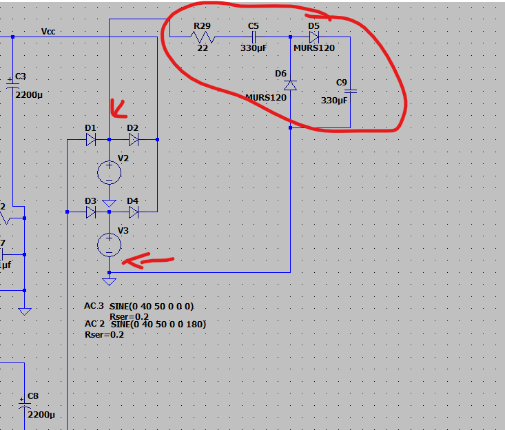

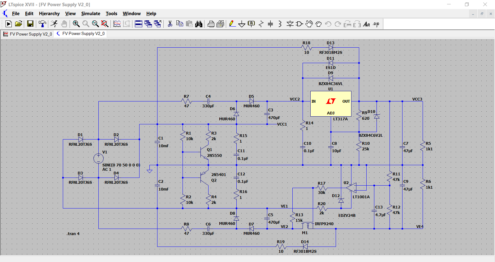

Would a simple voltage doubler arrangement work? Two diodes and two caps.
Just look at the main bits of these two circuits. First one shows the parts tagged on to the power supply. You just feed AC from the transformer into the input of the circuit.
Second one is more complex and has a regulated high voltage output together with a tracking regulator on the negative rail. Yu should be able to pick the appropriate parts out that do the multiplying.
OP has specifically ruled out your solution, NO AC available:
The problem is that the main +/- 40 volts rails are generated and smoothed in a seperate unit and I don't want to modify that, so I need to generate it from one of the existing D.C. rails and in the power amp case.
I do apologise 😉:

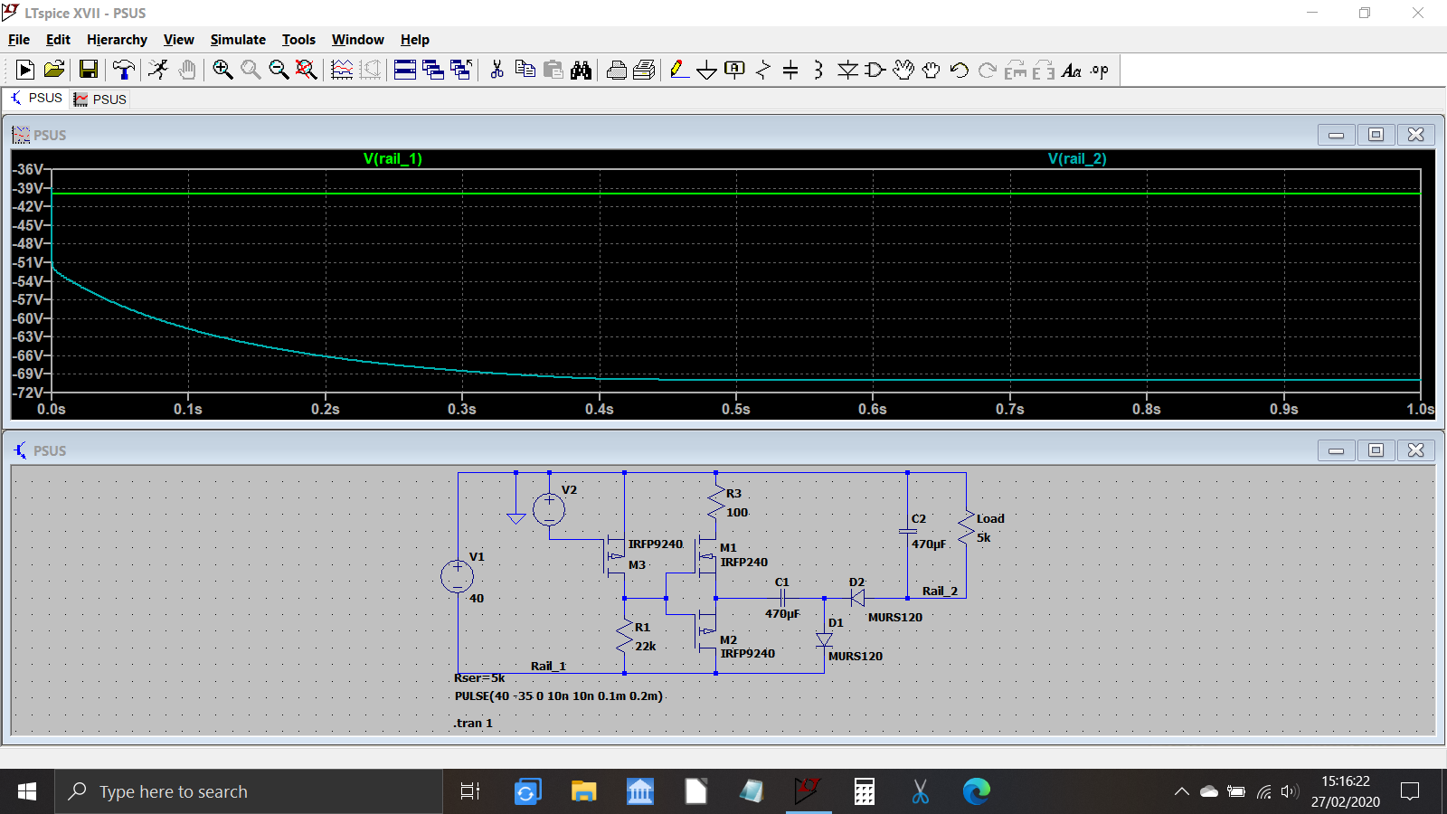

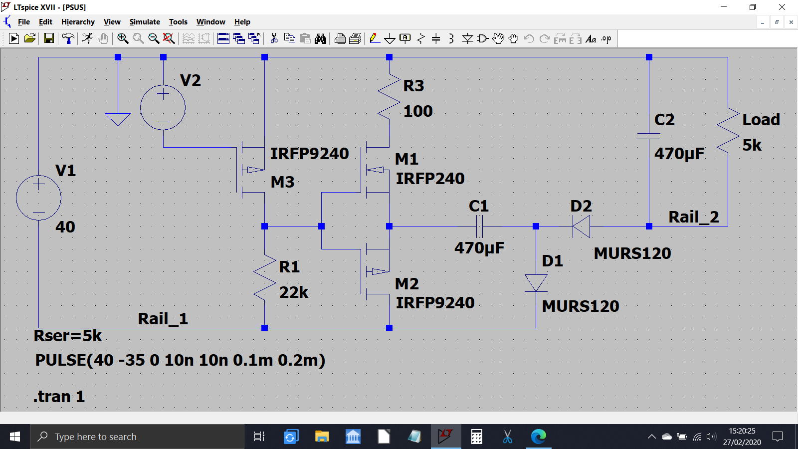

Perhaps something simple like this then. V2 could be a CMOS 4011 (etc) simple low power oscillator. It's supply rail (minus 12 volts) would be a series resistor and zener chosen to minimise power losses. The high voltage output seen here delivering around 15 milliamps has more than enough headroom to use a suitable high voltage 3 terminal voltage reg to give a super clean rail.

Hi again folks
Thanks for the suggestions so far - much appreciated.
As JMFahey pointed out, the main problem is no A.C. in the power amp chassis so some form of oscillator and voltage step up is probably necessary either descrete or encapsulated but implemented in such a way as to not dirty the ground or the rails - lots or decoupling needed.
A low voltage DC to DC converter (24 volts or so) is a possibility as long as it is truly floating because it could the be referenced to the existing -40 volt rail.
I think a bit of breadboarding will be in order - and thanks for the sims files.
Also I have just found that the 555 timer is implemented in LTSpice to use as an oscillator 🙂
