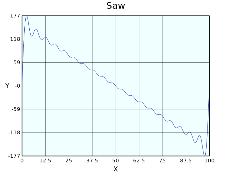

The simple approach of generating an exact sawtooth will produce aliasing.
A bandwidth-limited sawtooth can be created by summing the harmonics, stopping at 20KHz or until the CPU cycles are exhausted. A 1KHz sawtooth will look crummy, but that is the best one can do in 20KHz bandwidth.
Since the application and the requirements are unknown, I don't know whether a waveform that looks crummy due to bandwidth limitations is to be preferred over one that looks crummy due to aliasing and bandwidth limitations...
By the way, if the ratio of the sample rate to the signal frequency can be chosen to be an integer, aliasing at least won't cause any new frequencies to occur, it can then at most disturb the ratio of the amplitudes of the harmonics.
