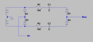

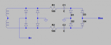

Yes, through the reactance of the caps via the centre tap to earth. You don't need the caps if you just wanted equivalent B-.

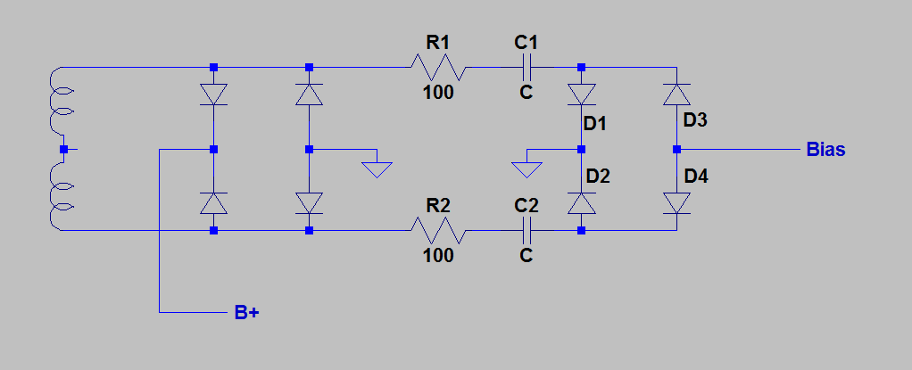

The cap C1 ( and C2 ) can charge when the top of the winding is positive and that charge is transfered through the second bridge rectifier . That's why the current consumption must be low enough .

A floting winding feeding a bridge rectifier will never give you a negative voltage by itself because its ends are *always* positive relative to Ground, best case 0 V, so no diode or combination of them will do.
You can see it as "an AC winding with a strong DC component added" and therein lies the solution.
You can block the DC component with a capacitor and rectify the AC component, which NOW can be referred to Ground and give you a (low current) negative bias voltage.

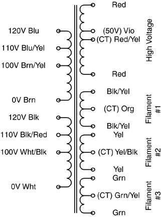

Since I'm using SS rectifiers, I put voltage tripler on my 5vac winding to get bias voltage needed (-19vdc). Tied the + side to ground... has been working fine. So can you use one of the three 6.3V windings for this? Hammond spec sheet should show if one winding is lower current than the others...that's the one I would use.

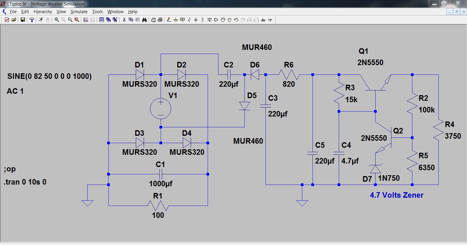

Use this at your own risk.. I am not a fan of doing it this way, but it is an option. You will need to determine the value of the capacitors empirically to get the bias voltage you require. I'd start at 0.1µF and work your way from there.
Actually, Kevin, that is an excellent circuit. One must choose capacitor voltage ratings high enough, as they have to withstand almost VP-P differential voltage. I like 600 V capacitors, in general.
The observation of needing to choose values empirically is OK, but on the other hand kind of flimsy. Better (in my mind at least) is just to strap a resistor-Zener load to the C- supply, and regulate the heck out of it. Cheap, easy, works, no hassle. Since the C- supply doesn't need to supply much current (ever! if done right!), then the Zener doesn't need to be particularly muscular.
