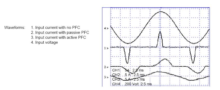

True, but unfortunately, most PFCs in the market are passive and they only improve the displacement power factor (DPF) by widening the conduction angle, but never get anywhere close to the sinusoidal waveform.
Also, no filter will fix a non-sinusoidal AC waveform.
