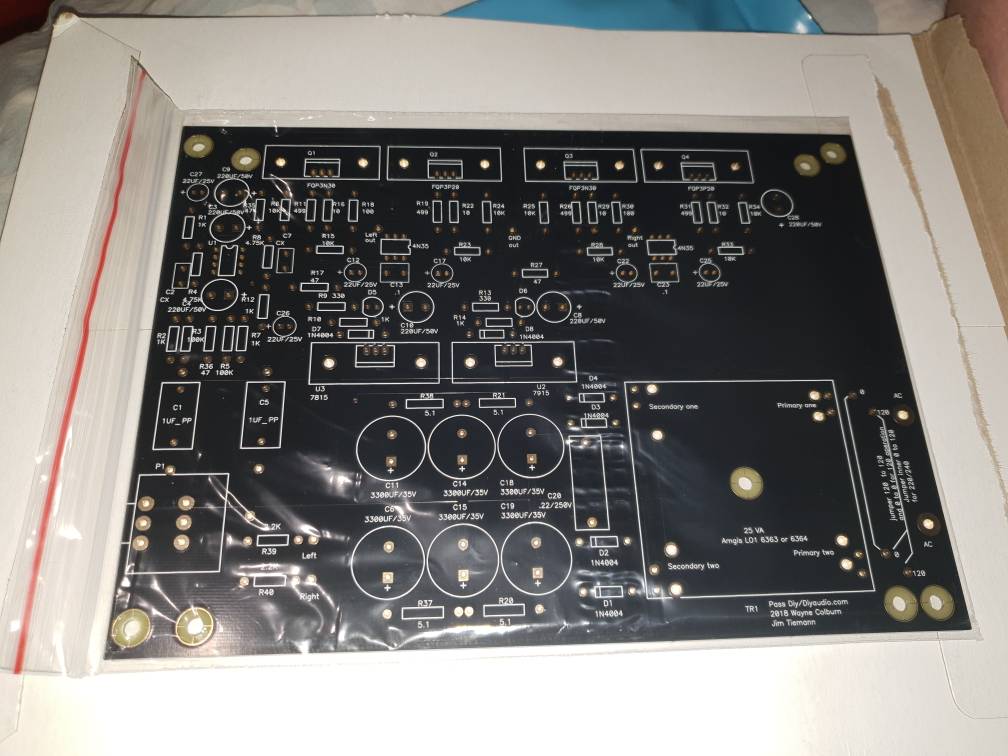

That is very interesting, what does the resistor have written on it?
10R?
Or 103R?
Or something else?
All of these kits were packed at the same time, so it's hard to imagine being off.....
Verify all other resistor values on the board and let us know.
10R?
Or 103R?
Or something else?
good morning
believe me I was so scared of saying something stupid, I triple checked every measure.
The resistors I have from the kit have 10ROF written on it,and they measure at 10 ohms.
I have some 10K dale resistors I ordered seperately with 10K written on them.
The 10K are the correct ones, right ?
Thanks for your help.
Best regards,
Pierre-Antoine

If I remember correctly R3&4 are 10Ω and R19&20 are 10KΩ.
Don't worry about asking questions, that's how we learn.
Be sure you are looking at the F5 v3 Schematic.
Thank you Einric
I did use the schematic provided with the boards, or with the kit I don’t remember ...to be sure, could you point the post# with the Latest schematic ?
Thanks in advance
Best regards
Pierre-Antoine
Thanks in advance
Best regards
Pierre-Antoine
