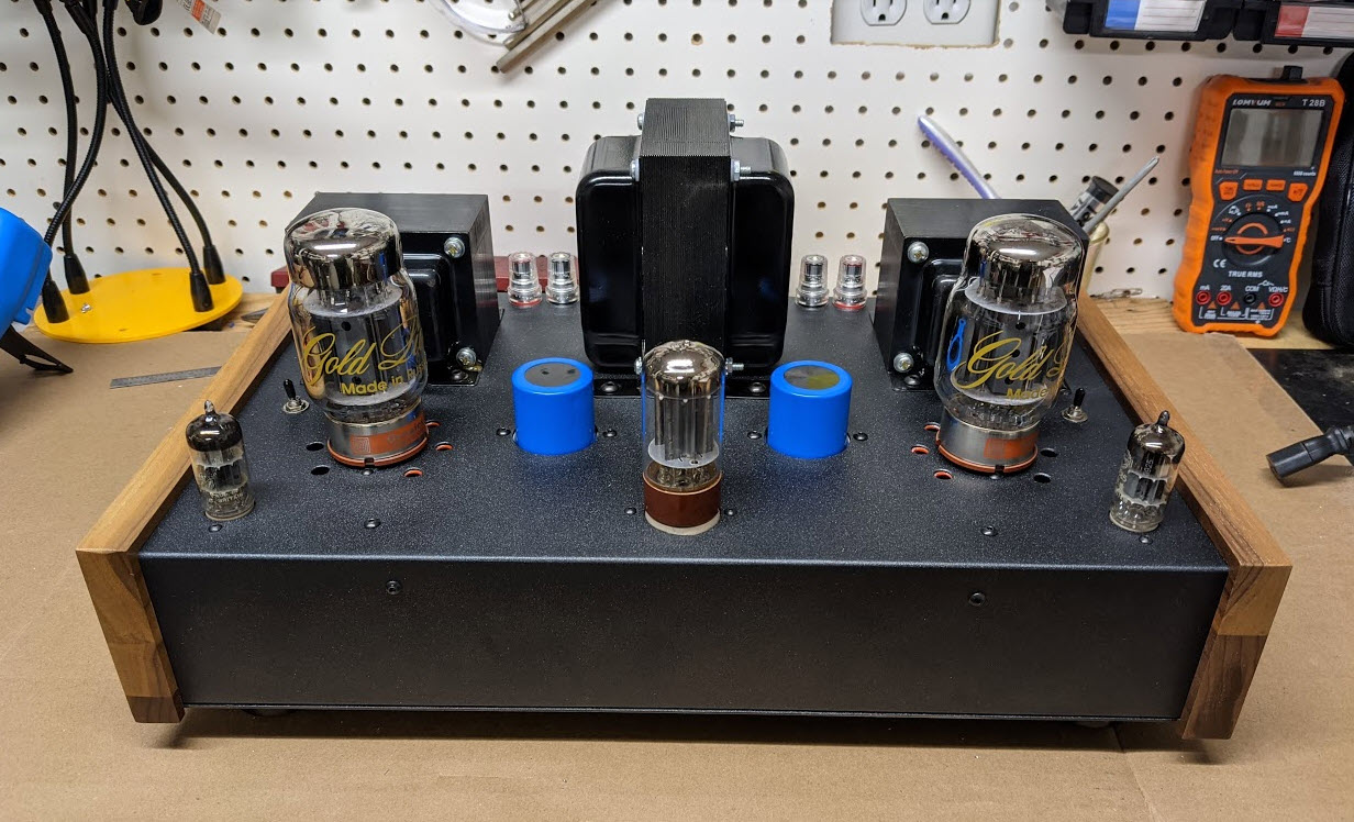

been radio silent for a bit trying to figure out what i want to do, and feel like I've decided on building that kegger/blueglow kt88 recommended above. I'm almost ready to buy all that edcor iron listed on the BOM.
However, my only hangup is trying to see if I'd be able to modify the front end to use a pair of 6SN7 tubes I already have here instead of the single ECC85/6AQ8. Thinking that using 1 dual triode cascaded for each channel would be needed? due to its lower mu but would also improve channel separation and routing inside the chassis. Not having a lot of luck figuring out what circuit would be appropriate here and after a couple of hours learning and playing with ltspice I'm starting to wonder if this might not be the right tube to use here in the first place. Should I give up on the 6SN7 pair, only use one, or just build straight from the schematic and use the 6AQ8?
Have also read some mixed things about the ECC85/6AQ8 tube. Should I look at swapping it for something like a 5670 or 6SL7 if I stick with the single driver for both channels? Obviously it will require resistor changes.
I will be using this with a schiit freya preamp that has a gain of ~4 being fed by a balanced signal from a gungnir but also don't want to limit things either.

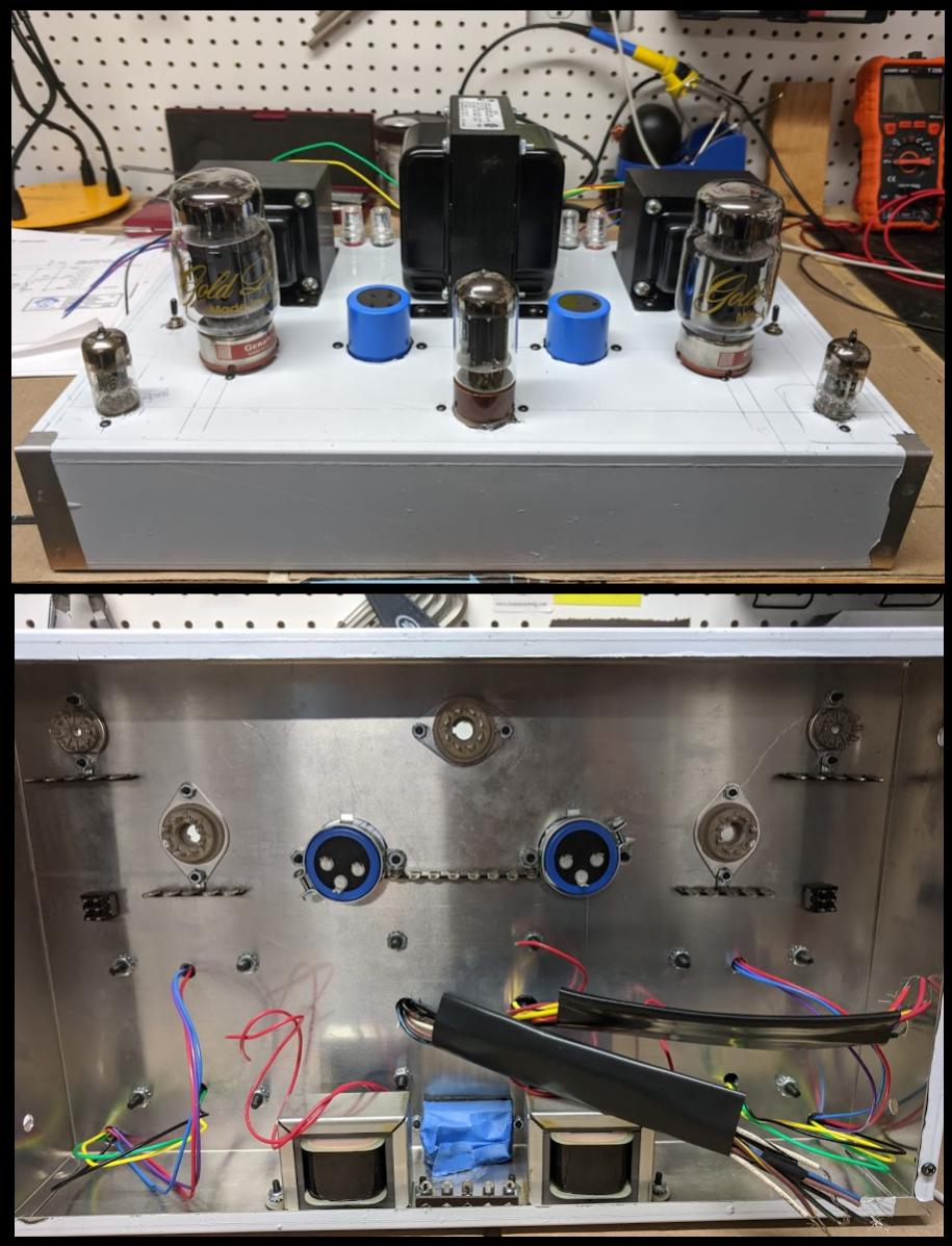

Finally got everything I needed to start my build about a week or so ago. Has been a little slow going but after agonizing on the layout, all the major components are located except for the big input filter cap which I'm planning to put under the PT with a 3d printed saddle to hold it. Hopefully just a handful more tiny holes to drill and also am contemplating how I can stiffen up this hammond chassis. It's very flexy. Last time I'll use one for a project like this.
Decided to deviate a little from the kegger/blueglow/abdellah schematic, but not really. Ended up dividing L from R entirely after the first capacitor, so only using half of the ECC85's (cringe) but also wiring the L/R to use different halves so I can swap the tubes every ~year to "evenly" wear them. Also using a single DPDT per KT88 so I dont have to run those wires all over the chassis. Should make for a much cleaner build. Hard part now is deciding what color to paint it!
Thanks again to everyone for the advice and encouragement to do this. Will come back at the end of the build with another update with hopefully with nothing but good news. (fingers crossed)

Final update here if anyone still cares, but wanted to say thanks for the advice and general guidance here for those who participated.

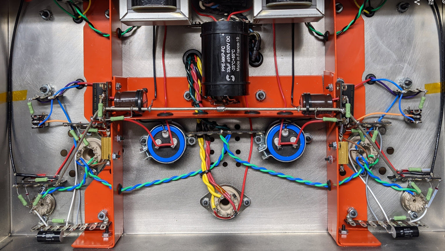

Generally pleased with how it came out for my first build from a schematic. The hammond chassis is the last one I'll ever use for a project with this size of iron, it's just too thin and flexy. There were a couple of times I almost chucked it in the recycle bin to be honest, but the stiffening braces really did the trick even if it did make layout a little more challenging in areas.
On the circuit side, no issues at all, the big B+ voltages are a little low (~10-50V) from where Mark has them, but I do have a thermistor, backup diodes, different input cap, chokes & OT's with a higher dc resistance, and bleeder resistors. Also, this was expected and desired since the OP is a little more reasonable on the KT88's now around 78-80mA and 30W Pd. Believe his schematic has it around 82mA/33-34W.
The ECC85's are spot on around 220-230V at the plates and 2.62V at the cathodes. Oh, and it's dead quiet. Arguably quieter than the solid state aleph which has a little hum in one channel that can only be heard 1" from the tweeter cone. The KT88 has none in either. Sigh of relief for sure! Have very limited listening in it right now since it was only hooked up late last night, but initial impressions are good. Anyway, couple of pictures of the completed result.

Thanks, Duke58! I tend to take a long time to make a decision but then move quickly when I do.
I have a lot of metal fab experience with sheet metal, machining (mills, lathes, hand tools, etc), welding, and cutting but is electronics as a hobby or skill is totally new to me. Technically you could call this the 3rd full electronical project I've ever done and the first where I had to read/understand a schematic and make the physical circuit. The prior were just "put this component there" without understanding fully what or why. The aleph j had a little more free form when it came to final wiring, but even that was pretty straight-forward.
One of the reasons I undertook this project was to try to learn a few of the things I didnt feel like learning when at school for a mechanical degree. Definitely learned/re-learned a good bit but still very much a work in progress there!
Nice work. The internal bracing is nice as it doubles up as shielding between the transformers and more sensitive parts of the circuit.
@Pechelman-- your soldering skills look great, it's all neatly arranged-- makes it look like you've been building amplifiers/electronic projects like a pro.
