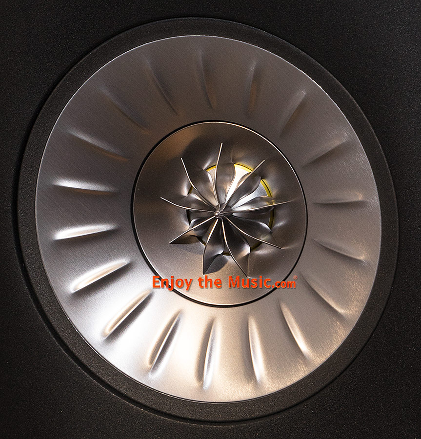

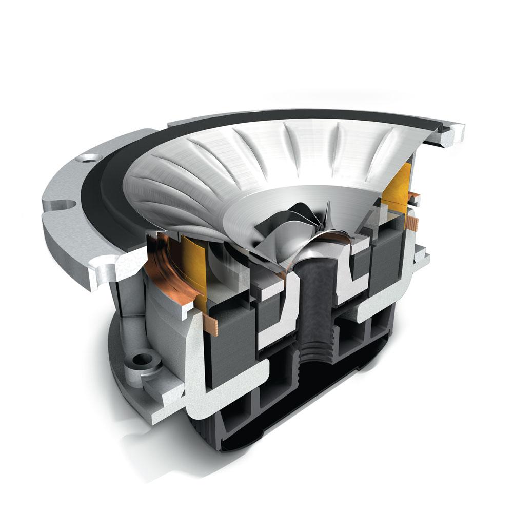

Just from appearance, I would have more faith in great sound if a coaxial speaker like the KEF was used on the front baffle. That would provide a smoother directivity function from midrange up to tweet frequencies, and allow easy woofer blending.
The BMS 6CN160 and 6C150 6.5" coaxials also have some good engineering. Nice computer speakers.
From my experience, I think KEF's coaxials are state-of-the-art. The LS50s and old Reference 205/2 were a revelation for me. From Genelec's measurements, these seem to do well too. Their unique driver complement differs from KEF's in some significant areas:
KEF uses a ribbed surround to reduce surround reflections. Genelec uses a 3-way design, thereby reducing the need to consider excursion in surround design. The midrange is apparently some sort of foam (polyurethane?) with a hidden surround (some sort of rear suspension system?) that is then waveguide loaded. Diffraction where the horn meets the slots seems likely though. I also don't like the idea of oval woofers. More Sd but a horrible chore to fix. Nevertheless, seems intriguing.
