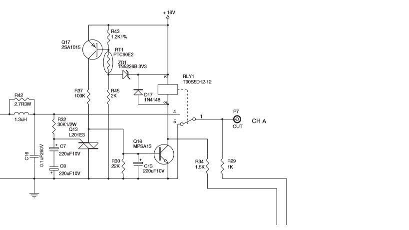

Okay, finally got another chance to look into this and I've just verified with my scope that the audio signal is making it all the way up to the protection circuit, so as far as pin 4 on the relay. I circumvented the protection circuit and the amp is happy to drive a speaker (no DC 🙂). I can't seem to locate the fault in this area the circuit though. Anyone with any experience of the this circuit (see attached)?
C13 shorted ?
Q116 shorted ?
Q13 blown ?
Just work through protection circuit logically.
See if there is DC on gate of triac.
Q116 shorted ?
Q13 blown ?
Thanks for your reply, Nigel. Just as I was awaiting a reply I isolated the problem. It's actually the relay that's faulty! I swapped over the one from the other side and it clicks in. Last thing I suspected. Still they're less than £3 from RS Components, so that's a relief. Thanks for everyone's input. 🙂
I don't know the amp rating but i would substitute the relay with a 16A or better one, since arcing can weld the contacts.
Was it the coil that had gone or the contacts ?
If its the contacts I would replace both relays.
