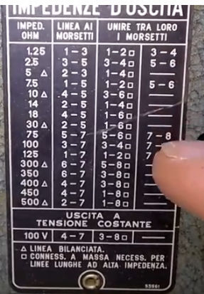

Just bought this amplifier. It is a Geloso G3272A
https://i.ibb.co/YBtX711/20211211-202416.jpg
https://i.ibb.co/Nnd4XsG/20211211-202443.jpg
I want to connect to a 4ohms speaker but it says "linea bilanziata" and I dont know exactly what than mean.

It is not important , if in that chart there are the usual impedances like 4 , 8 ohm .
The output transformer is made with 2 independent secondaries each with 4 wires in total - the 2 x 4 screws on the back that need to be wired right for your speakers .

Connect as "5" between 2 and 3.
Tied 1-4.

[QUOTE="euro21, post: 6875675, mem...s-etc/geloso-g3227-30-watt-valve-amp/[/QUOTE]Hi, thanks. I supossed that but don't understand the "balanced line" as Depanatoru said is the way as the output transformer is connected.
The Italian linea bilanziata means either symmetric output wrt ground or a free floating, isolated output.

According to the official Geloso documentation, the connections marked with "balanced line" are the only ones to use when the speaker cables are very long, also the terminals marked with the square must be connected to the chassis: you can use the screw under the speaker terminals . Geloso amplifiers of this type were often installed on churches. Search for "Bollettino tecnico geloso 99a" (1966) to get the product sheet with the diagram. According to the product description, this 75W amplifier is the best choice for public places that can accommodate up to 1000 people, or can be used to drive up to 50 ceiling speakers. The Geloso main filter capacitors were built in-house and do not age well. Be sure to check if they have already been replaced before turning on the amplifier. The original "death capacitors" on the transformer primary side are almost always leaky and must be disconnected.
