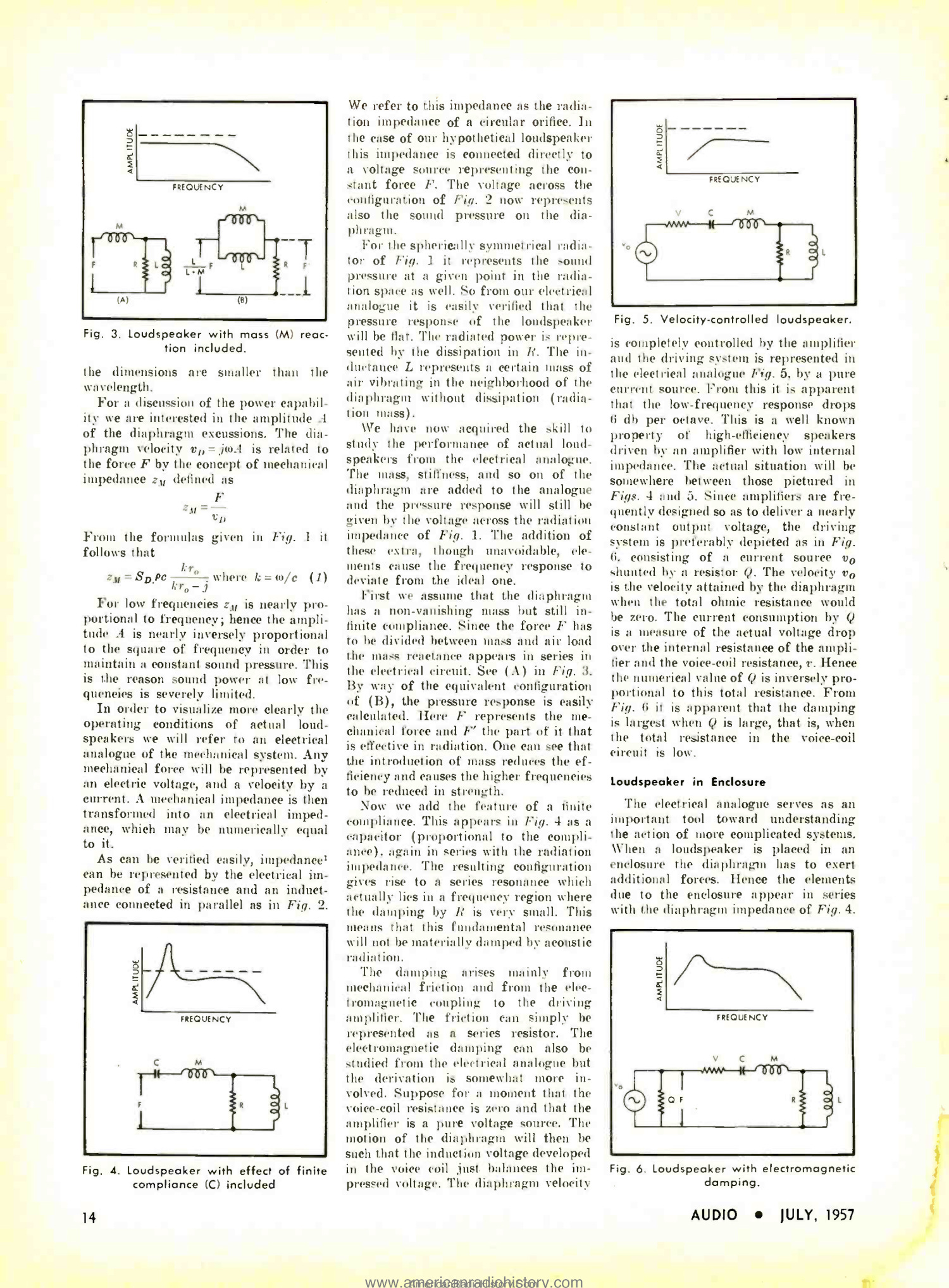

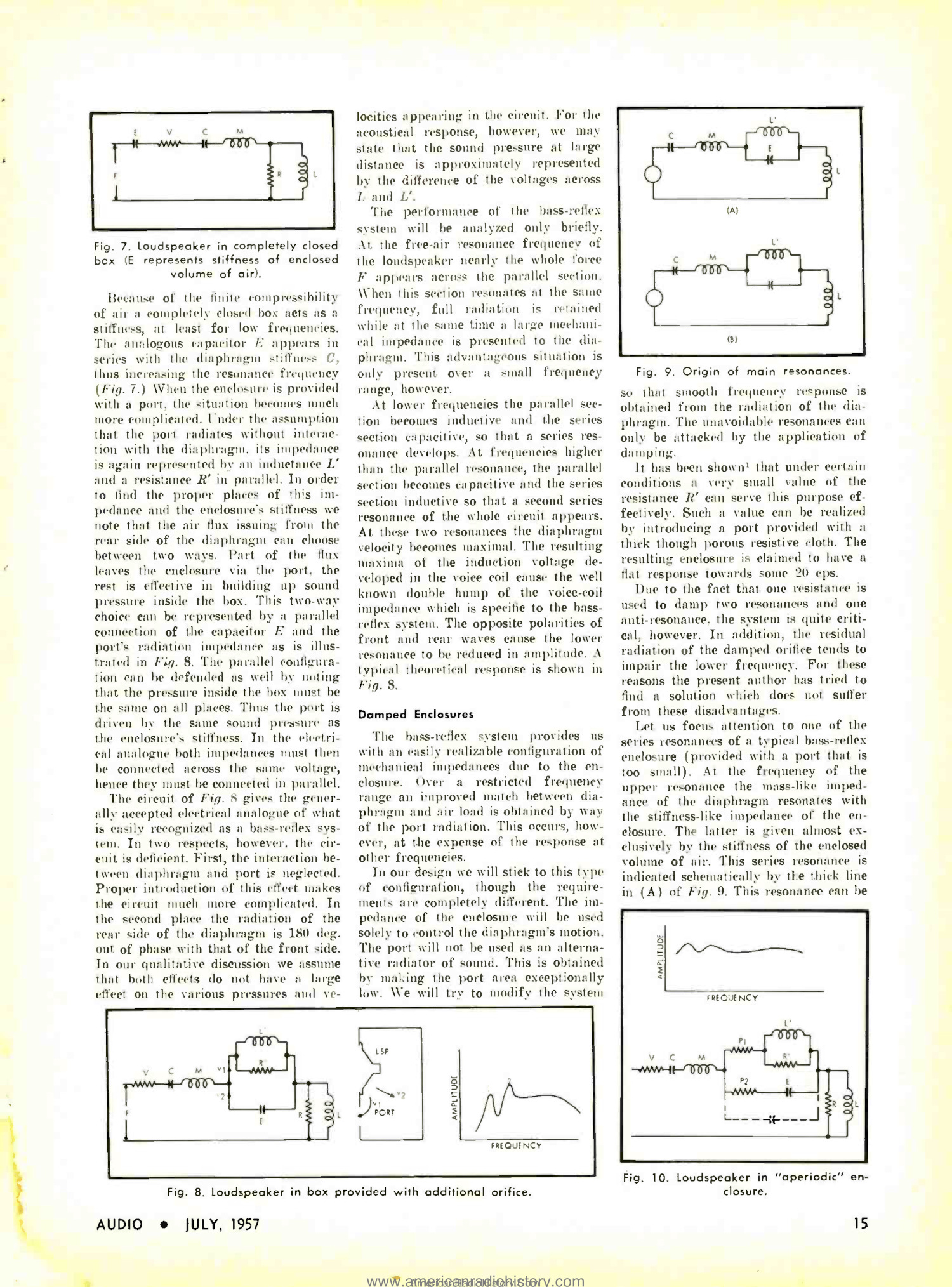

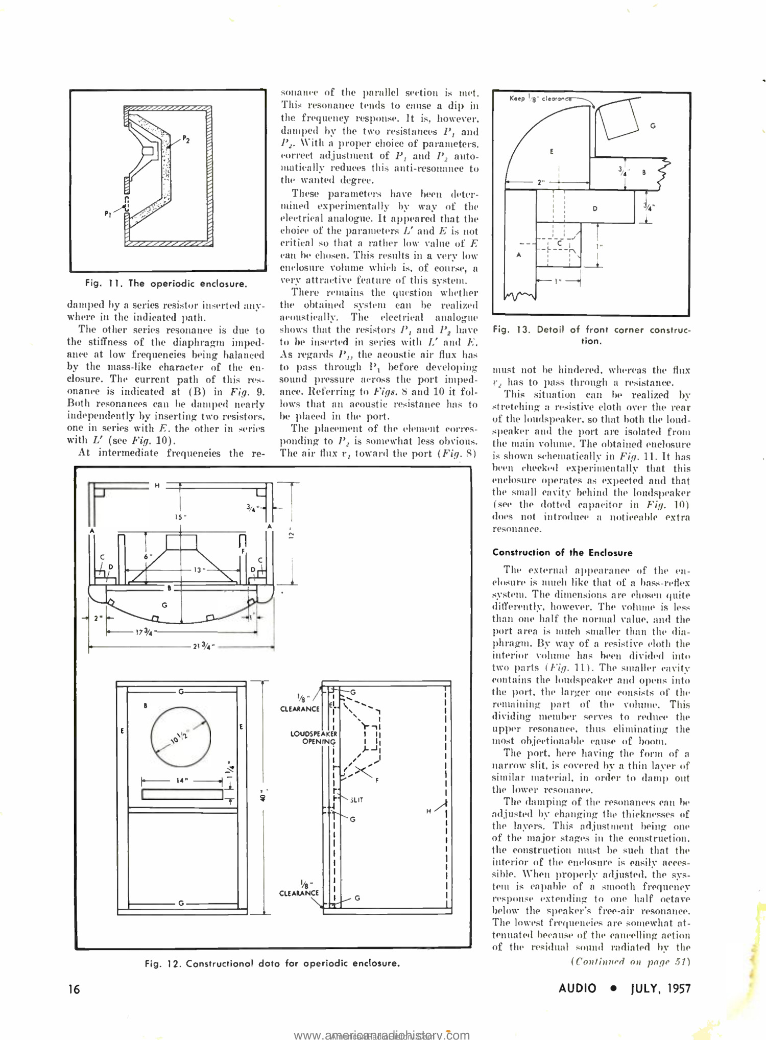

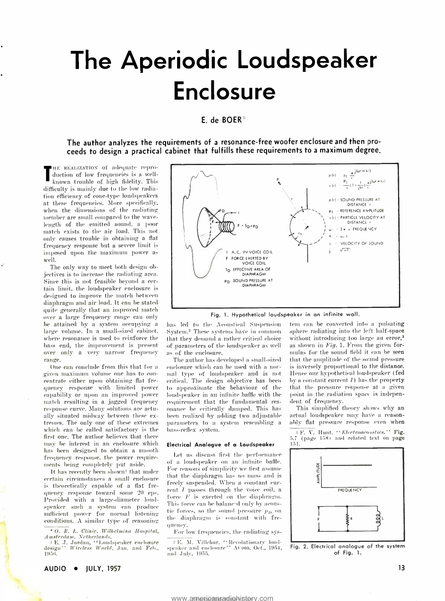

Here they are direct. Page 15 and 16 places are swapped.

I'm constructing an aperiodic at the moment, using a 12-250tc in a simple rear vented enclosure, I might be tempted to try that 1957 version as a second project. Are you going to go for it?

With all the Karlson and horn stuff, there's no space for a new cabinet - it would be a lot of fun mucking with vent damping, impedance/response measurements and tweaking with music tracks.
With proper bracing it should be a good way to go.
