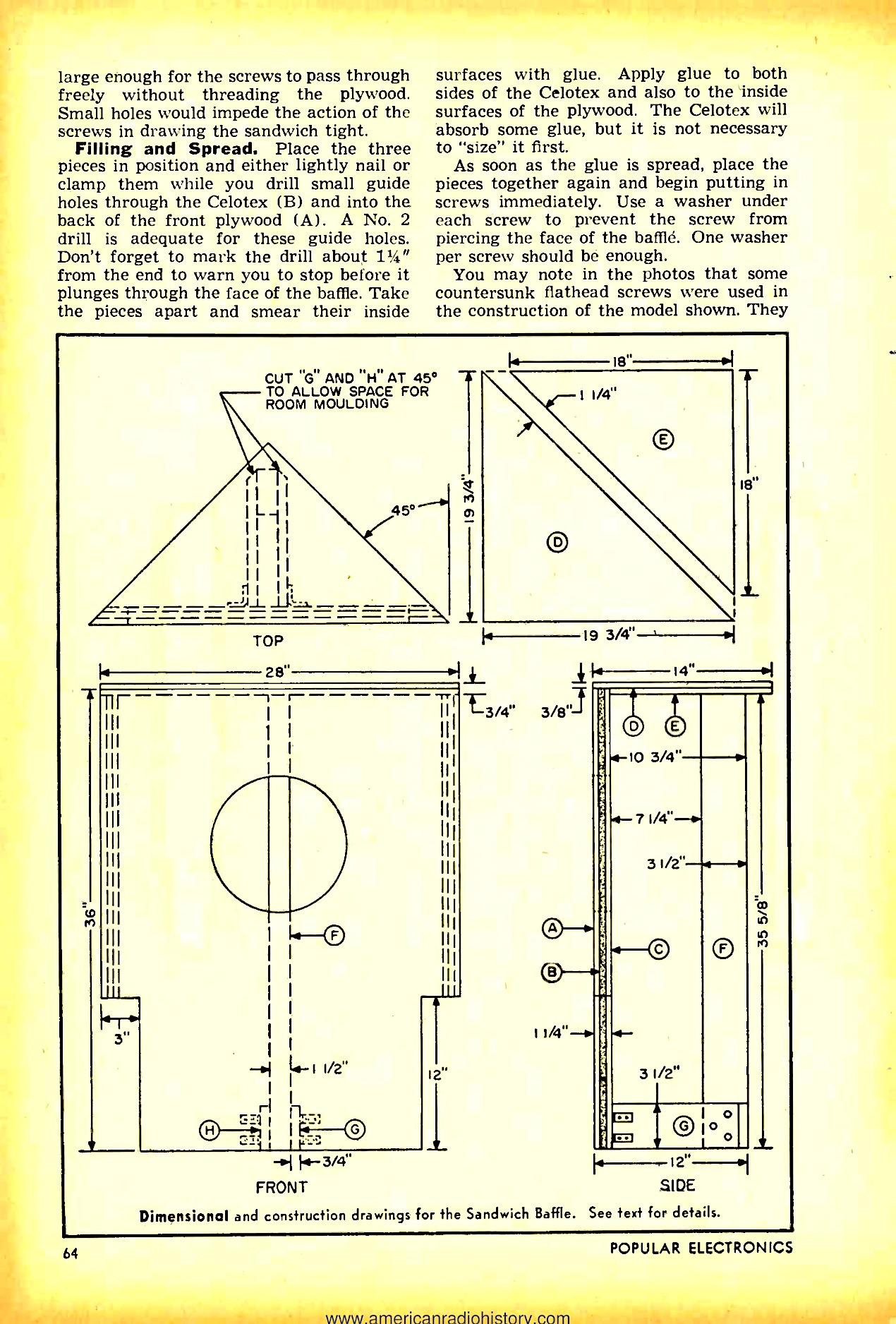

Geezer article- May 1956 David Weems $3 Celotex Corner Baffle
here ya go
Yeah, 'blast from the past'! I keep the article on my Flickr page. Me and a couple friends built a number of these and being only age 10 with a meager driver selection we still got Cub Scout Merit badges for them and frankly, I liked ours better overall compared to the neighbor's Karlson K15 kit I've mentioned on occasion.
In retrospect, the K15s super strong [mid] bass XO'd to our 'FR' driver baffles might could of been a pretty good mono HIFI combo! I shutter to think how much such a low XO would have cost though!

I think the depth was 20" not 18"
