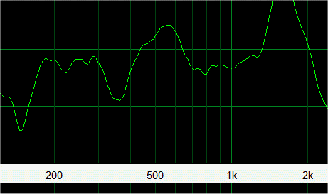

There is also the classic "spider hole" where a spider resonance sucks out the energy - by creating a large impedance - which results a dip in the entire response of the driver.
There doesn't seem to be much information on this resonance. I wonder if there would be a corresponding tell-tale blip on the electrical impedance as it would help me to draw a connection to this hole at 350Hz. I really don't want to set up for interferometry (well, OK, I really do 😉)
