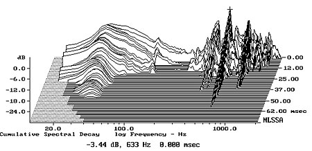

Linkwitz comment refers generally to all (almost all?) loudspeakers He listened to throughout His career,
description of the specific event is only an illustration, serves as an evocative example
of course I don't ask You to comment on His subjective impression 🙂
my question is whether His subjective impression can have its cause in any objective problem with loudspeakers 🙂
the problem of "the music stops but the speaker plays its own song " - the loudspeaker noise
best regards,
graaf
ps.
image attached - typical, not particularly bad, example

absolutely ALL loudspeakers are causing 'energy tails' - only to a greater or to a smaller degree
aren't the tails clearly visible on every CSD plot?
perhaps I misinterpret the measurement? I don't know
please explain 🙂
best regards,
graaf

anyway - there are still "time distortions" in loudspeakers apart from any distortion resulting from the room interaction and/or "intrinsic faultiness of stereo"
or not? what is Your opinion? Do those things visible on CSD plots indicate real audible problems?
