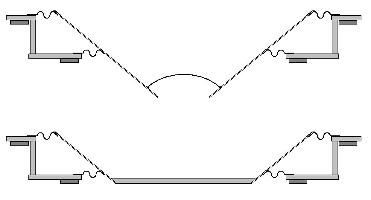

I first ran across Earl's AL concept several years ago while I was looking into PR-based bandpass alignments. I like the idea of using acoustic filters over electrical ones, and also avoiding use of long ports in bandpass alignments whose resonances can get in the way.
At the time, I did some rough drawings of how to construct the AL resonator element largely with off-the-shelf parts and no need for unique castings, etc. Godfrey's drawing reminded me of it, and I've attached it below.
The frame is made up of two aluminum hoops--one for the outer mounting flange and and a smaller-diameter one for the inner. These are fastened together with cylindrical posts with bolts running through them.
The diaphragm and surrounds are off-the-shelf woofer soft-parts.
If you want more mass and a shallower profile, glue in a thin piece of MDF and cut away the excess cone below it.
There you go, Earl. No tooling to speak of, just some aluminum hoops, a bit of drilling, and some gluing.
Design free of charge, and worth every penny.
