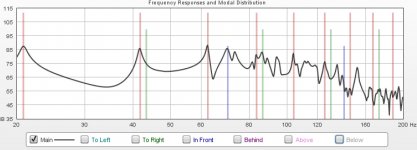

The quote and linked paper by Earl Geddes describes a 'first mode' region. What are first, second and third modes -- and how do we determine their frequencies in our small rooms?
"a) Point 1 implies that there are basically two significant regions at LFs in a small room. The first is what I will call the “first mode” region. Basically nothing is going to affect this mode except for damping, and its darn hard to get any damping in the room at these frequencies. This region also contains the oft mis‐understood “pressure mode” (more on that later) and will go up to about the second or sometimes the third mode. From my experience no amount of source moving or numbers of source will have any effect on these (1,2 or maybe 3) modes. EQ is always required to tame these modes if in fact your system goes low enough to excite them (but they are very easy to excite). These modes are also the reason that a sub can excite a room well below its actual free field LF cutoff point and why I don’t pay a whole lot of attention to how low a sub goes in free space."
http://www.gedlee.com/Papers/multiple subs.pdf

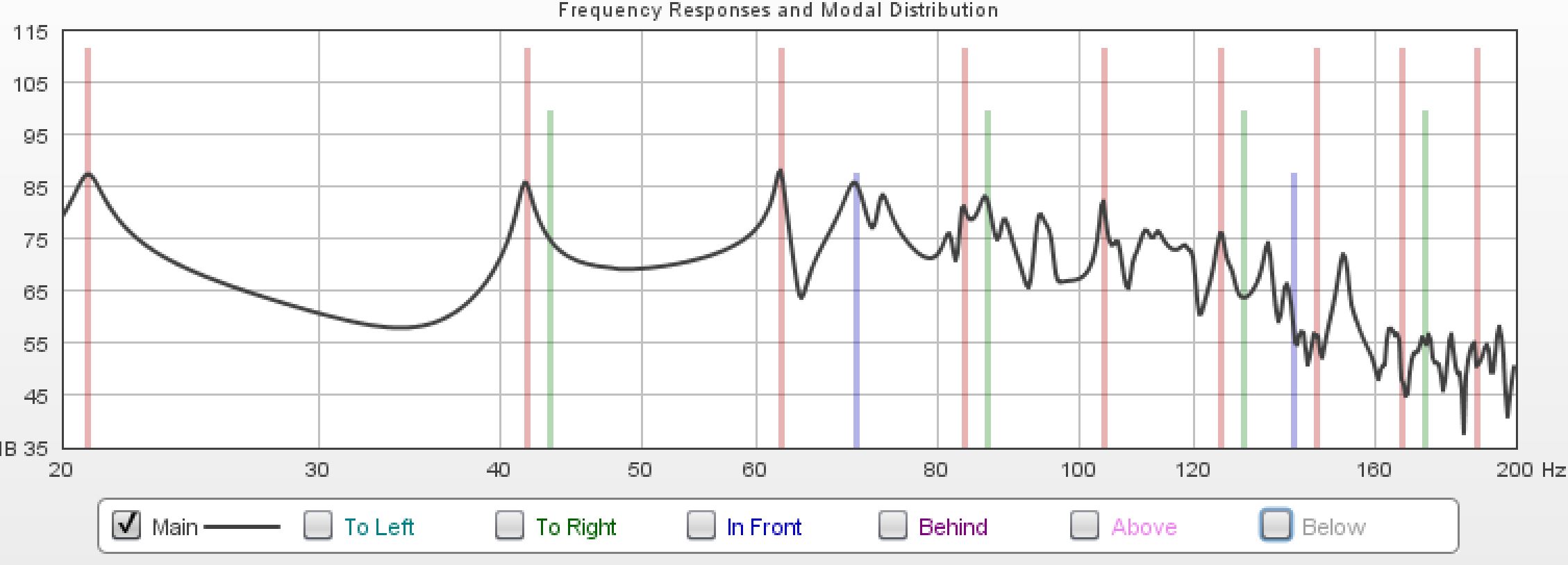

Ah, I think REW does the work. The first three modes are probably the axials: 21Hz, 42Hz, and 63Hz. So I think that means I only need one subwoofer for 20Hz to 63Hz. Then use multiple subs for 64Hz to 125Hz.

Geddes said room treatment would work but it's difficult. If I understand Geddes correctly, he'd take one of your four subs and dedicate it to the first mode region and equalize it for that region. He suggested locating it in a corner where it "sees" all the modes. Then he'd use your other three subs to address the higher modal bass region.

If I understand Geddes with regard to room modes, each room is the same in how you approach the modal region. The one exception is if you have a room in which one dimension is twice as long as the other dimensions. In that case the room behaves like a transmission line. The big difference between our rooms is size in volume, but the behavior in the modal region is the same.
When it comes to typical parallel walls in most homes he recommends treatment on one of the two opposing walls/ceiling or floor.

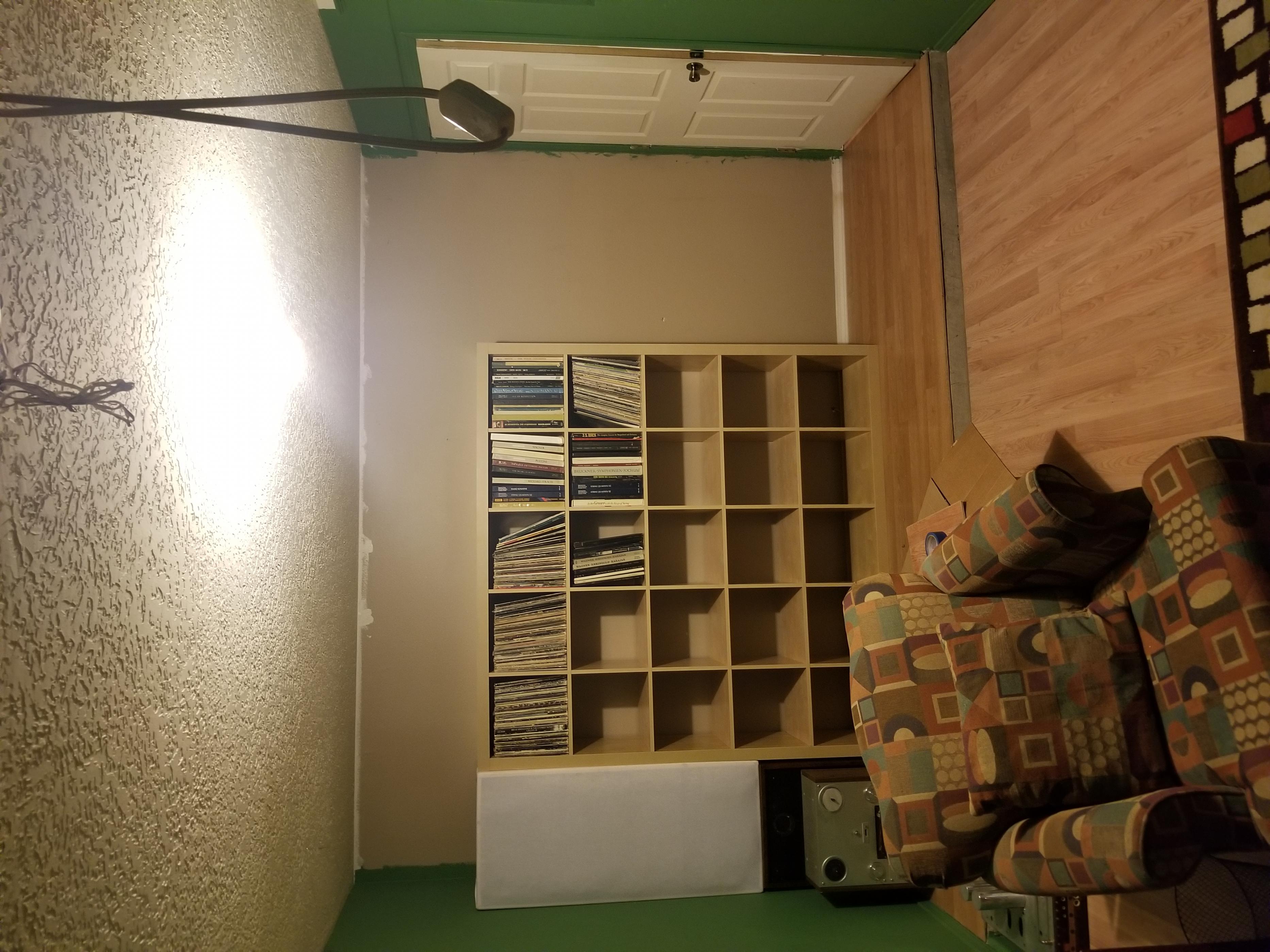

My room is 21ft long and 11.5 ft wide. All the empty space around my record shelf will be bass traps of 8" deep rockwool
In the front corners of the room behind the speakers will be the super chunk traps.
