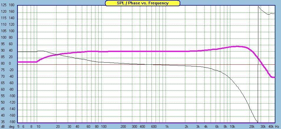

Here is my ECM 8000...calibrated by Kim G.
For a $40 mic, it's darned good from 20-20k. There is some unit-unit variation so this one isn't necessarily the same as other examples.
Paul
Thanks - this is no where near the 6 dB that was claimed!! More like 2 dB. Having designed a lot of mics before I could not see any reason that the error should be 6 dB. What you showed is exactly what I would have expected. Its amazing how real data can dispel a lot of false claims.
