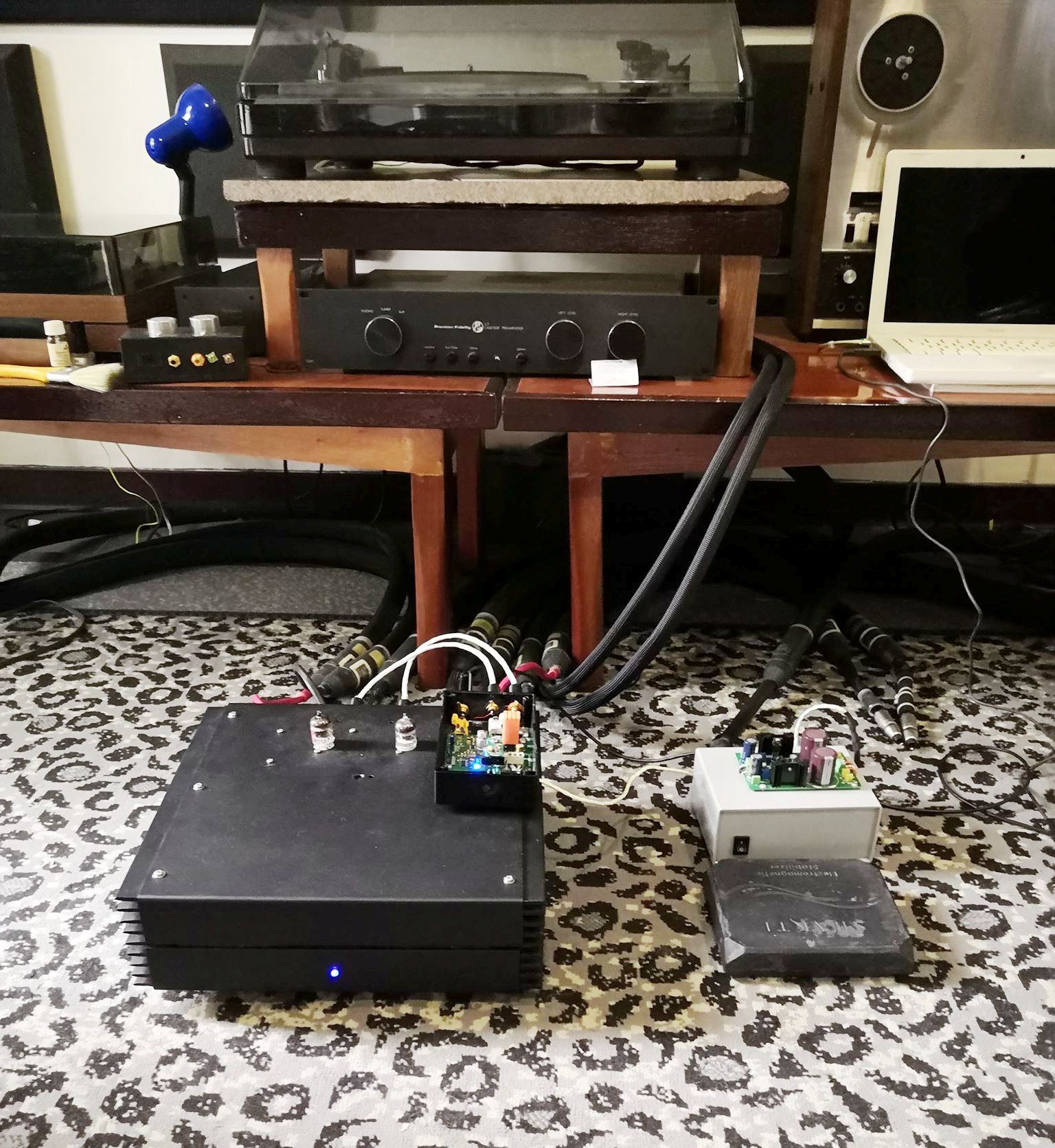

Where did you pull this schematic from?
It's from these kit:
Buffer 6N3 Tube Amplifier Preamp AMP Pre-Amplifier Matisse Kit
- and i trying to connect these cheme to +/- 54v and as result make these scheme:
801685d1576230640-ge-5670-54v-supply-voltage-111-png
- but is not correct, just show what i need.
apparently it’s better to use additional power supplies.
This should work. Did it several times.
The amp behind this preamp must also have 0 or earth as ground for signal connection.
You can check this by measure between - power supply and earth input , should be -54v.

But input with ground, output with ground, primary power supply with ground... - what pros of isolated power supply in this case if isolated ground will be connected to common ground via audio signal input and output?
You might not need the isolation. Sometimes I want to use the module as a negative supply for bias etc and these don't do that. The main problem is they are single ended and noisy AF...
If you still want one, I mail you one for the cost of postage.

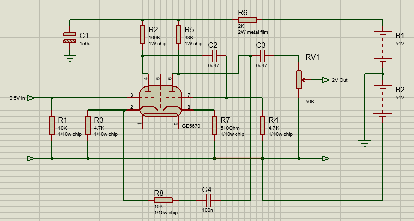

Like this? (GE5670 instead ECC88 or which one better?). How much mA on out will be? It will be enough?

Done? Looks like ok 🙂
Input: sine 0.5v 1k
But it's ECC88. GE5670 ~same and will be ok in these scheme?
ps - original scheme (250VDC):
- Ia up to ~2ma
on my scheme Ia up to ~3ma, other shown voltages are ~same
Yes, something like that.
At first I thought you were still tweaking the original circuit 😀 but when enlarging the image (tired old eyes) I saw you are now using as suggested: plain triode gain stages, now 2 of them on the same board, each doing its thing unmolested 😎
You may design it from datasheets of course, but since it´s both a single project and working outside the usual supply range, I would simply feed it the 54V available (you'll lose some of it with RC filtering, you might want to regulate it so low drop and high ripple rejection), keep the 33k plate resistor and vary the cathode one until plate voltage sits around, say, 35V DC.
You may even drive it to clipping and vary bias until you get roughly symmetrical clipping.
Once you found the proper cathode bias value, you substitute pot or resistance box with a fixed one.
Guess that´s what you were looking for 🙂
