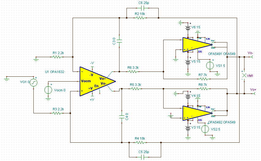

I don't think using OPA1632 to drive 2 OPA549 is a good idea.
The slew rate of OPA1632 is 50 V/us.
The slew rate of OPA549 is only 9 V/us.
There is a contradiction on speed, and there is a stability issue apparently.

wensan, please read Walt Jung's papers on composite amplifier, you'll see that "contradiction" you mention is actually quite beneficiary.
I mean the OPA549 will be a limit to the OPA1632 on speed and stability.
You should consider that fact having a GBW product in mind.
Since the OPA549 is a limit to the OPA1632, the GBW of the OPA1632 have to be reduce by the stability compensation.
I don't really like it, but it will work anyway.
When the inner device has more bandwidth than the outer device, some of the inner devices open loop gain can be used to extend the bandwidth of the outer device.
When the outer device has more bandwidth than the inner device, the bandwidth of the outer device must be reduced to prevent oscillation. In this configuration you are losing one of the main benefits of a composite amplifier, but I think we are forced in this direction if all of the available output devices that are powerful enough to drive a loudspeaker are bandwidth limited. The only high current, current feedback op amp I know of is the LT1210 (min 1.1 amp, typical 2amp, from memory) and you would need a very efficient speaker to make this work unless you want to consider paralleling devices.

A power buffer with the slew rate higher than 50 V/us is easy to build by discrete parts.
The slew rate of a signal will be amplify by a amplifier.
It means, If the slew rate limit of OPA549 is 9 V/us, and the gain of OPA549 is 2,
then the slew rate of the OPA549's input signal should be limit to below 4.5 V/us.
Otherwise, the TIM(Transient Intermodulation Distortion) and SID(Slew Induce Distortion) will occur.
But the OPA1632 has 50 V/us of slew rate, it is too high to the input signal of the OPA549.
So the slew rate of the OPA1632 must be reduced to below 4.5 V/us.
The formula of OP's slew rate limit is SR = 2 Pi Vth GBP. The Vth of OPA1632 can not be changed.
So the GBP of OPA1632 have to be reduced to 0.09 GBP by compensation.

Back to the circuit that using OPA1632 drive 2 OPA549.
If we focus on OPA549's part,
The OPA549's part is a invert amplifier circuit completely and independently.
If we apply the theory of Walt Jung's "Overview of SID and TIM" to the OPA549's part,
The conclusion is the slew rate of the OPA549's input signal should be limit to below 4.5 V/us.
Then,
If we focus on OPA1632's part,
The OPA1632's part is not a complete feedback amplifier circuit !
If the OPA1632's output signals haven't go through the OPA549's part,
The OPA1632 can not get its feedback signals.
When the OPA1632 hasn't gotten its feedback signals yet,
The OPA1632's output will drive at full speed, that means 50 V/us.
But we have already gotten the conclusion that the slew rate of the OPA549's input signal should be limit to below 4.5 V/us.
So the OPA1632's slew rate limit have to be reduced to below 4.5 V/us.
According to the slew rate limit formula what I found in Walt Junf's article.
The OPA1632's GBP have to be reduced to below 0.09 GBP by compensation.

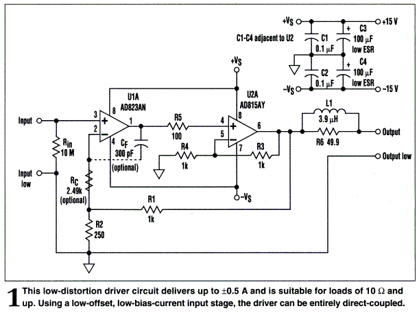

This is the other Walt Jung's article "Composite Line Driver with Low Distortion".
Although so many English words make me dizzy.
But I still can look at the figure and guess.
The example in this article using AD823AN to drive AD815AY, the AD815AY's gain is 2.
The AD815AY's slew rate limit is 900 V/us.
So the AD815AY's part can accept 450 V/us of input signal slew rate.
The AD823AN's slew rate limit is 22 V/us.
I don't see the contradiction on Walt Jung's example.
Sorry, but we can not consider opa549 completely independently because it is included into feedback loop of the opa1632, so output signal from opa549 is going to return to opa1632's input.
You see how nested loops are fun ! 😀
The OPA549's part can work independently.
It is an independent object at the bottom of the nest.

The Burr-Brown app note (http://focus.ti.com/lit/an/sboa002/sboa002.pdf) has a relevant comment on the advantages of the composite configuration when the bandwidth of the two devices is equal:
"If the bandwidth and settling time advantages of the composite amplifier are needed, but not the slew rate boost, it is possible to make a composite amplifier using a dual op amp such as the OPA2107 as shown in Figures 3 and 4. It is best to use a dual op amp because of the inherent matching of dynamic characteristics. To ensure stability and the best transient response, set the gain of A1(outer loop op amp) two times the gain of A2 (inner loop op amp)"
My questions are:
1. Does the OPA549's bandwidth and settling time improve significantly when inside the OPA1632's feedback loop?
2. Is a another advantage the thermal isolation of the OPA1632 from the OPA549?
My questions are:
