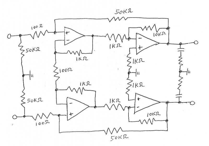

This circuit should work. It is not SuperSymmetric - the output
of one amplifier will reproduce the errors of the other one in an
additive way as seen by the load.

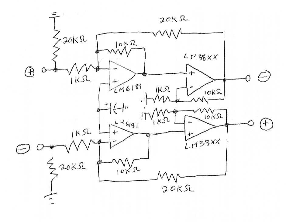

Not quite. The LM6181 is a current feedback device, but in
this case you would have to ties the inverting inputs together,
drive the non-inverting inputs, and amplify the output with
a negative phase (the power chips following the LM6181 would
be set up as inverters). The inversion reverses the effective
polarity of the LM6181's inputs.

TFTR. Does the attached capture your comments?

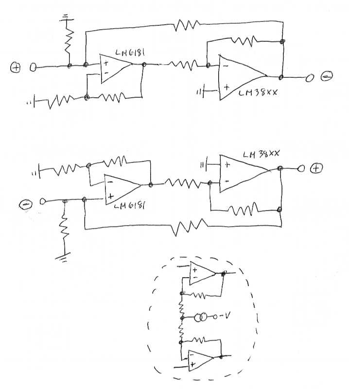

Also, since I barely understand CFB opamps let alone VFB opamps, does trying to make a good differential stage with CFB opamps, where the inverting input is low impedance, force you to add a CCS as shown in the dotted circle, or is this plain nonsense?
Sorry, that's still not it. Being that it's late for me, I'll wait until
tomorrow, and if one of the local smarty-pants hasn't posted
the correct schematic (maybe you) then I'll put it up.

Use something more like 10K input resistors instead of 100, as
the + input junctions will be operating at virtual ground. With
the 50K feedback values, the gain would be 15 dB.
As noted before the input op amps will be "current feedback"
types, and you can eliminate their 1k feedback resistors and
use any arbitrary value between their - inputs, as low as 0.

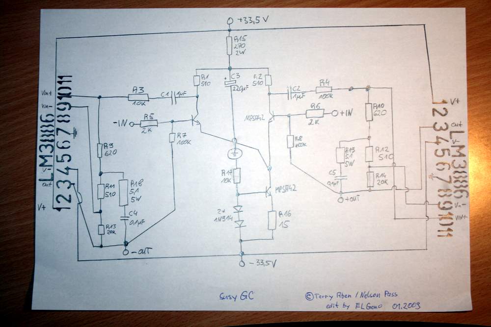

after nearly missing midnight on december 31. -lost in reading this 653 posts thread- i decided to build this amp. (one reason: i liked the process of development in this forum very much) I still have an unregulated 33,5 VDC PS from my last amp project, wich went up in smoke few days ago after a year of nice sounding.
Because of this high supply voltage i choosed metalmans design and as i use 4 Ohm speakers i refer to post #439 with the corrections.

is this offer still valid for a 33,5 VDC supply?
I'm still thinking of modifications into a regulated supply wich maybe lowers the voltage a bit, but as i tend to use carlosfm's "snubberized" there is not much hope to lower it.
Instead of ZTX450's i could use BD139 or even better MPSA42. Need to use spare parts as long as i'm student 😉
Apropos spare parts... i still got 2 E88CC aka 6922 wich i really should invoke in this project. Post #271 looks interesting and just needs an delayed relay for tubes heating up.
Another idea is to use them for symetrie creation when using asymetric inputs instead of on DRV137. If i bring it on paper this weekend, i'll post it for disussion.

sure, i just finished the Spaghetti design with parts i have available. I attached a file how it should look like. I have MPSA42 or BD139 hope i can use them... think i have to start up ltspice to have a closer look.
After reading the LM3886 datasheet, i really should lower the voltage a bit. 67V across both rails is too much for 4 Ohm speakers.
I'll get that topic on the drawing board next. But i'm open minded for any suggestions too.
ELGono

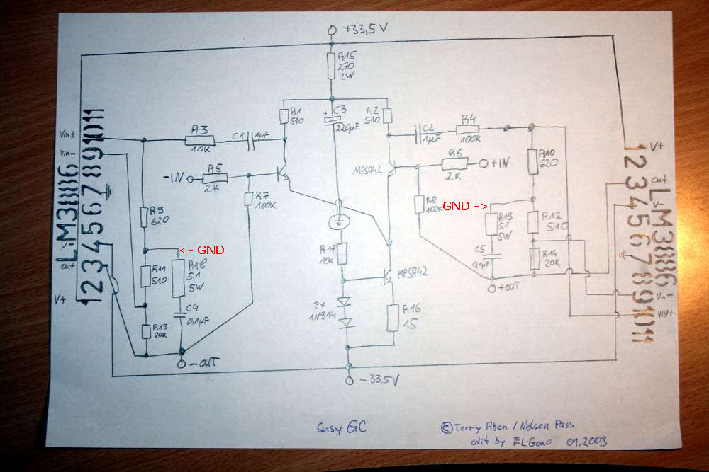

Gono said:
... I attached a file how it should look like. ....
ELGono
Gono, don't forget the ground connection - see attachment 😉
Viel Spass dabei !
