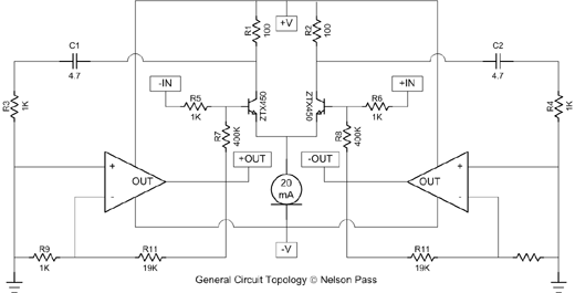

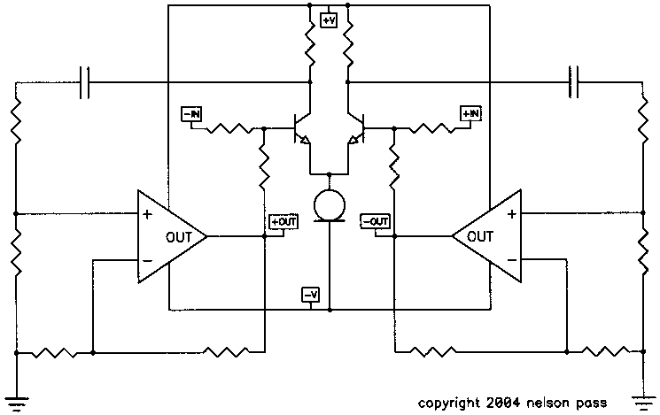

Nelson Pass said:For those who didn't find "Monolithic SuperSymmetry" interesting
enough, I present a concept schematic which uses power chips
such as the LM3875 or 3886 (or anything else, for that matter).

Setting the gain around each Chip Amp via the - input loop
allows quite a bit of adjustment in this regard. The Chip
Amps are of course enclosed in the loop formed by the diff
pair, and so their distortions will tend to be nulled, reducing the
overall effect toward the performance of the diff pair itself.
I hope you guys appreciate that I used Bipolar transistors
just for the occasion. 😉

There are 2 feedback loops, one is around each differential transistor (set by 2 resistors) and the other one is around (-) input of the GC (also set by 2 resistors).
What is the good proportion of gain between these 2 feedback system?. Usually the one around GC is bigger. But by how much (compared to the one in the differential) is the best?
Also in this kind of system, every GC will see only half the impedance of the speaker. If the speaker is 8ohm, each will see 4ohm. But if the speaker is 4ohm, each will see 2ohm. GC chips cannot stand this low impedance. Is there any current boosting method so that this power amp can work with 4ohm speakers?

Interesting design. While some of the SuSy design have problem with absolute DC offset, in this design, there is no R at all at differential to ground.
The only ground reference can be found in GC input/output. Is this the one who sets the 0 point of the whole system?
Also no "magic resistors" needed from each outputs to CCS of differential?
Bipolars are more predictable in their Vbe compared to Vgs. Making SuSy is better with bipolars?

A shot in the dark.
Well, since noobody else (read better) is taking the bait, here is my first kick at the can.
I believe I have set the voltage gain of the differential pair of bipolar transistors to 1 (at this point just to keep things simple, and assuming the hfe of the bipolars is 200), and the gain of the opamps to 20 (linear not dB). I believe I have chosen the values of R7 and R8 to reduce the size of the feedback signal to the right level to generate an equal distortion on the opposite half of the circuit, but I am having trouble wrapping my head around this. It seems to me that by setting the feedback from the opamps to the differential pair to match the noise in amplitude and phase on both sides I am also feeding the signal back to the inputs out of phase but equal in amplitude, which ultimately means no output signal.
Am I even slightly on track or have I just made an idiot of myself?
